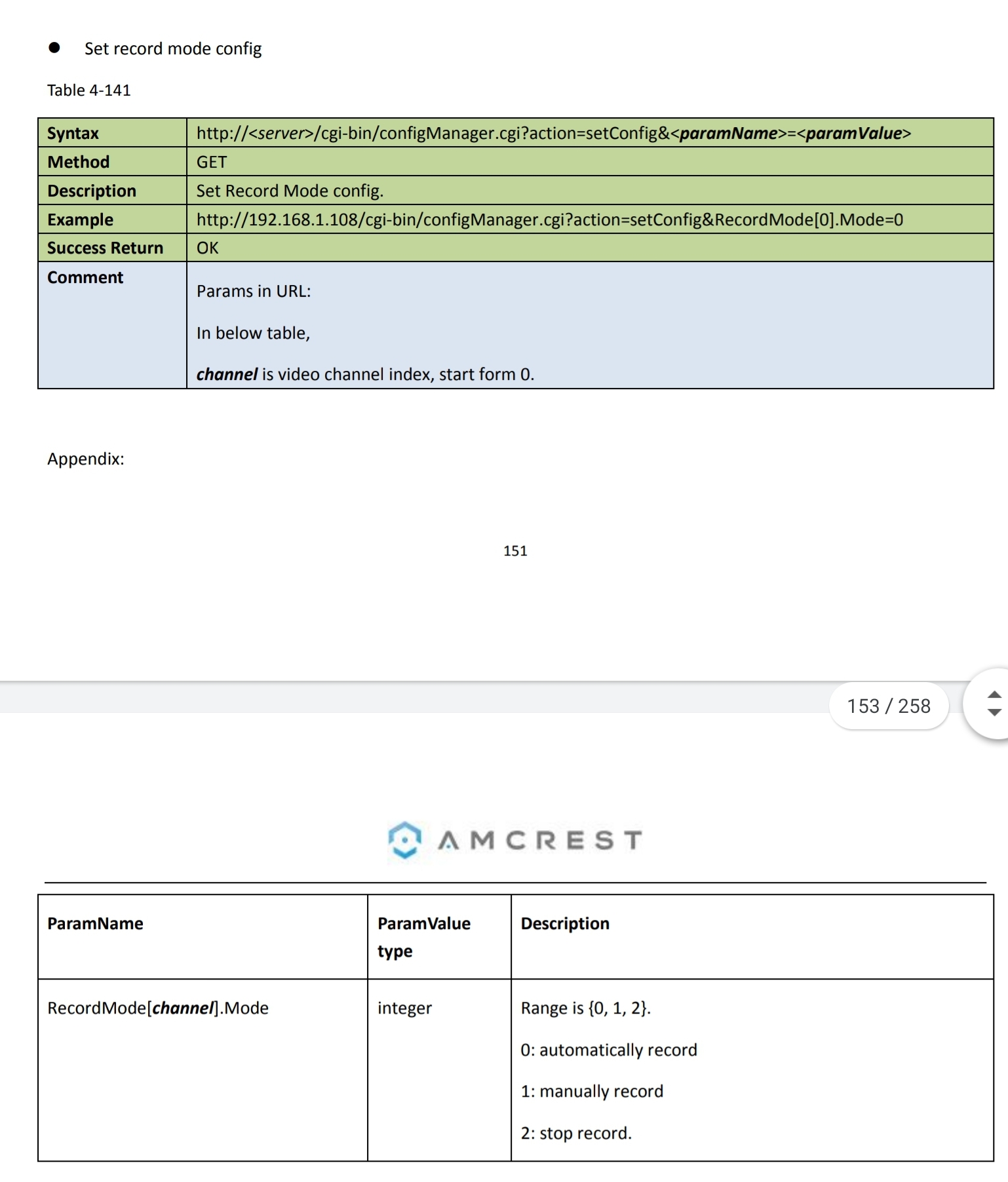

It looks like you could do that using the NVR IP address and camera channel number in:

Good news. I am able to programmatically start a recording.
To start manual recording:
RecordMode[{channel}].Mode = 1
where {channel} is zero-based index of the channel (my NVR has 8 channels).
To stop the recording, set the Mode = 2 (if I don't do this, the recording will never stop). At the end, I need to set it back to automatic by setting Mode = 0.
