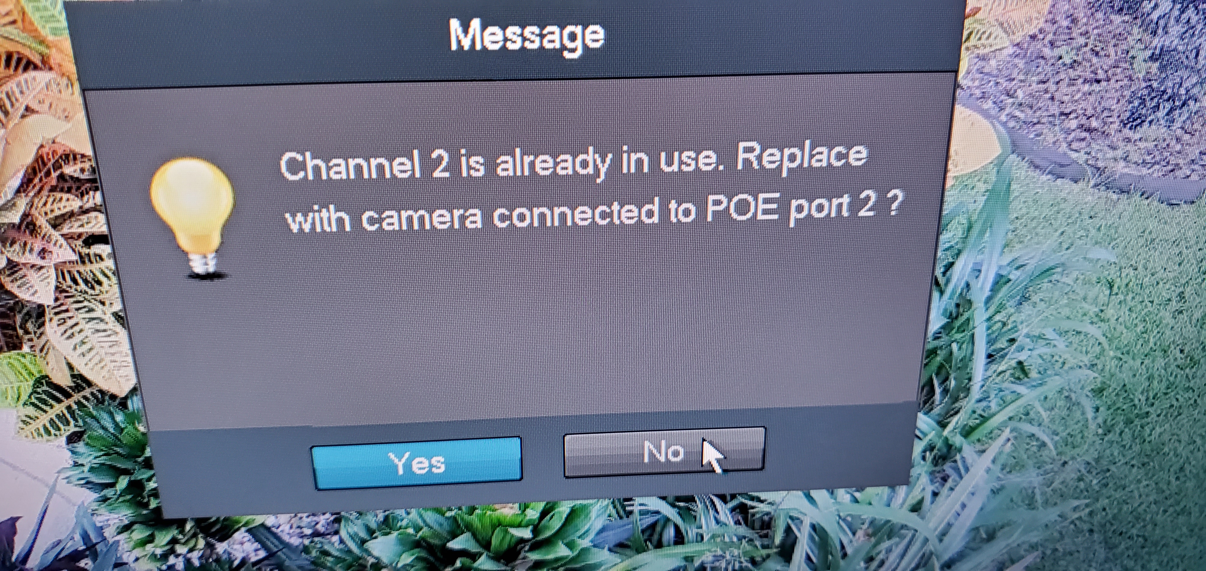

About once every other day (always in the morning when I first turn on the monitor), I get a message on my NVR monitor that states:
"Channel 2 is already in use. Replace with camera connected to POE port 2?" Followed by a choice of "YES" or "NO".
The number may change from day to day, i.e. it will say channel 4 and port 4 or channel 3 and port 3, etc. And sometime there will be a series of messages all with different channel and port numbers.
If I choose YES, I usually have to reinstall the camera. If I say NO, everything seems fine until it happens again a day or two later.
How do I resolve this issue so this warning does not come up?
POE Message: Channel already is use...

Thank you for your reply.
I did not see this a "video loss" as all the video signals are still there (I can see them in the background). Maybe an IP address conflict but I can't find it.
The channels affected are only the ones directly connected to the NVR. (I forgot to mention that.)

I was getting that message on two of my four 4108E. Those two have a mix of directly connected cameras and channels connected via IP from the LAN. The other two only have directly connected cameras.
The PoE cameras were connected to ports 1-2-3 and the LAN IP cameras connected to channels 4-5-6. All was fine for a few months (I do not have weekly NVR restarts scheduled). Last week, I did UPS battery replacements and got the channel already in use message for 1-2-3 when the NVRs started.
Watching the monitor during a restart, the LAN IP cameras previously configured for channels 4-5-6 were showing in positions 1-2-3 until the PoE cameras initialized a 10-15 seconds later and the messages appeared about channels 1-2-3 being in use ... did I want to replace with PoE ports 1-2-3 ?hmm? "that's odd".
I moved the PoE cameras to ports 4-5-6 and connected the LAN IP cameras via channels 1-2-3.
RESULT = no more messages when the NVR [re]boots.
