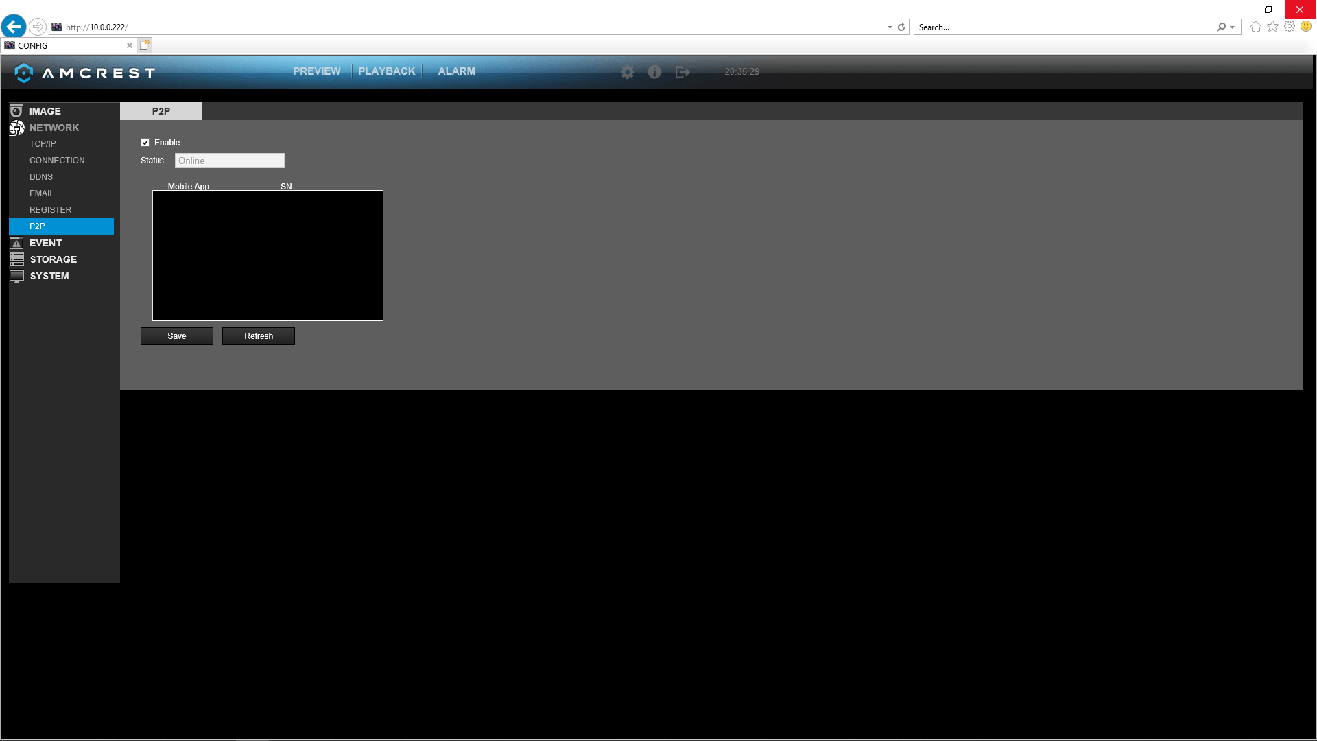

I just want to Say that I took my NVR and connected it to ASP aka Amcrest Surveillance Pro on my Laptop I setup over my P2P that you can do from your WebUI if you don't have it already connected.. So in ASP when you go to setup your Device rather then entering the IP address you will want to Enter the SN and that is in the Drop Down box under enter name for your Device... You can get the SN off the Top of your NVR Enter the SN and then the user and Password
Then save or apply.. It will show that it is online
I then took my Laptop and connected it to my Verizon Hotspot to Test that it works.. I Took and turned on ASP, Went to Devices, Went to 4kNVR it was listed as Online, Went to Live View and then on the Right side I opened up my 4K Nvr listing and right clicked it and said Main.. It then loaded my 16ch in my view on a 4 camera per page I have 4 pages can change between.
Here is a PICTURE oF MY WebUI for my P2P on my NVR I covered the SN as I don't need loads of people trying to Hack my NVR lol... You can Right click the Image and pick bring up in new tab for a 1080 full screen view
Screenshot (2560).png (58.88 KiB) Viewed 7287 times
