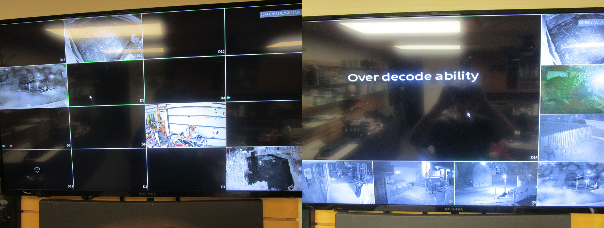

We have a 16 cam NVR with 15 cameras hooked up. From 720p up to 4K. Recently I started getting these decode errors errors. Using the built-in tools I can see that the max bandwidth the cameras hit total is 32 Mb/s. I have even set all the cameras to as low as 1782 kb/s. And I still get the decode errors. Plus when I switch to the 16 camera view, 10 are black. Three of those have the decode error. If I switch to either 8 cam view, none are black - except the decode error ones. I've rebooted, changed rates, turned off substreams and audio, lowered framerate and resolution. Any suggestions? This just started happening out of the blue.

Don't know what system your using but I suspect the issue is the 4k camera.. Some systems will have a Datasheet about what it can Live view while being a 4K system it might have a limit of 1 camera that it can Preview in 4k where all others would need to be in 4mp or lower..
SO for me what I have done to make this issue a non issue is using my 4k camera on a different NVR so I can use my 4216E-AI NVR all 16ch without having a encoding issue even though mine will do 2 4k cameras here is my NVR's info
So I would try to Limit your Playback to 1ch or 2 if using 4k cameras depending on your systems stats and or for live view keep views within your NVRs ability

The thing is it worked fine for the past year. Nothing has changed. I just noticed that ALL the blank cameras are Amcrest. Only the 4 generic ones are not blank. I've gone as far as to set every camera to 720P - in camera. They also record motion - The display will be blank, but the red motion detect indicator comes on. I checked the recordings - every camera except the ones with the decode issue are still recording - just not displaying.
NVR is an NV2116-HS.
