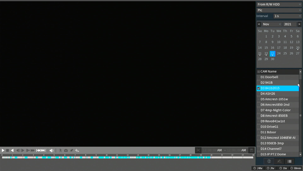

So here is something to try.
Log in the NVR's WebUI, then look on playback, then drop down and choose PIC, then choose the camera, then hit the list and see if any come up that way.
I know on some of my NVR's with 4.0FW installed I can't view the PIC on the NVR only over WebUI of IE if I use Chrome no option for IE it has the option. I know I know IE is on the way out sad as it is that is my GOTO for my WebUI connections seeing they offer all the features where Chrome, edge don't have them all..

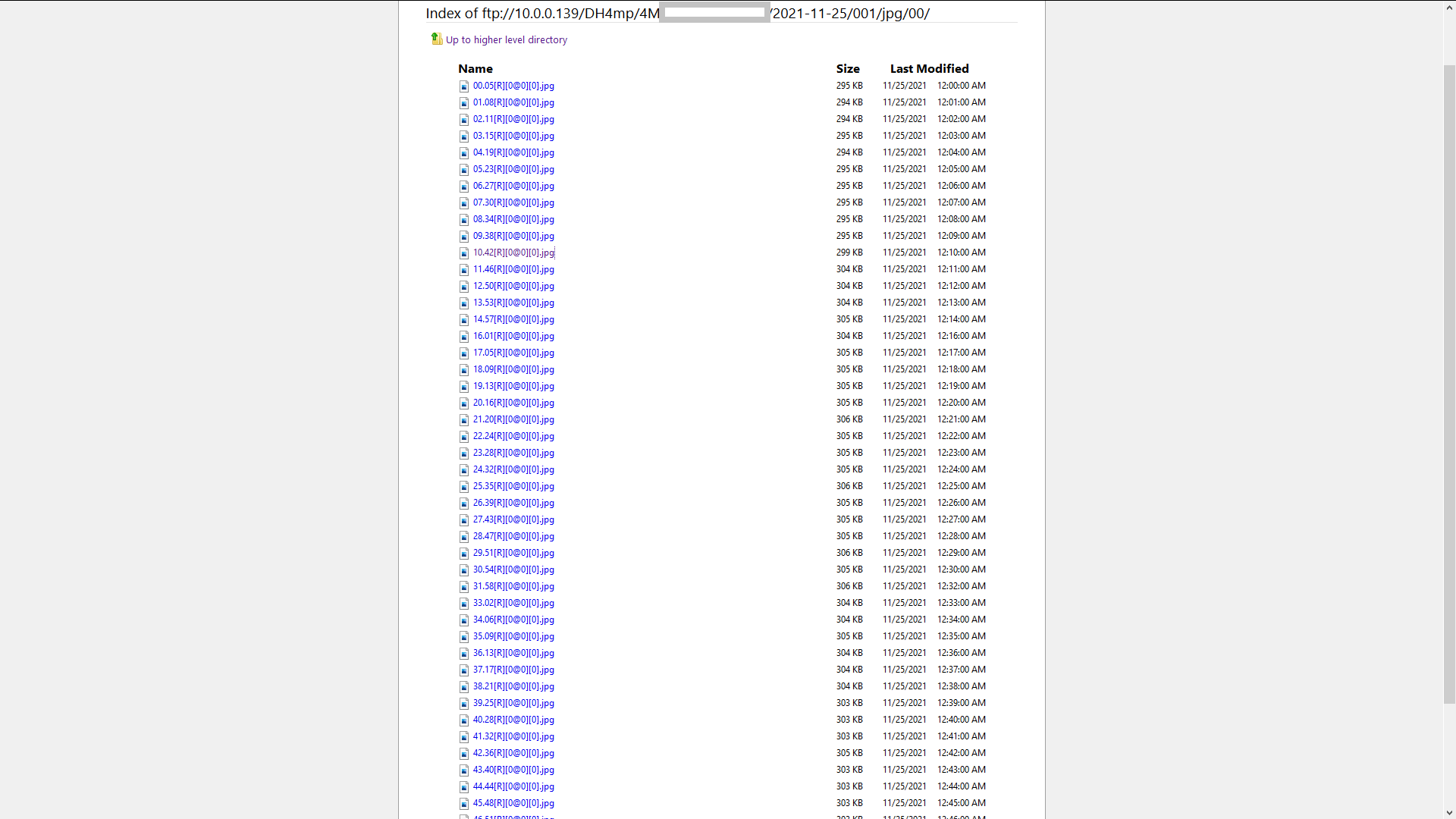

Re: NVS4108E Snapshots no longer working
This is one of my cameras that I have on FTP one every minute lol. Don't know why really I guess I just have not changed it after my NVR changed to that option. I have since removed that from my NVR but never on my Camera. That is one thing also any changes on NVR is on Camera settings as well. So in the event that you have cards installed and have them setup for snapshot to go to the mSD card it can fill that up really fast as well. That is why I have them setup to go to my FTP server
