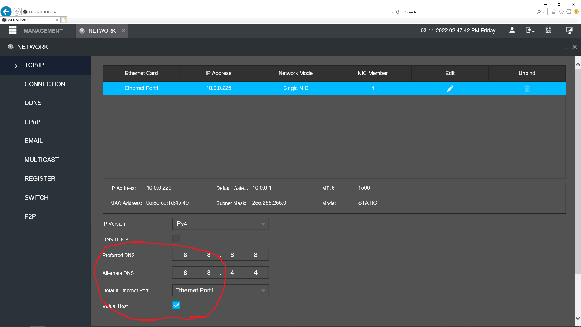

Then normally the NVR might have a Virtual Host switch in the Network tab area. This will turn on the ability to connect though the NVR's IP to other cameras that are connected to the POE port of the NVR. However your NVR might be like one of mine in the since that it don't have a Toggle and Virtual Host is just online already like my 4216E-AI NVR... Issue here is that you have to then connect to the NVR's normal network IP and go to the Camera area on the NVR's WebUI click on the E next to the camera you want to make changes to, this will pop up a new tab with in my case something that looks like this. 10.0.0.223:10080 that isn't always the same IP address depending on how many cameras you are trying to config however that is normally the starting port and other machines might have different port range but same idea...

Virtual Host doesn't seem to do anything.

Virtual Host doesn't work either.

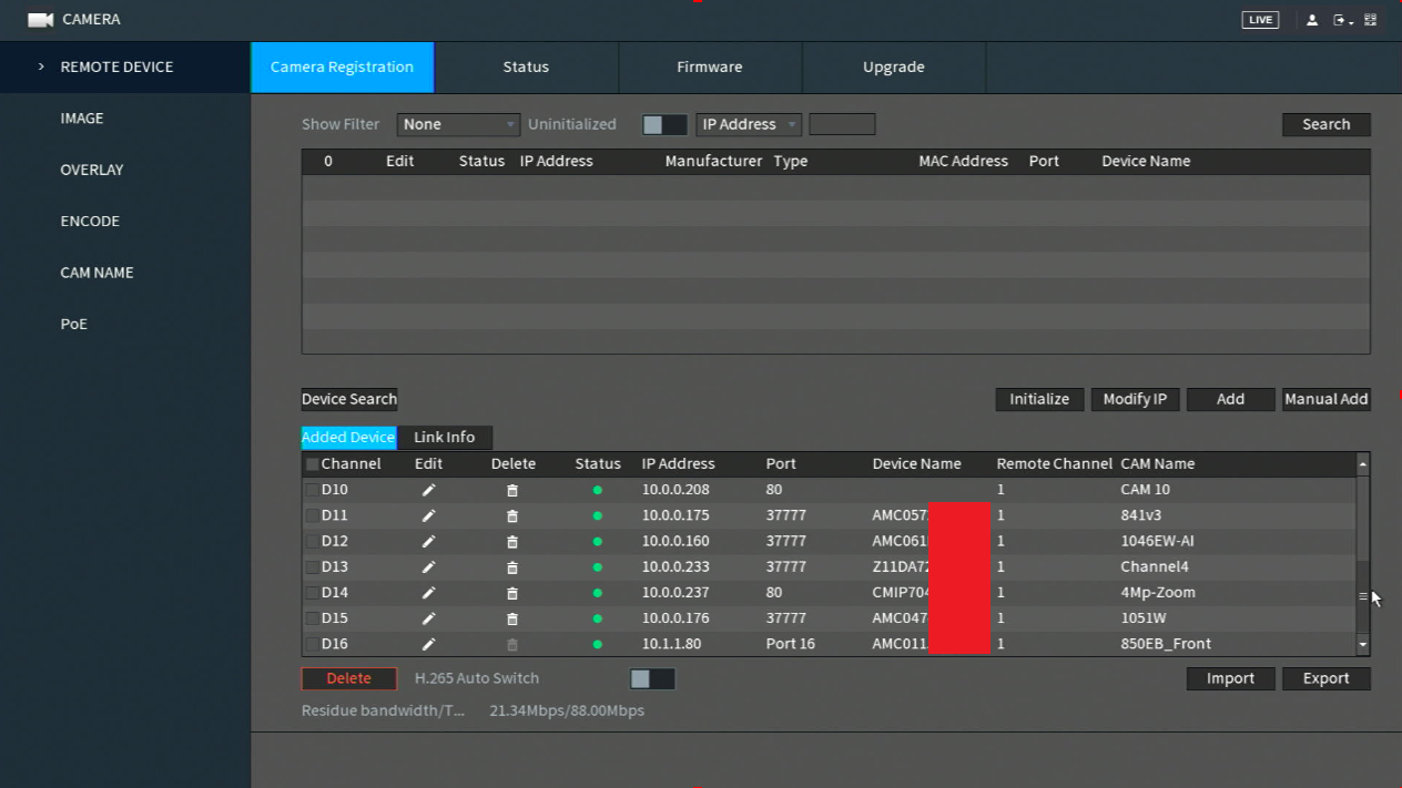

Can you upload some pictures of your NVR's Camera/Remote device window.. It would look like this below. Mine is from a Direct Screen Capture you can be a picture either way I am clearing some of my SN.. You can see the one that shows PORT16 is connected to POE port 16 direct the rest are connected over my normal network IP range..
Re: NVR5208E
So that is the 4216E-AI above, here is a picture of another 8ch POE with older FW incase your system looks like this on the WebUI. I am showing the WebUI as an area that you would click the e to access the cameras WebUI... Please note that only 1 of the 2 cameras connected to POE is really a POE camera the other is a 841W IP/Wifi camera that has a cable from the camera to the Listed Port on the NVR.. Please notice in the second picture that is what I was talking about when you do a Connection with your NVR's WebUI, Then click that e and it will be the IP of the NVR with a Port number that you can see in the second picture...
