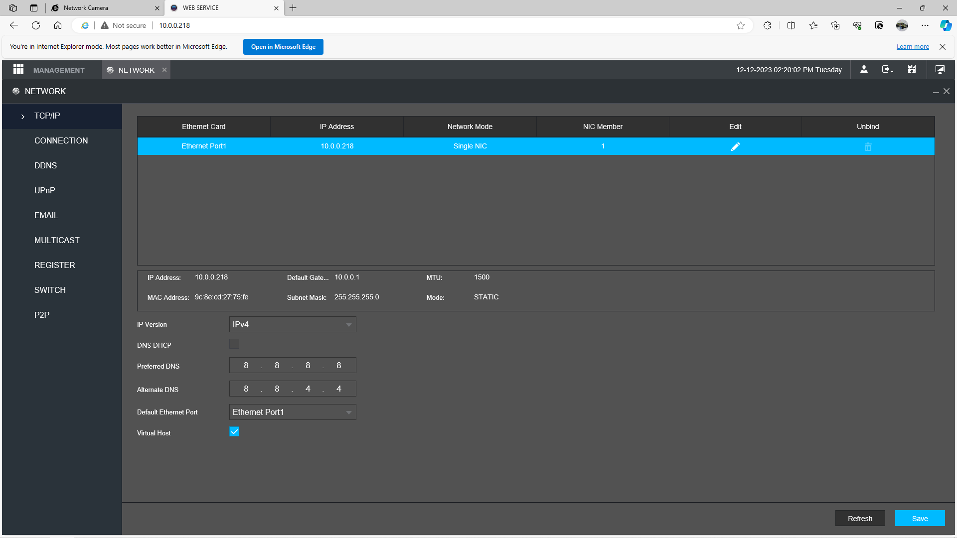

IF you look at the pictures below you will see the Virtual Host I was talking about under Network. Second picture is access to the camera on Edge using IE tab. It works with 10080 that way however in Chrome it will fail on that port will need to pick one you don't want to work with first and then as I said before the second port will be 10081 and that one then on works in Chrome without an issue. You will need to click on the E next to the camera if you add just the PORT number after the nvr ip address without first clicking the e it will not open anything and just give an error. Looking at the 2 pictures below you can see in the first picture it is the NVR only the second picture has the same IP just there is a port number.
