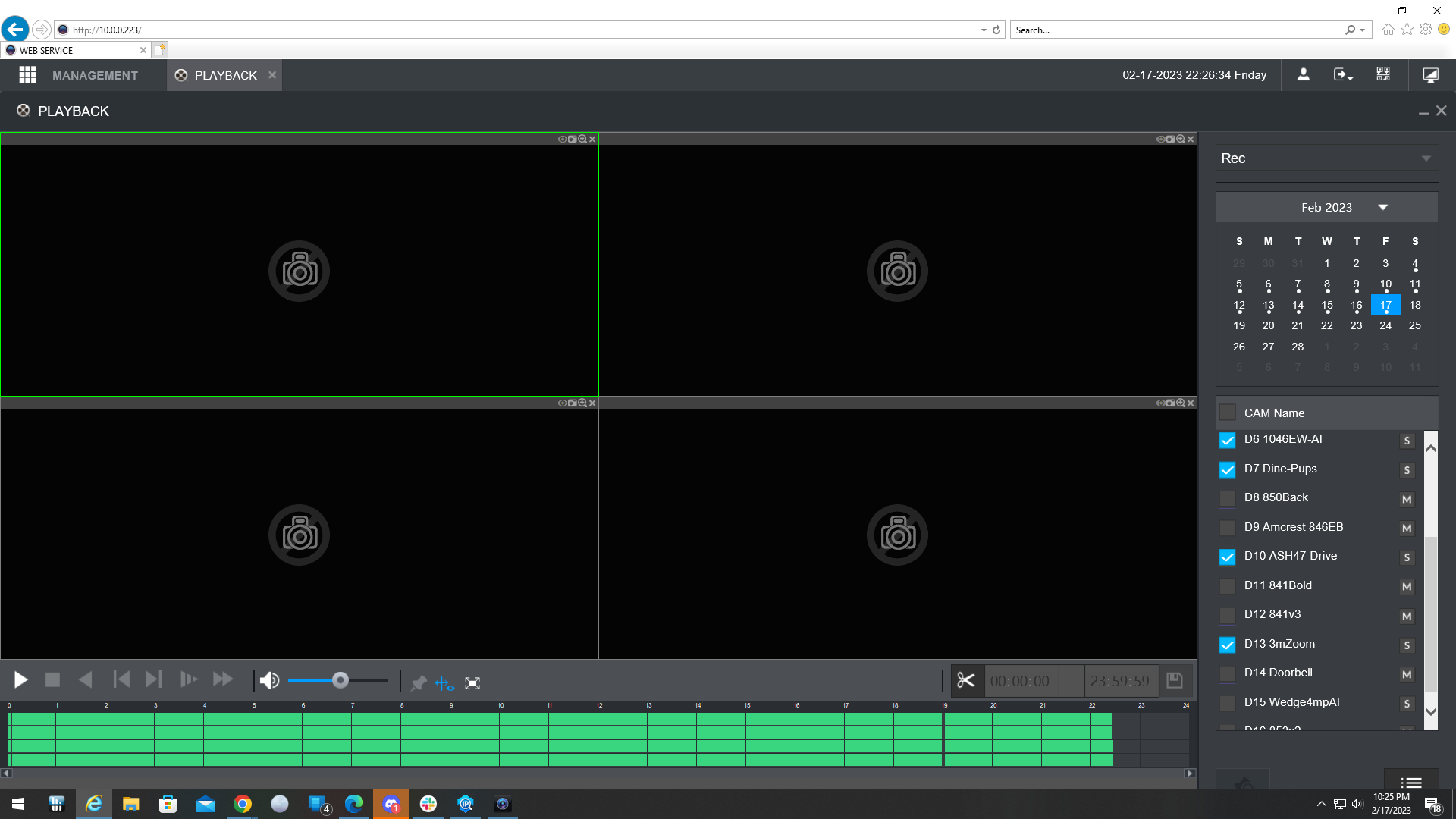

Today besides a short time where I rebooted the system
Screenshot (4073).png (153.53 KiB) Viewed 5943 times

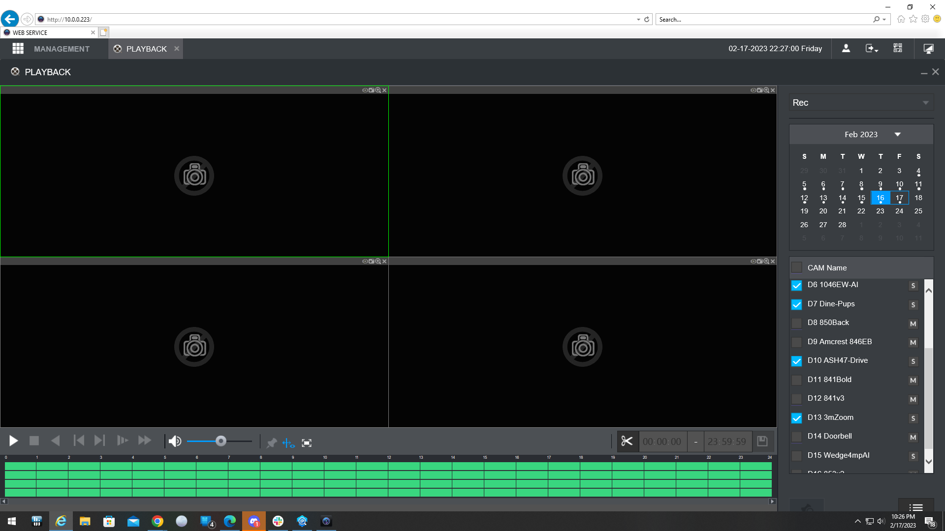

Yesterday and all the other days before look the same
Screenshot (4074).png (153.42 KiB) Viewed 5943 times

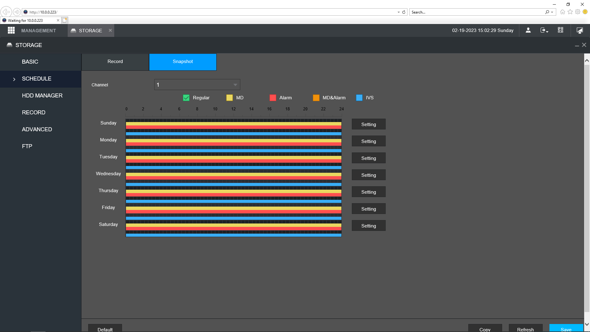

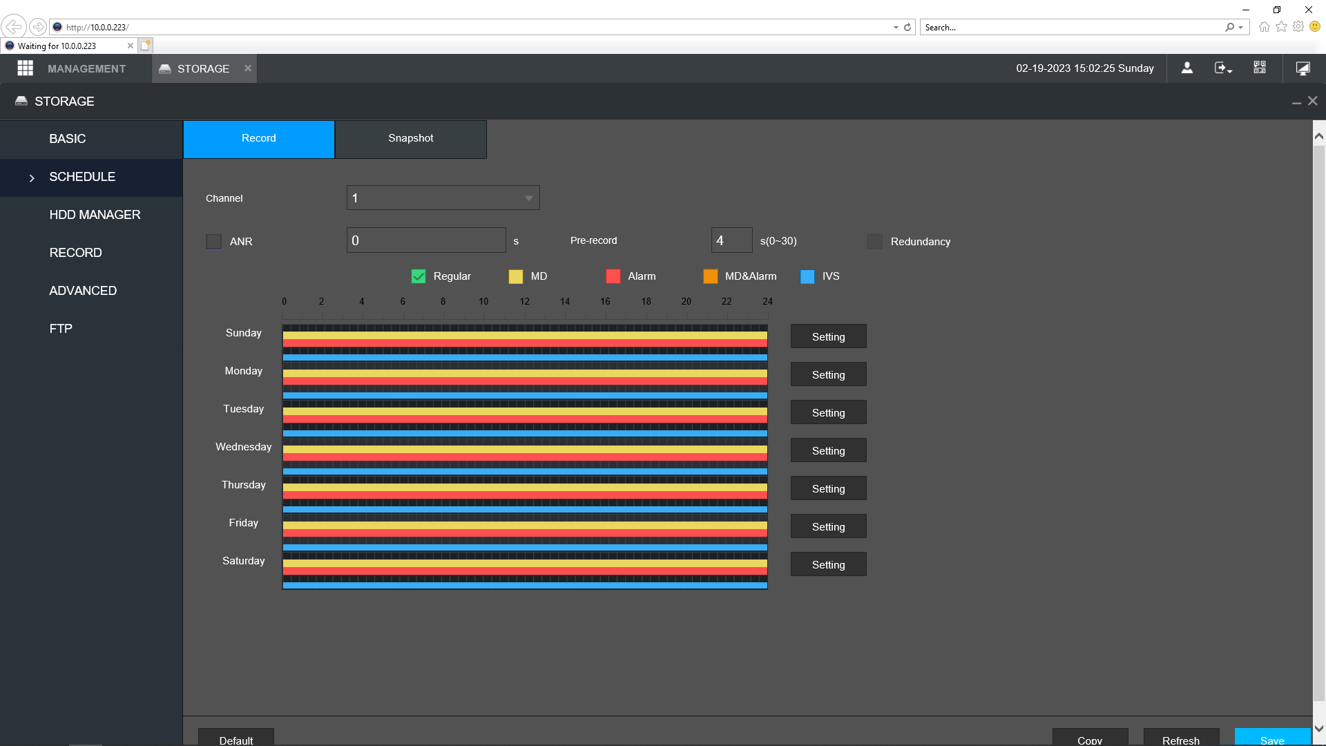

Here is what I didn't show in my Video. I was about to when I had someone show up and I cut my Video off abruptly. So to show my Schedule for Record and Snapshots so others are not leaving the Schedule for full time as it will be full time when moving record type to Manual for Sub.. That is how I have all my Channels setup for the NVR in the Pictures below.
Screenshot (4079).png (74.42 KiB) Viewed 5799 times
Screenshot (4080).png (69.66 KiB) Viewed 5799 times
