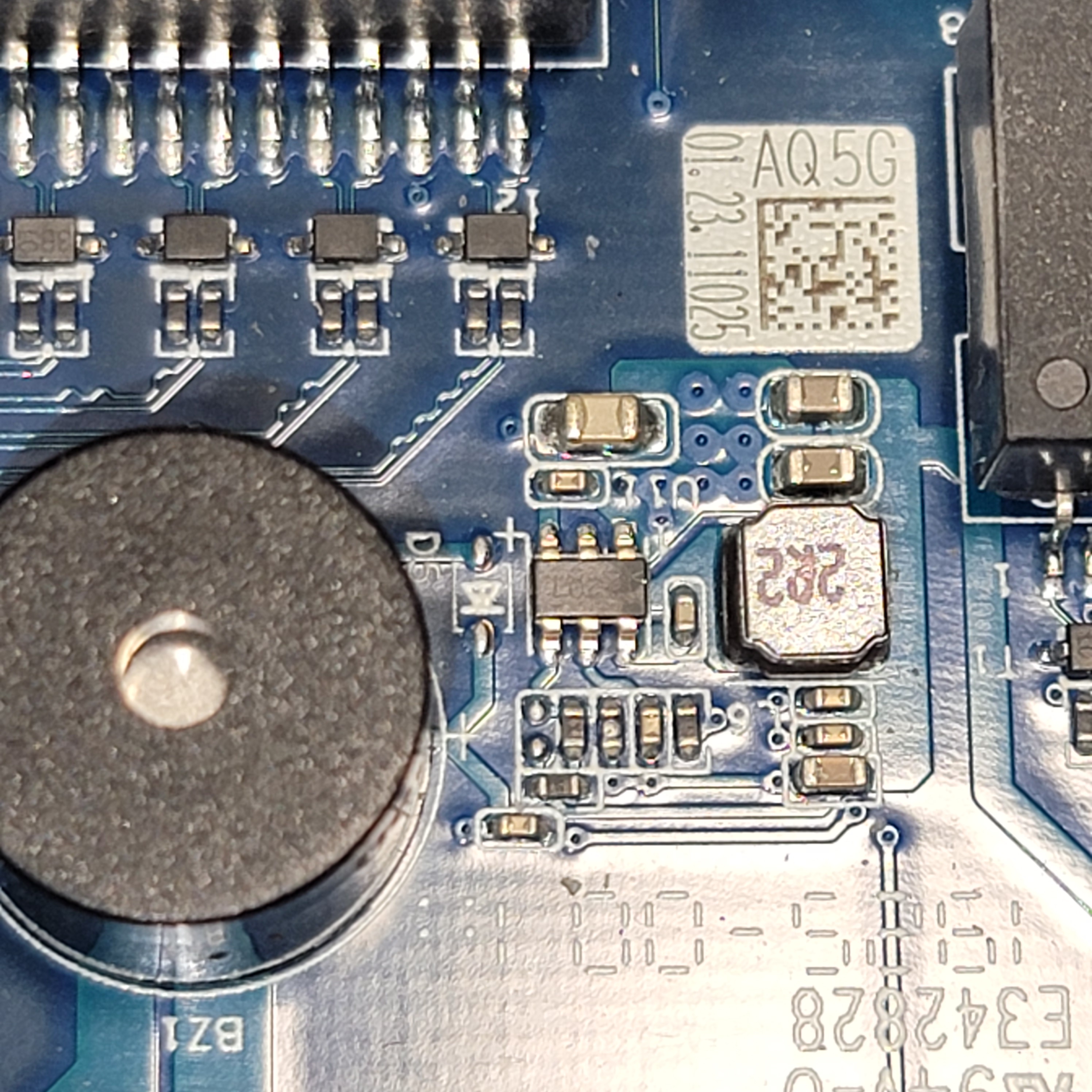

In my last post I thought there might have been something on the bottom of the PCB, However taking the board out there is nothing under the board, So looking again around the area I did find a 2201 6pin chip that is very hot, Not 160F however it does seem to be the issue of the device from working.
This chip is Micro in size being 1.60mm x 2.90mm or 0.063 x 0.114173 of an inch. If you look at the chip, Pins 1 and 6 area of the chip is dark black and is my guess the cause of the disruption of normal Ethernet for the device. What is odd is that the system can do a Search and find devices in the network, However when I add them devices it will not access them and if I try to access the IP of the NVR it will not let me. Just fails to find the NVR and IP config tools don't locate the NVR anymore either.. Will look for a donor chip until the one from China gets here.
