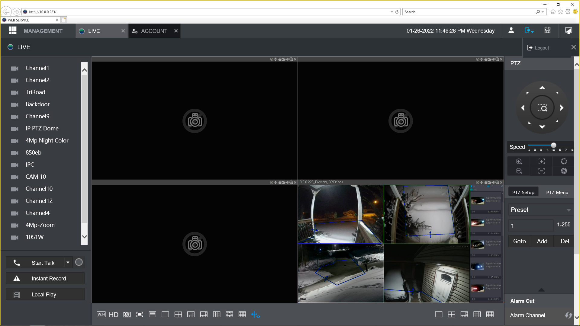

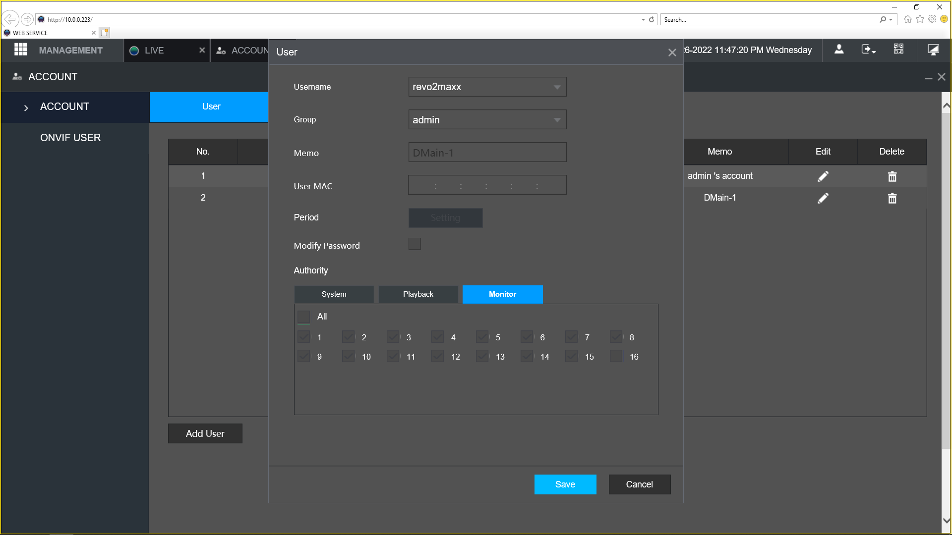

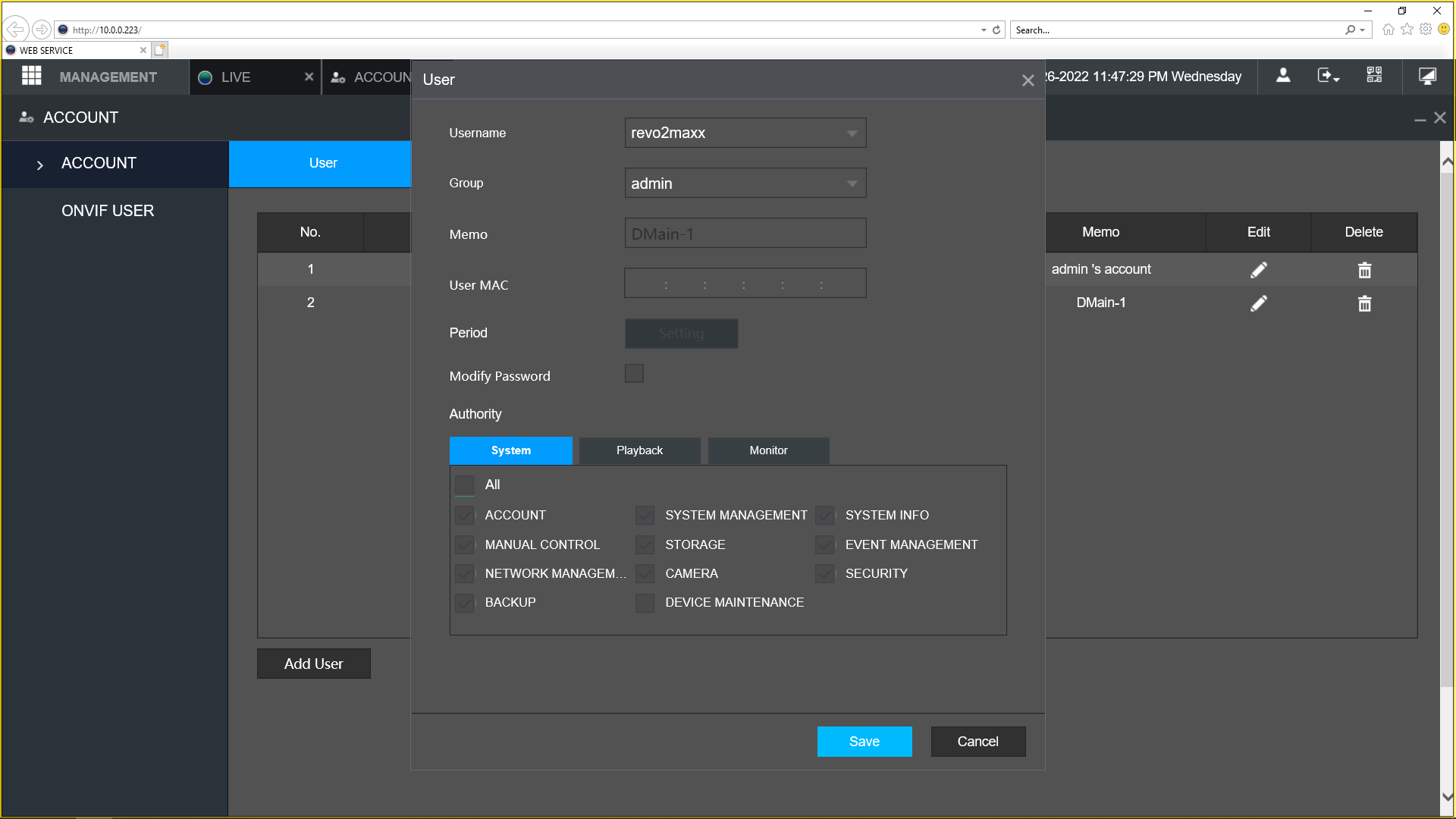

So I have been doing loads of testing on my own and have come up with another part that I thought I should mention. In the past I found on my 2116-HS that if you setup a second admin account and removed a channel from the line up it would make it so they no longer had access to Zero Channel in the Amcrest View Pro app. However I just found out tonight with some more testing that I am doing on my own for my own, Found that the flaw in still in the WebUI. please see pictures below..
Also something I feel needs to be addressed. Taking away the Maintenace for the new Admin is needed if you have a 4108(E)-HS, 4116(E)-HS 2116-HS or any of the ones that says turn off device if you shut it down. Like my 4216E-AI when you shut down it goes off. However all the others listed and any others that I have not had in font of me that after you shut it down on GUI it says to remove power. Doing so will keep that user from Shutting down by remote.. See Pictures below..
Picture of Admin with 1 ch out of the line up first 2 pictures show option removed and in WebUI still able to see what is going on in the NVR even menu and anything that you thought was only seen at the NVR's GUI it is passed even with 1 channel removed this is HIGH Security Risk give Admin account access with Caution...

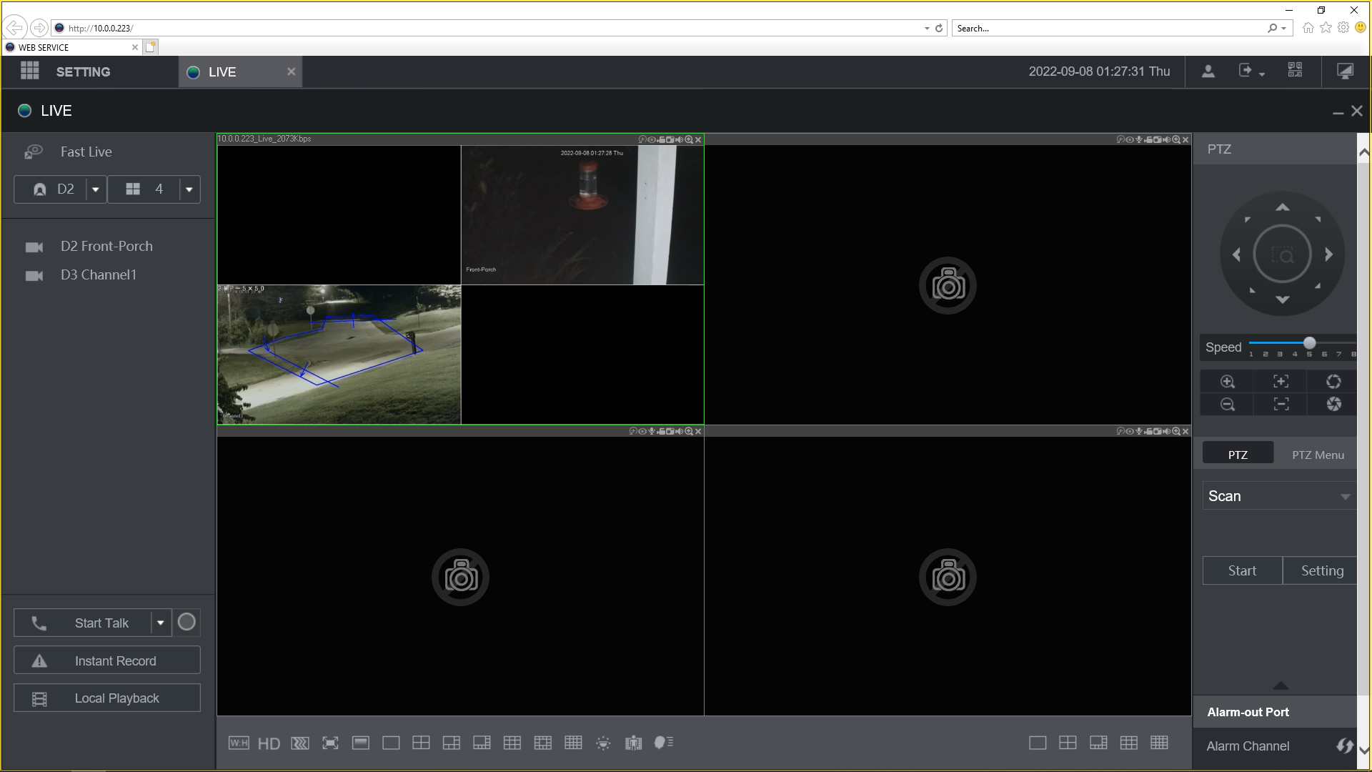

Also thought I would mention something that I Don't feel should happen either and that is..
In my 4116E-HS I just made a revo2maxx account for the first time since I reset it last week. I logged on and went to live, I then pressed the Preview Recover button and it loaded the 4 below with Grid setup and personally there is no need for it to take the last setup view of a different user and post it in the WebUI.
So Doing some more testing. I did find out some interesting things.. However it don't seem to solve the issue either... So as I was typing that I wanted to look something so I clicked 16 picture grid and all of them went blank on WebUI but I could see they were there. So I thought ok that is odd I pressed the X for Live View to bring up a fresh window and all the Zero Channel items on the right bottom was gone I was like OK it worked it is gone. However I changed the 16ch VIew off in the NVR back to 4ch , in the WebUI I refreshed the live view window and all the stuff came back for Zero Channel view again.. SO I thought Ok lets try removing Ch4 only no 8 only no 12 only no then did all 4, 8 12, 16 and still didn't take away the Zero Ch view and if I turn on Grid and GUI goes menu it still shows however if I go 16ch view and the WebUI Exits while still in Grid 16ch view the WebUI for live view will not return the Zero channel view and doing the Preview Recover don't return the view either..
