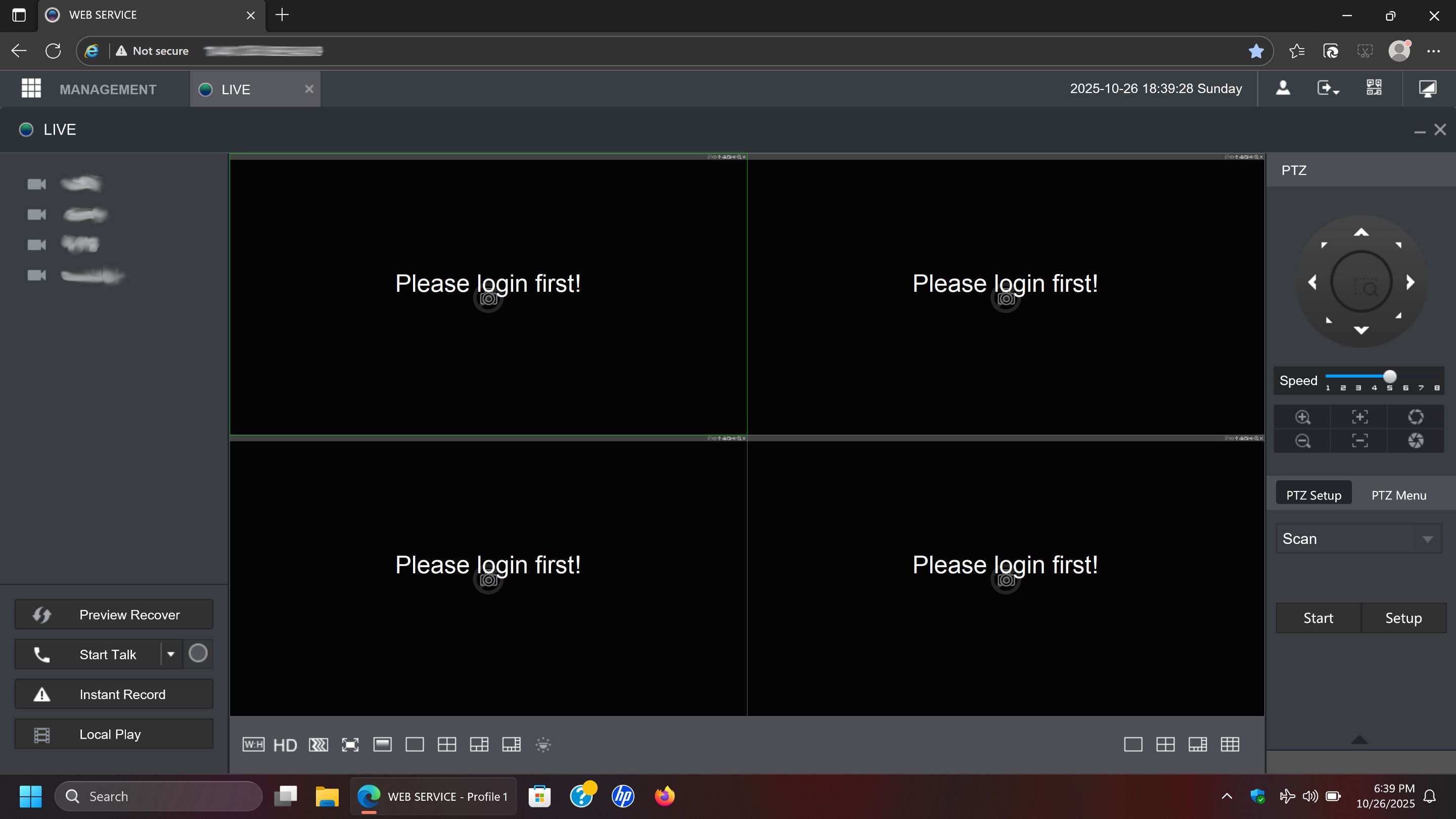

My Amcrest NVR was working without a hitch for a year before it suddenly wasnt. The NV4108E-HS was accessed exclusively with the built-in web interface, until one day the live and playback images were all replaced with "Please login first!" The fix sounded simple, just re-enter all the passwords for the cameras, as Amcrest support suggested.

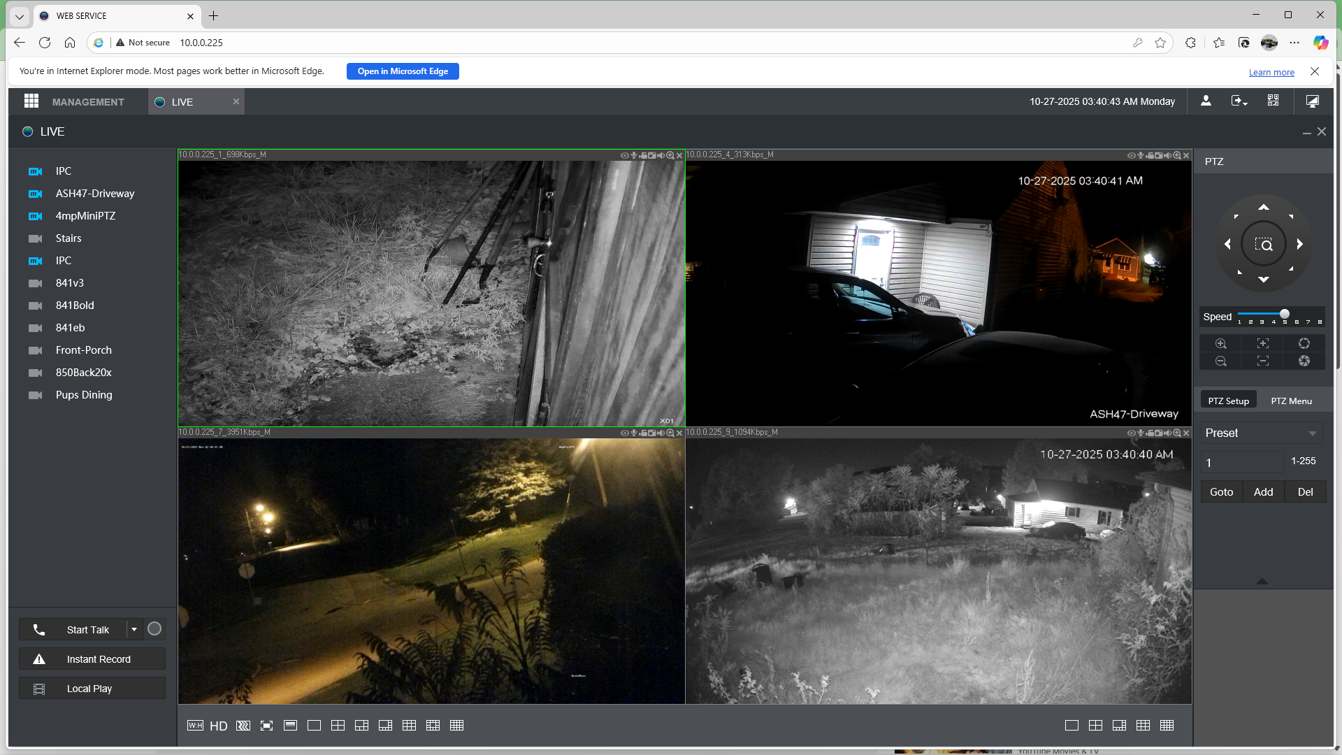

Sorry you are having issues. While you said hundreds of miles away how are you trying to access your NVR? I ask because I am still able to access my HS NVRs using Edge in IE mode without any issues? While I also have other NVRS like the 4216E-AI, 4216-E1, 4108E-A2, 5232E-16P and many others I can still access my 4108E-HS and my 4116E-HS local and remotely. That is access and playback stored footage as well..

Yeah that is something different then being "too old" So here is what I would do, Bring up your Browser and clear the cache for the system.. Don't get me wrong there are times that my HS gives some crazy issues, Like PTZ menu for my PTZ cameras the NVR says that I have to be on the main screen or something I don't remember now lol But I log out and log back in and issue is solved most times. If keep saying it after logging back in I will just Reboot the NVR and that normally cures it..

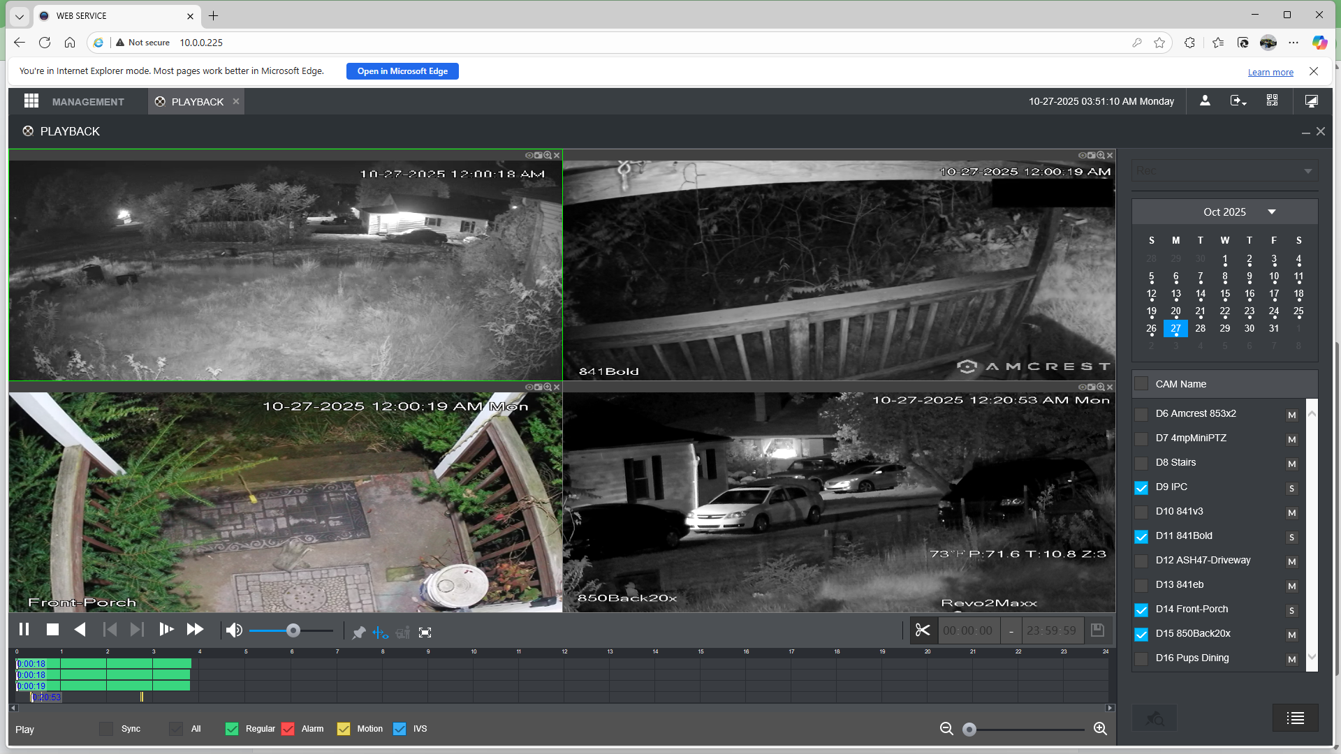

So most of my cameras on this NVR I am recording motion on main channel and full time on Sub.. In picture below you can see live view and in second picture I added in some playback. You will notice that my PTZ is showing 1220 that is off motion event where others are playing back off sub channel feeds.
