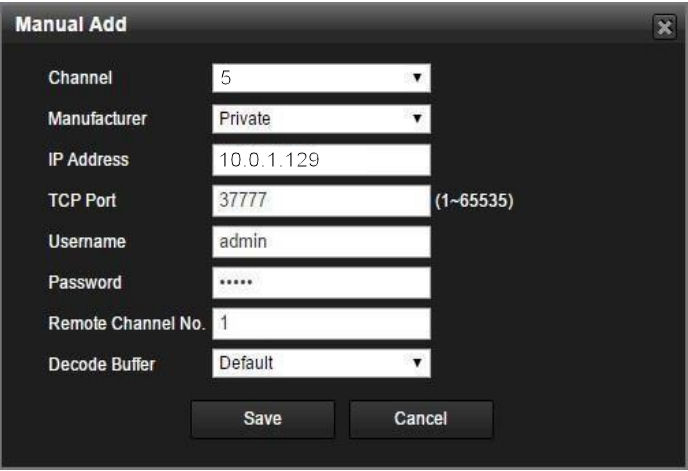

When you are trying to add your camera are you picking Port 37777 or what ever port you may have changed your camera to? Also might come up as Private
Screenshot (130).jpg (35.85 KiB) Viewed 2543 times

Revo2Maxx wrote: When you are trying to add your camera are you picking Port 37777 or what ever port you may have changed your camera to? Also might come up as Private
Sorry for the delay. The TCP Port is set to the correct port. Manufacturer is set to private. I'm not quite sure why this is happening.
