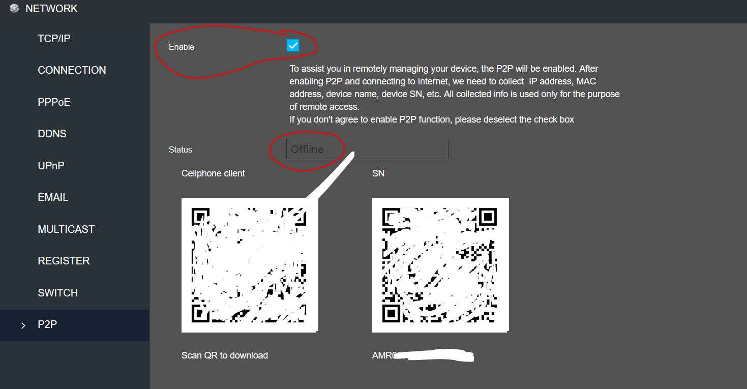

Been using the AmcrestViewPro app for over a year now. Last few days I can see my DVR/cameras through the live view when on wi-fi. As soon as I go off wi-fi, the app can't connect to my cameras. The NVR is a NV5216E. P2P is “Enabled” but is “Offline”. I have updated the firmware on the DVR, did not help. I have restarted the router, also did not help.

So it looks like the issue is the P2P is offline..
You will need to make sure that is enabled in the NVR and that the NVR has access to your Internet.. Once them 2 things are met the next thing that needs to be done is make sure that your Connection within your App is setup using the P2P and not using the IP address.. Seeing you can see it while at home or on your Wifi it has to be your using IP because your able to connect and the NVR has the P2P offline... So you will want to Remove the NVR from your AVP app and then press teh + to add it back, Then time pick the P2P option and once it is setup you should go able to access your NVR from home and away from home Wifi without issue...

The NVR is connected to the same router for the last year (I tried a new Cat6 cable). P2P is enabled but offline.
- P2P.JPG (98.65 KiB) Viewed 20476 times
