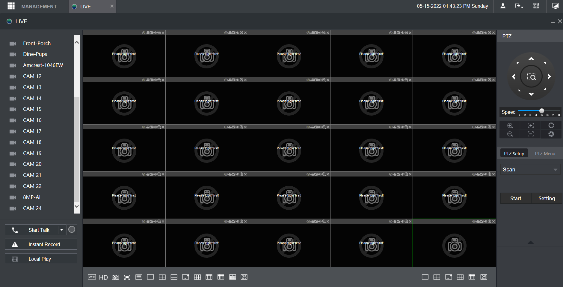

So then I was trying to figure out what is so Amazing that you were able to do it as far back as 2018, So I logged into my 4108-HS that is about 200 miles from me over ASP. So I was able to access my NVR, I was able to see the Cameras, I was able to make changes to the cameras in the ASP, I then look at the top and see something that says link to web. So l click it and it gives me a strange link to a local IP address. I then think ok Let log in I put in user, and it pops up and says enter new pass I was like huh.. Put in the current password and logged in, I then went to camera, I then click on the E next to one of my camera and I get an error that says not able to find that ip address.
So I think ok maybe lets see what happens on my 2108E that is remote, I access via ASP, I then click on Device CFG and then click on link to web, This time I don't get anything just the address with RTSP tcp ports and the HTTP port that are not open and so that connection fails. I then realize why I was able to connect to the first NVR. That is because I have the Ports opened from when I was using port forwarding method in the past. Thought I had closed all that..
So My guess is that your Connection on ASP was a Local one and the ports that it opened for your connection was (one not Blocked because it as really a local connection) and maybe that is why things worked as expected.
Maybe do it again and click on Live, and try to display the live video feeds from within the WebUI of the NVR it won't work either.. At least it didnt' for me. Even testing a Local NVR with cameras connected I can get a WebUI, I can log in but I can't display live feeds in that WebUI

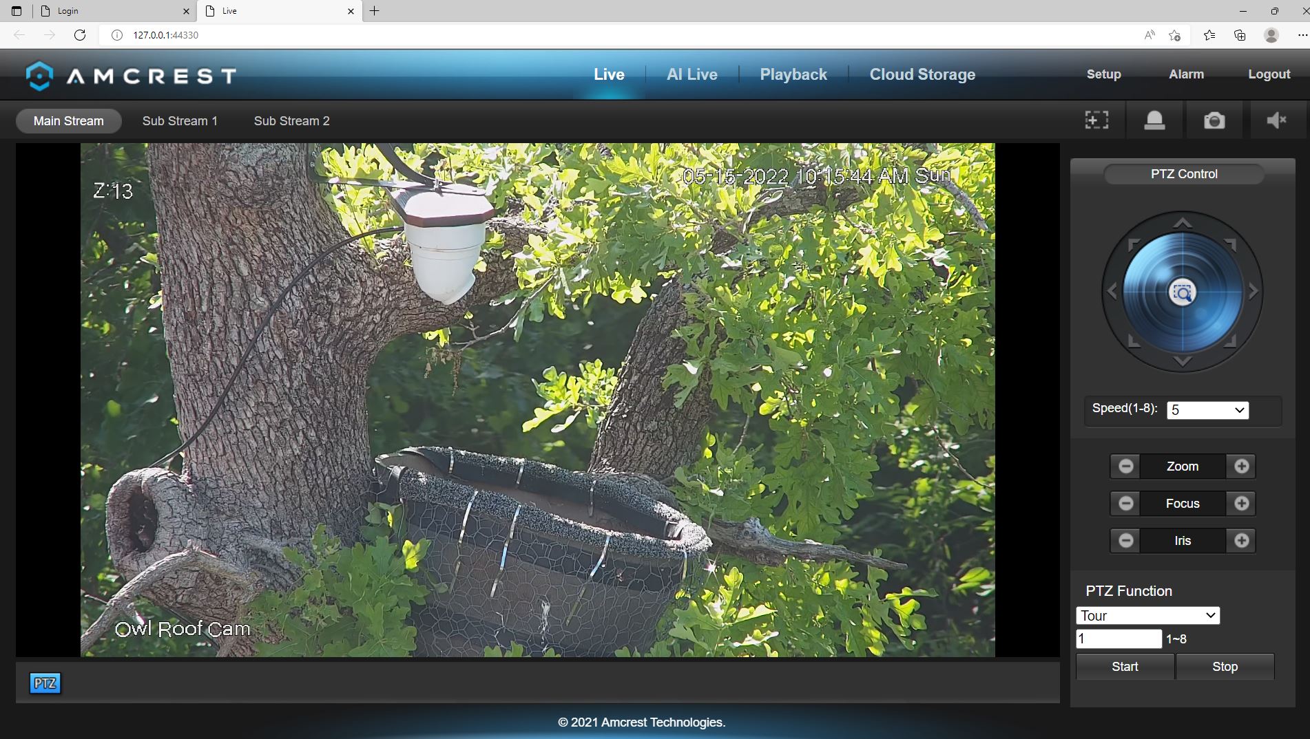

OK, here's how I do it.
Set default browser to EDGE.
Go to ASP Device config.
Select a camera directly connected to a remote LAN that was added via P2P to ASP.
Click Link to Web.
The only 2018 firmware camera on the remote LAN is a Dahua PTZ. So I had to use SmartPSS. When I used it once a while back, it worked for 2018 firmware after changing EDGE to IE mode.
I cannot do it by going to ASP NVR first with Device config Link to Web because it goes to the NVR Web UI and didn't work the one time I tried it.
