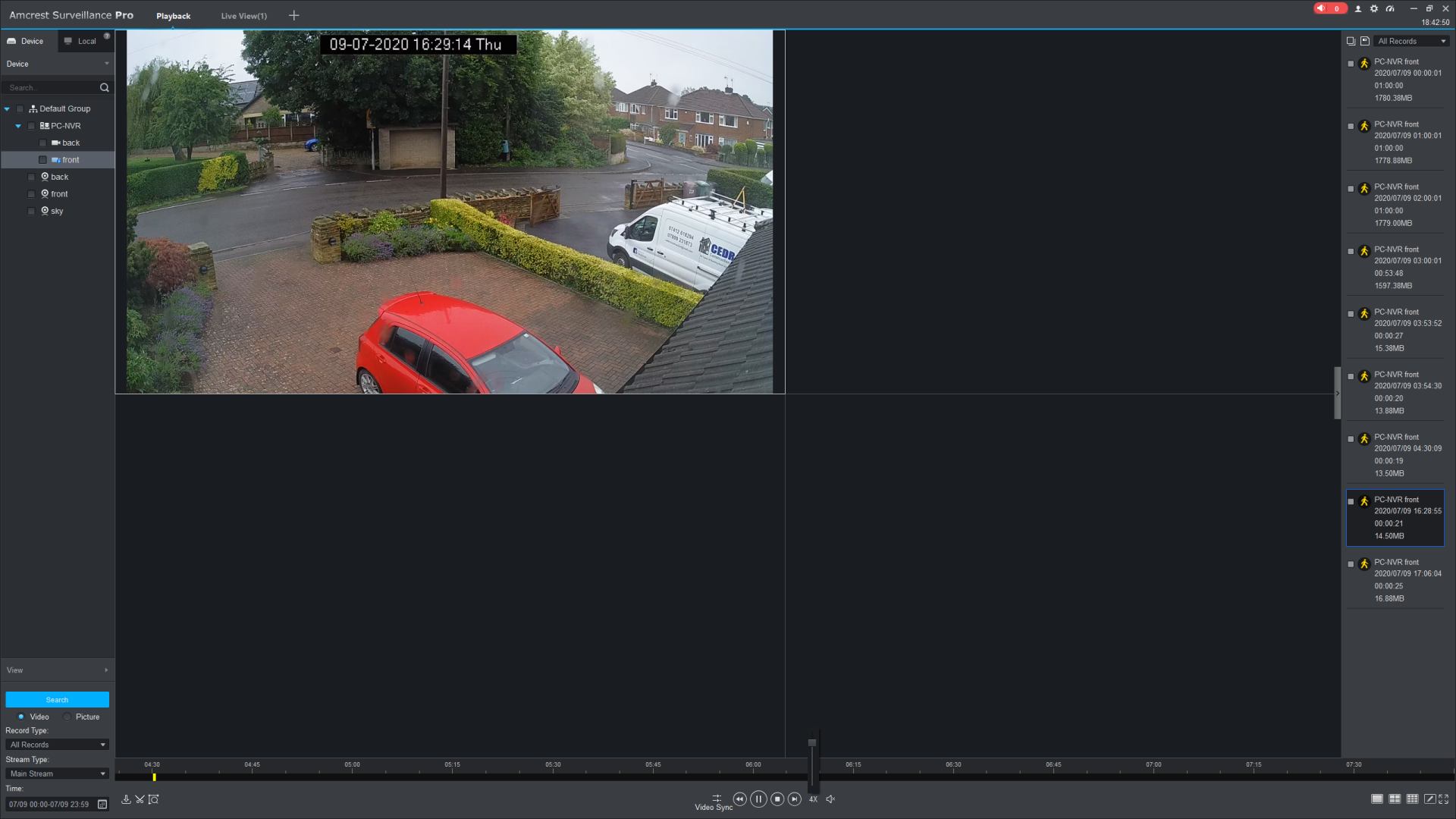

This shows the playback controls. Timeline is zoomed in and the speed control is set to 4x playback speed.
(This was after I had to restart ASP because of a crash that I've described in the ASP beta thread).

Thanks for the Image of V2 so it kind of looks like different skin and layout but the functions are still there... Humm I guess I will have to go get another one of my Computers and setup V2 on it lol I will just put it in my office rather then in my Security closet incase I need to reset it from crashes..

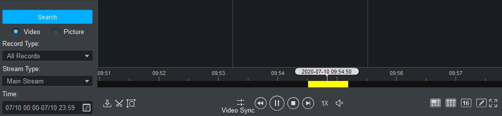

@attitude, you said the Web UI for your NVR does not work well for you. I suggested you try ASP on your laptop. Not to replace the NVR but to view and replay your NVR cameras instead of using Web UI. ASP has the functions to do that, but I can't say it will work properly with your NVR. You would have to try it. I don't have an Amcrest NVR.
In ASP, you can view up to 64 cameras in various splits.
In Playback, you can playback multiple cameras concurrently. Here's the replay controls. There are reverse and speed icons. You can also use mouse and wheel to size the timeline and select a time to replay.
