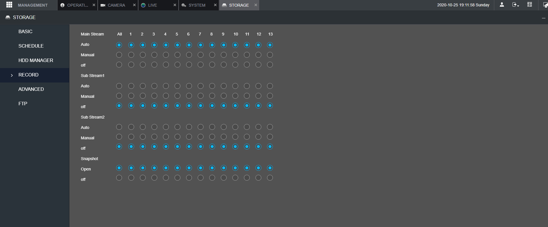

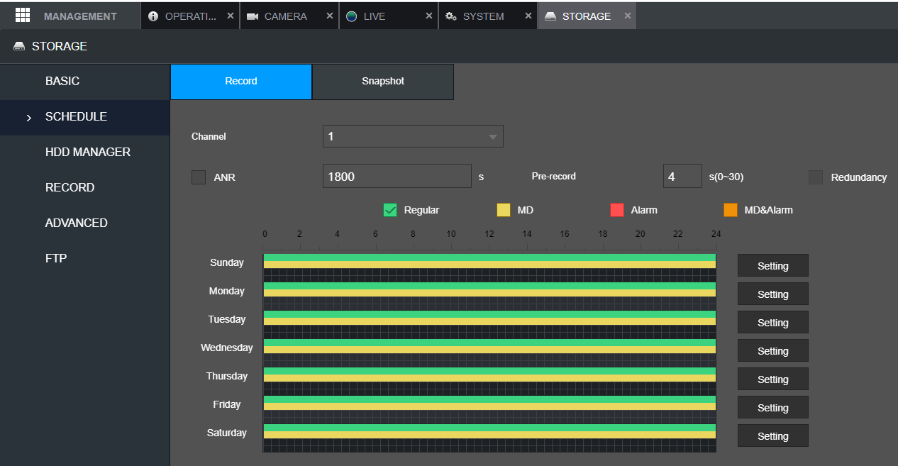

Ok So looking over things there are some things that needs to be fixed..
First in your Schedule you have both Full record and Motion active this is also going on in your Snapshots and because you have them active they are being saved that way as well full time so you have your 9+ TB hdd but depending on what you have your encoding at and the size of your Snap shots that is going to go fast with being on full time and Motion
Here is a Picture of what I am talking about from your setup in the one that shows the 2 lines that is saying you want full time recording and motion full time... This is how you have your Snapshots setup as well
then second picture is of your setup you will want to change your setup for snapshots on motion if you want in Schedule, and then change the cameras you want to record snapshots if not all of them...
Also it looks like you have Extra Stream off that might be bad if there is need for your extra Stream/ aka Sub Stream you might want to turn on at least sub 1
James..

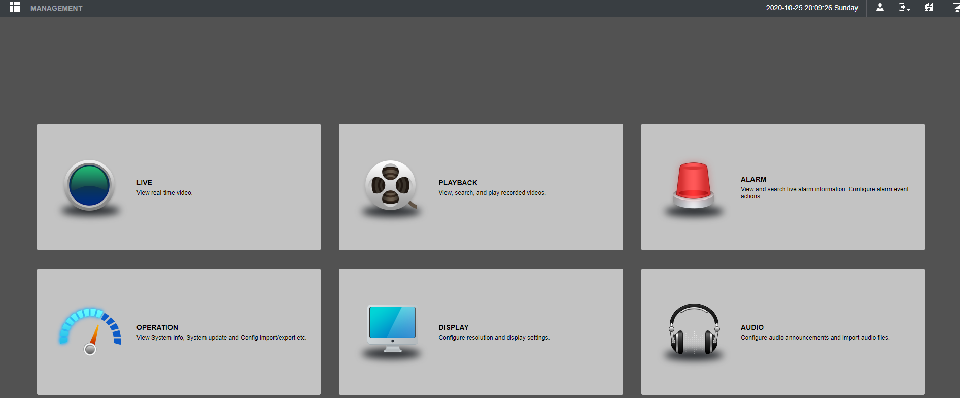

While I have to admit your WebUI is loads different it is all there though..
Looking at your Load in Screen you would want to click on the top Management for most part... IF you wanted to go to LOgs or your system info then you would use the Operation button or tab what ever it would be called on the screen...
The little Door Icon on the top right not sure I like that they have the Shutdown command on the WebUI.. I like the idea of having a Logout and Reboot but Shutdown not such a good idea in my mind....
