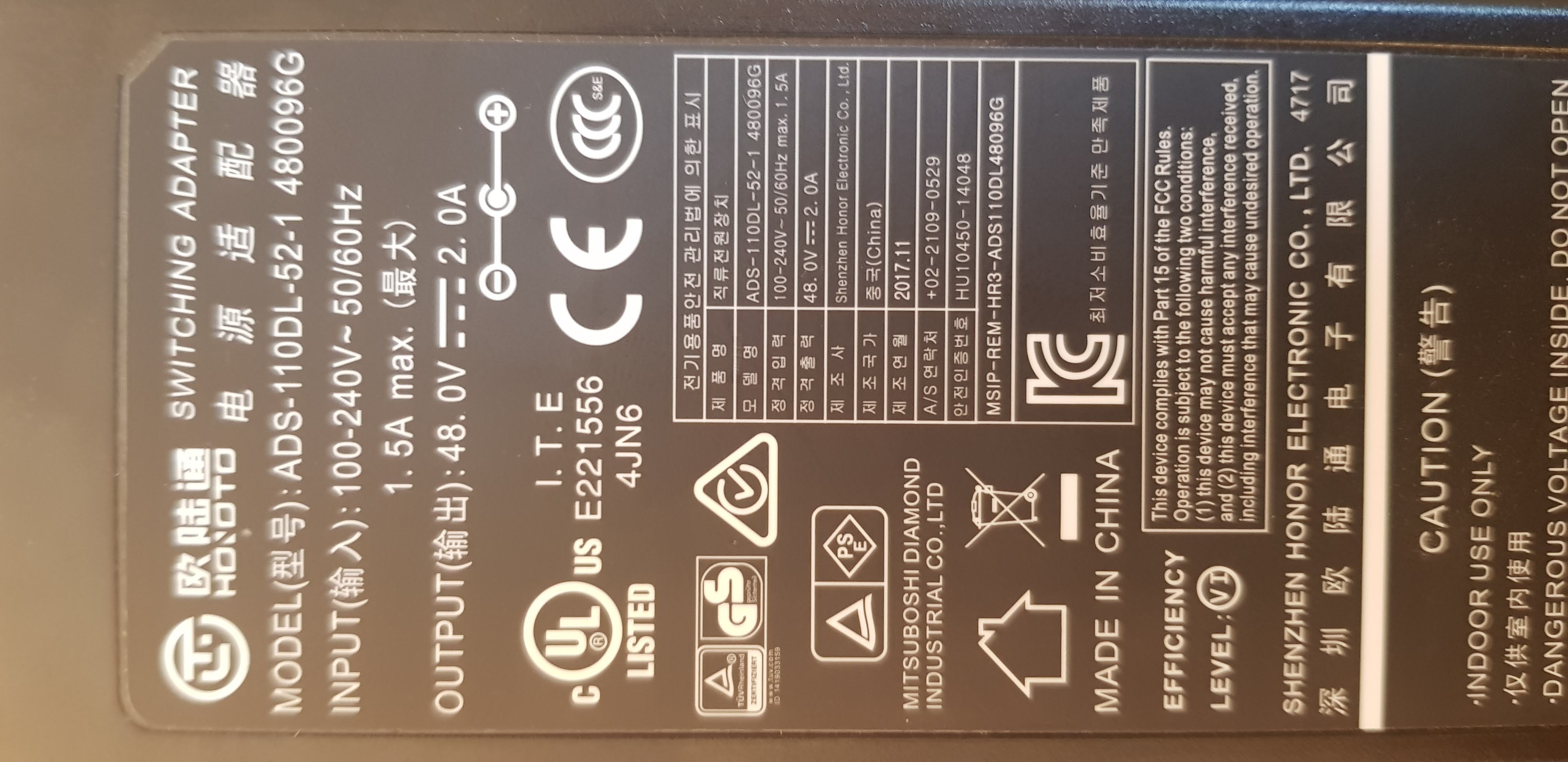

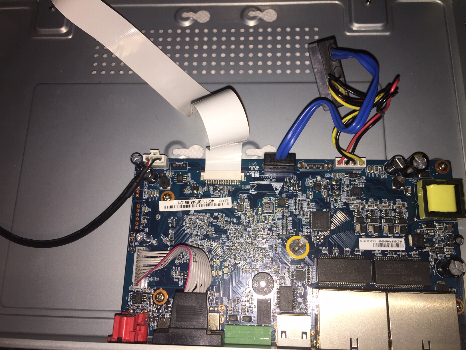

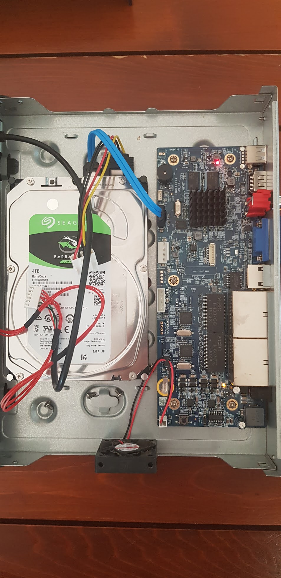

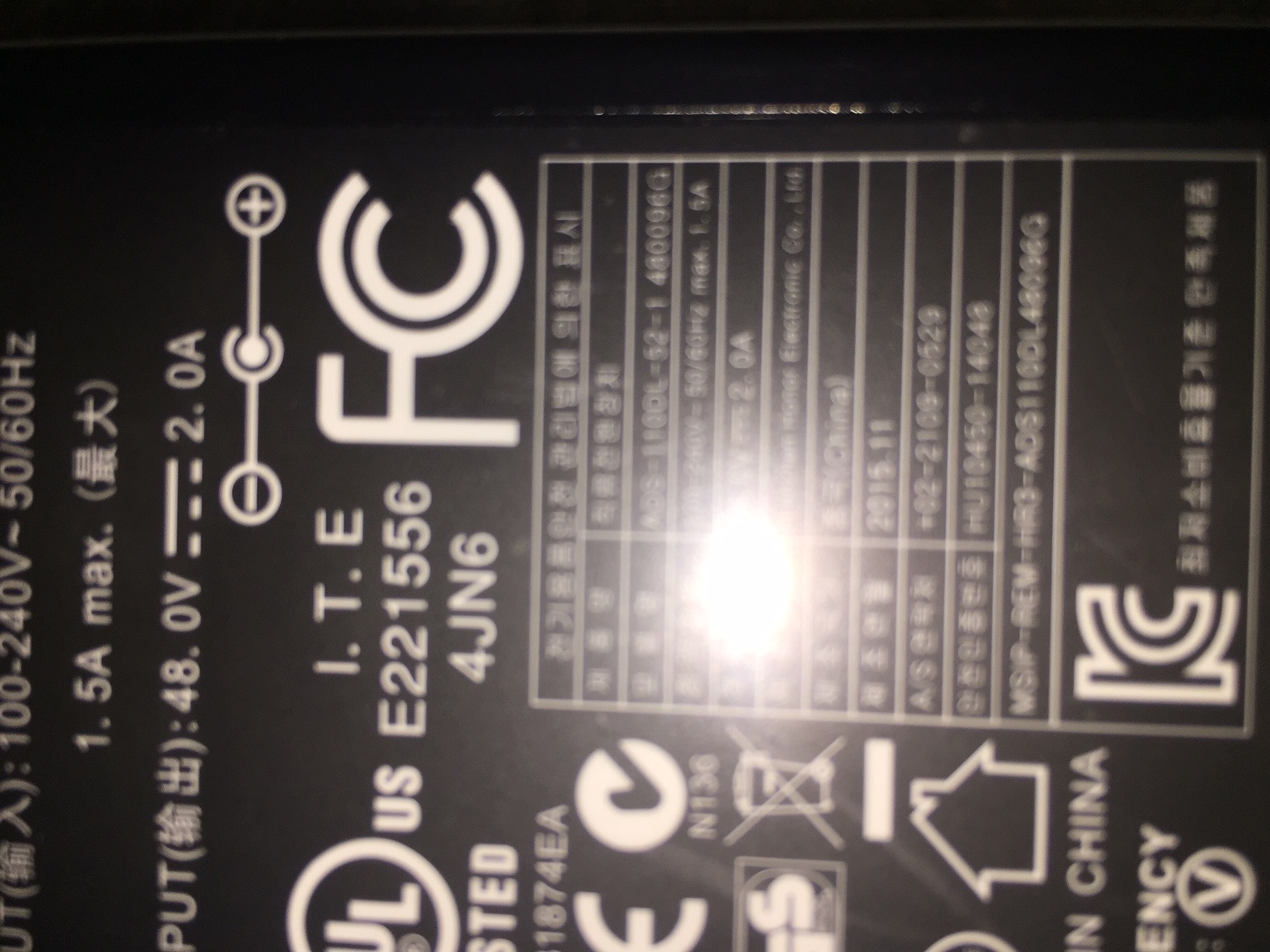

I've attached a picture of the power adapter and also a picture of the motherboard while the NVR is turned on and the HDD disconnected.
There is two leds (orange and red) constantly ON on the motherboard. Not sure what it's supposed to mean...
Note that when the HDD is connected, the NVR also turns on and I can hear the HDD starting up. Both leds are also ON when HDD is connected.
Is it possible that the unit was permanently damaged if a wrong power adapter was used? It might have happened in the past (I'm not the direct person which purchased the unit so not sure if something could have been messed up before).

Ok, So looking at your machine picture again. There is one thing I will say your system will not work in the state it is in..
You need to plug the Front back in,
The USB on front isn't a System killer but the Front panel is if there is no power going to that front area the system will not work... So with no power on it, Plug the one that goes to the main board on the front testing a Bad USB is another step but seeing it is unplugged then just keep it that way for now.. Because one of the things that happens on older machines or can happen that Front USB can get damaged and make the machine stop..
Looking at yours and mine yours is different then mine for sure. My 2116-HS has a bottom frame like that where it could hang on a wall my 4108 don't have that frame.. Also my 4108E has a Ribbon from the front to the MB where yours is a Wire set... So leaving the power from the hDD plug in the front and turn back on with HDMI cable in the system unless you don't have then connect with D-Sub
About Damage it could have been from past sadly wouldn't know without touching it, testing with a Known good 48v PSU..

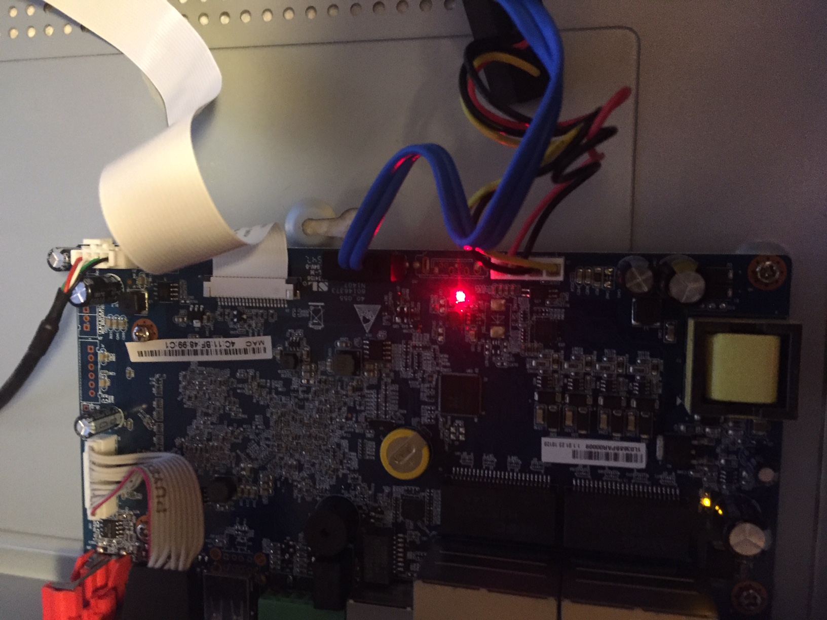

Re: NVR 4108E-HS no display no ethernet
Humm oddly I have 2 lights when powered on. While my front is different then yours so while I said it wouldn't work without the Wires plugged in that might not be the case for yours but min will not work without my Ribbon cable being plugged in...
While this unit was also bought with a 4tb installed, it was bought early 2017 even though the power supply is from 2015 lol. However it might have been a Rebuild but when I bought it I was able to see the Building teams Logs on the system build and there was nothing before 12-16 so maybe it was just year of Power supply and nothing to do with age of the machine as they could have just had a huge supply of supplies and who knows lol..
So when you plug in the system does it Beep after about 20 to 45 seconds? or just does nothing?
Power supply Picture without Drive installed Powered on
