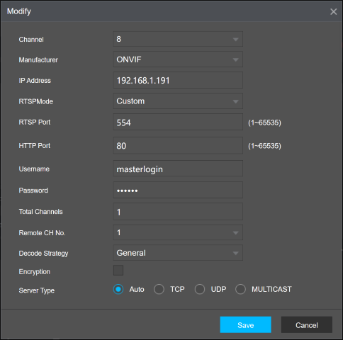

Sorry for the late reply. Actually, there was an issue for me after the update. I have a D-Link 2630L 180-degree camera that does not support ONVIF. I was able to capture the RTSP stream on the older firmware using some custom settings, but I don't recall what they were exactly. This new firmware provides PRIVATE and ONVIF settings, with the ONVIF offering CUSTOM on the sub-menu. The problem is that I can no longer connect this camera. It seems counterintuitive to use the ONVIF cameral setting but that is the only option that allows RTSP input. I am able to connect to the RTSP stream using VLC but cannot determine how to provide the proper settings in this new dialog.
