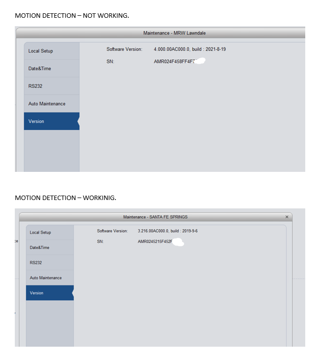

ONVIF Cameras that were working normally stopped recording Motion Detection. Now I only have continuous recordings "Regular"
In the attached image, you have the information of 2 NVRs of the same model.
The NVR with firmware version 3.2..... allows Motion Detection recording.
The NVR with firmware version 4.0.... is not recording the Motion Detection of ONVIF IPCameras.
Any solution for this?
Can I get the old firmware version? Is it possible to revert to the old version on the NVR?
NV5232 - Motion Detection
- motion_detection_nvr.PNG (52.23 KiB) Viewed 776 times

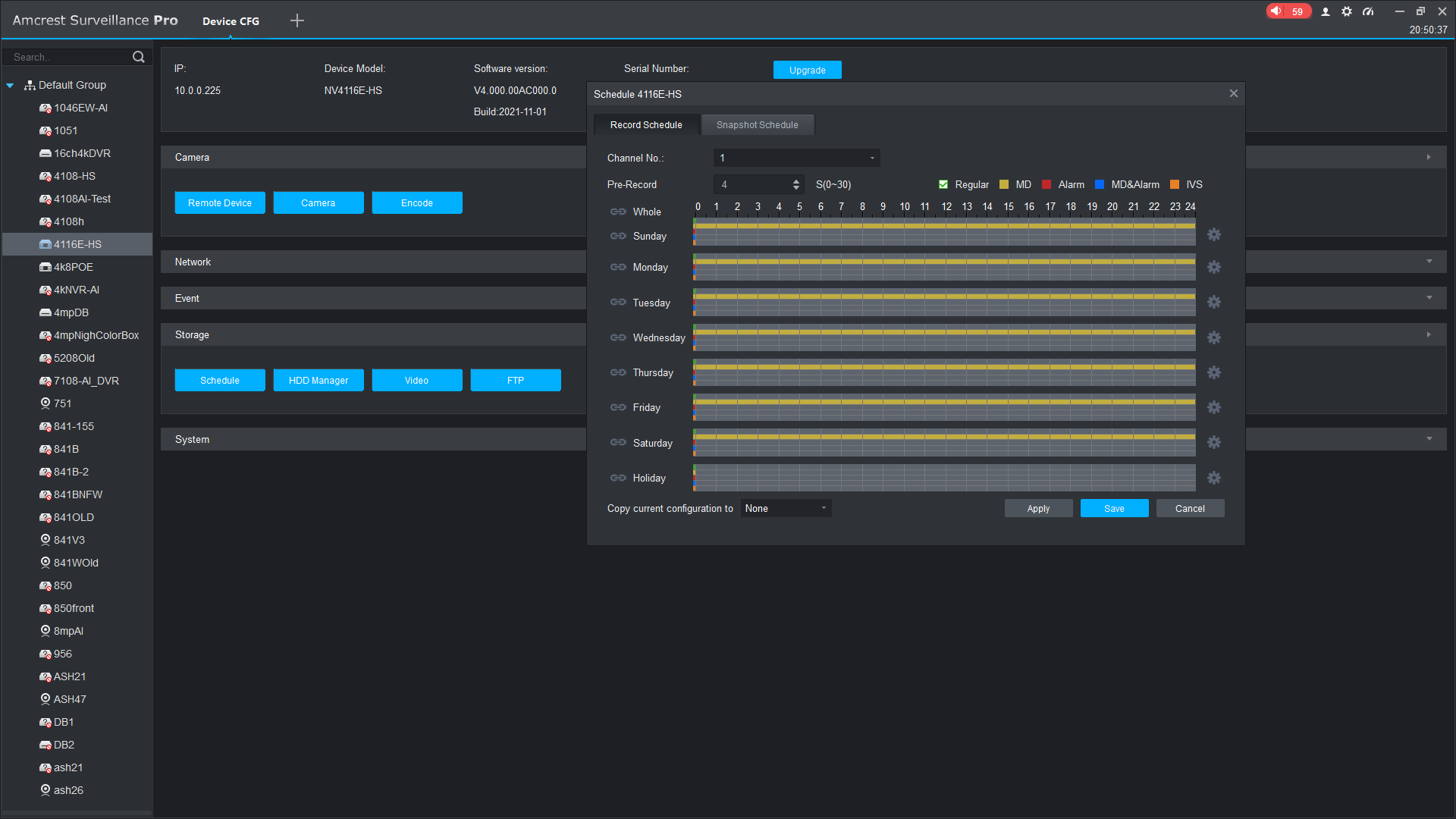

Here is a Picture of my 4116E-HS for setting up Motion only on Ch1

Hi, thanks for replying.
I'm waiting for an official response from Amcrest, because they stated that the New NVRs do not support ONVIF IP cameras of other brands, or with feature limitations.
On the NVR, yes everything is configured and active for Motion detection.
I have management of Multiple NVRs, I noticed that the units purchased in the last 4 months came with new firmware, and these new units stopped recording motion detection.
That's why I put in the image the comparison with two equal equipment, but with different firmware versions.
The version with a date of 2019 works with motion detection, the new version with a date of 2021 doesn't work with motion detection, I'm still using the same cameras. (Microseven Camera)
I would like to get confirmation if I can get the old firmware version and if I can use it again on my new NVR, as the model is the same.

Yes that is how they are with all cameras and has stated that info for many years.
"Supports all Amcrest WiFi and Wired IP cameras and limited compatibility with third-party IP cameras. " <----- as stated on the Website...
Just so you know I personally bought a different company because that was the answer I got when I asked if I was going to be able to use my Cameras on 8m16 or other DVR that I owned seeing I needed a RS-485 port for my CVBS PTZ cameras. However when I was told maybe they wouldn't work I bought different Brand. I have since bought a 7108-AI DVR that did work and also had at another location that I have since had sent to me the 8m16-H5 that also works with my Cameras and really wish I would have had that to start with for my other cameras..
So that limited list I can tell you that any of my NVR's I own from Amcrest the Microseven company isn't even listed as being supported. While don't mean that it isn't what it means is like in your case it worked on older FW.. IT don't on the newer FW and isn't part that is normally controlled for updates.
Your best bet would be to get a RMA for a system with older FW as they will be released with older FW from Amcrest and the End user will have to update to the 4.0 so your not wasting loads of time RMA is best bet unless you bought used then you might have to send back to them and pay for a Reflash..

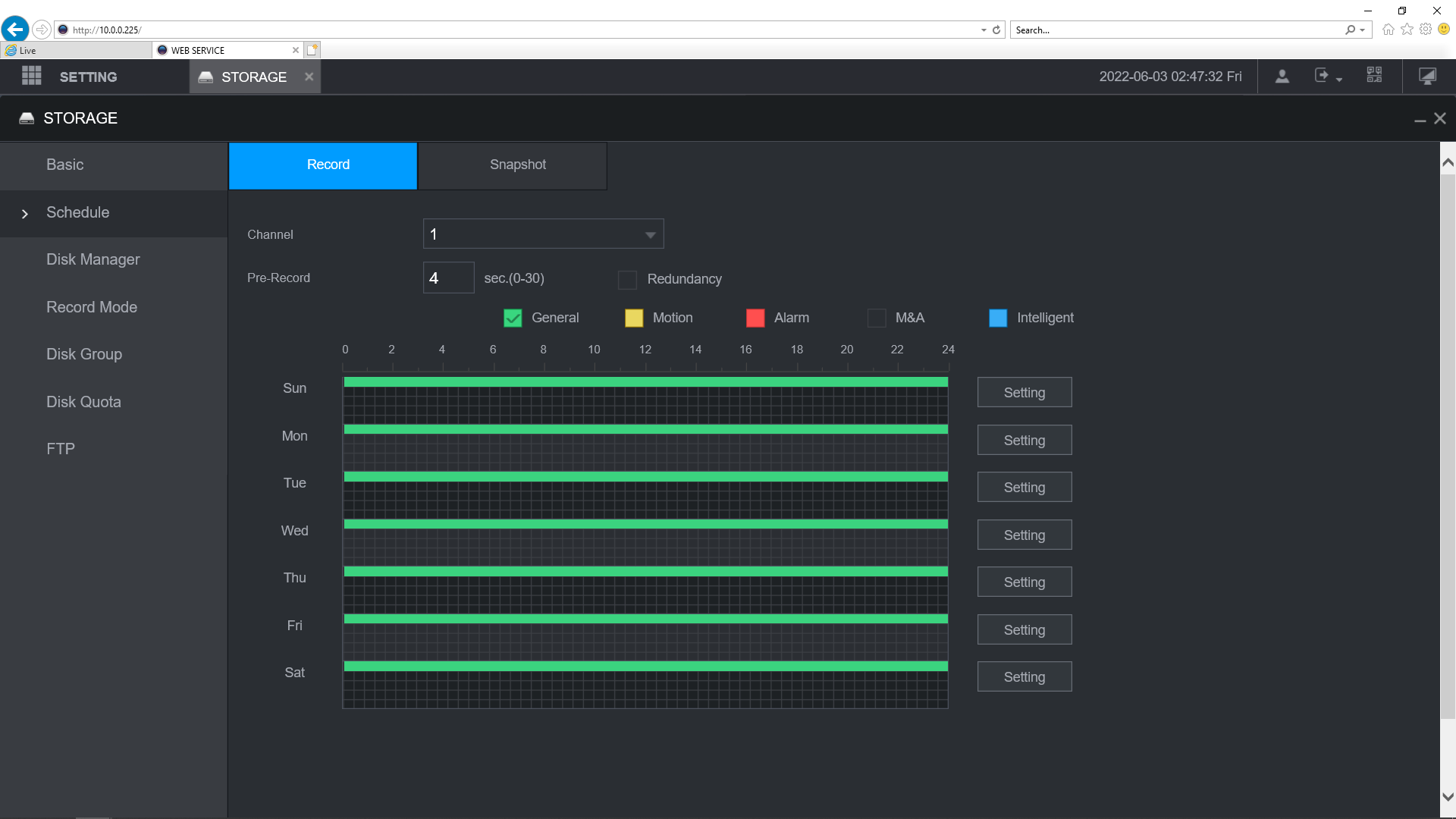

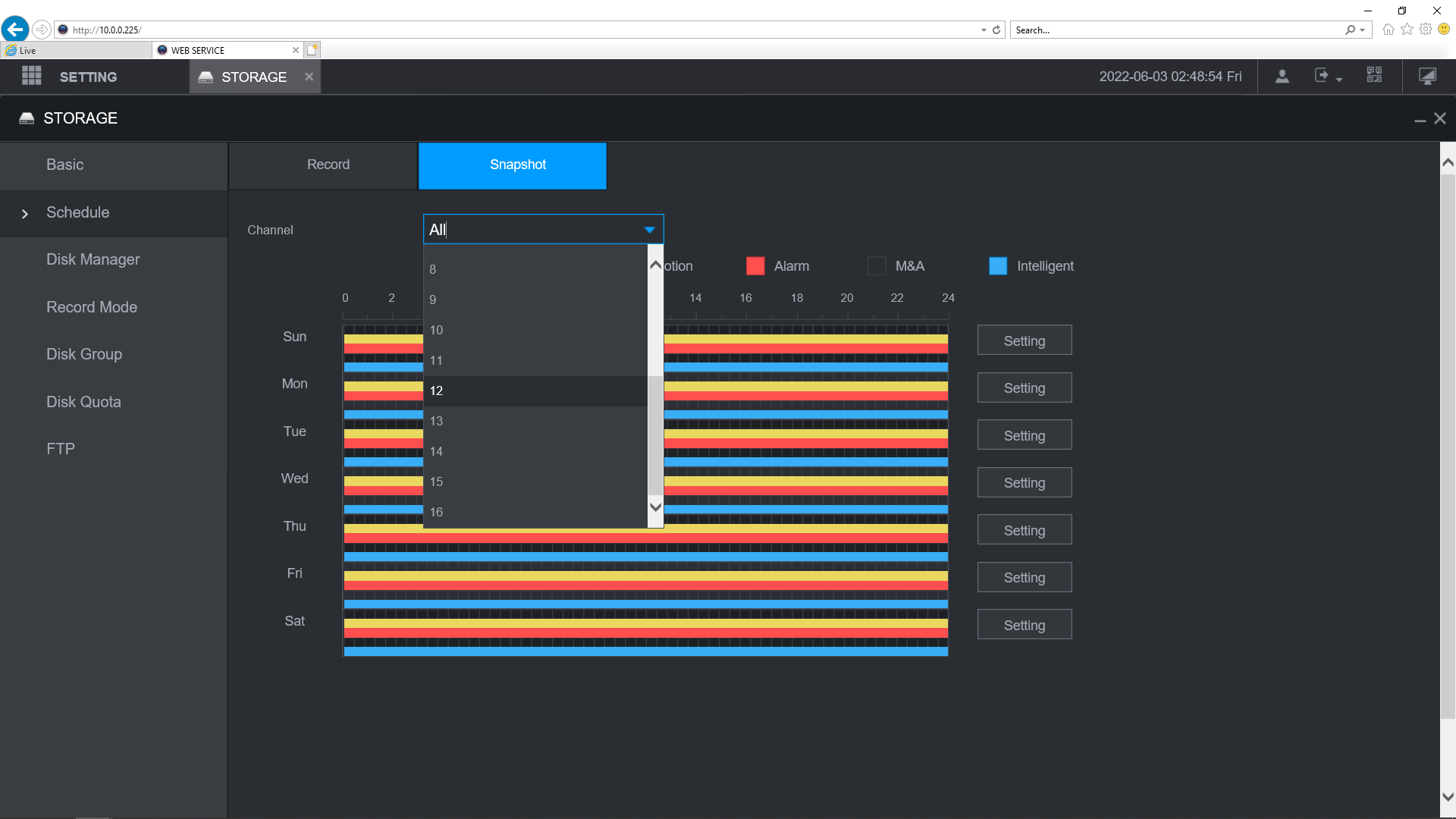

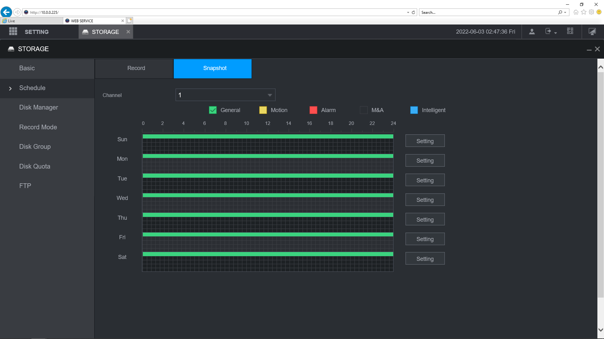

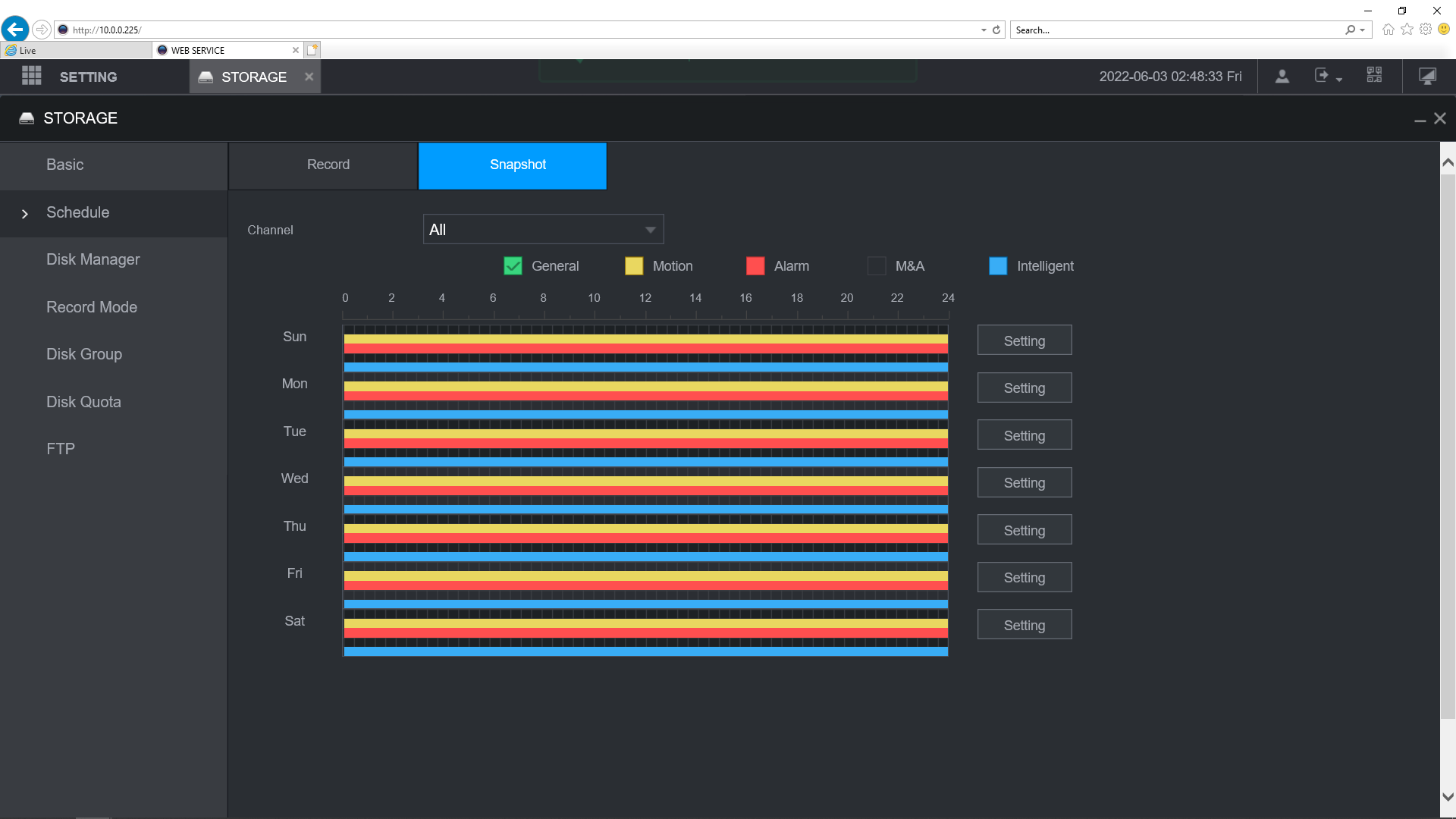

Last night I wasn't able to upload and forgot about it however I did a Reset of one of my NVR's and as set up from start was Full time Record and Full time snapshots. First 2 is right after Reset, second 2 is how I setup mine besides the ones that I want/need full time
