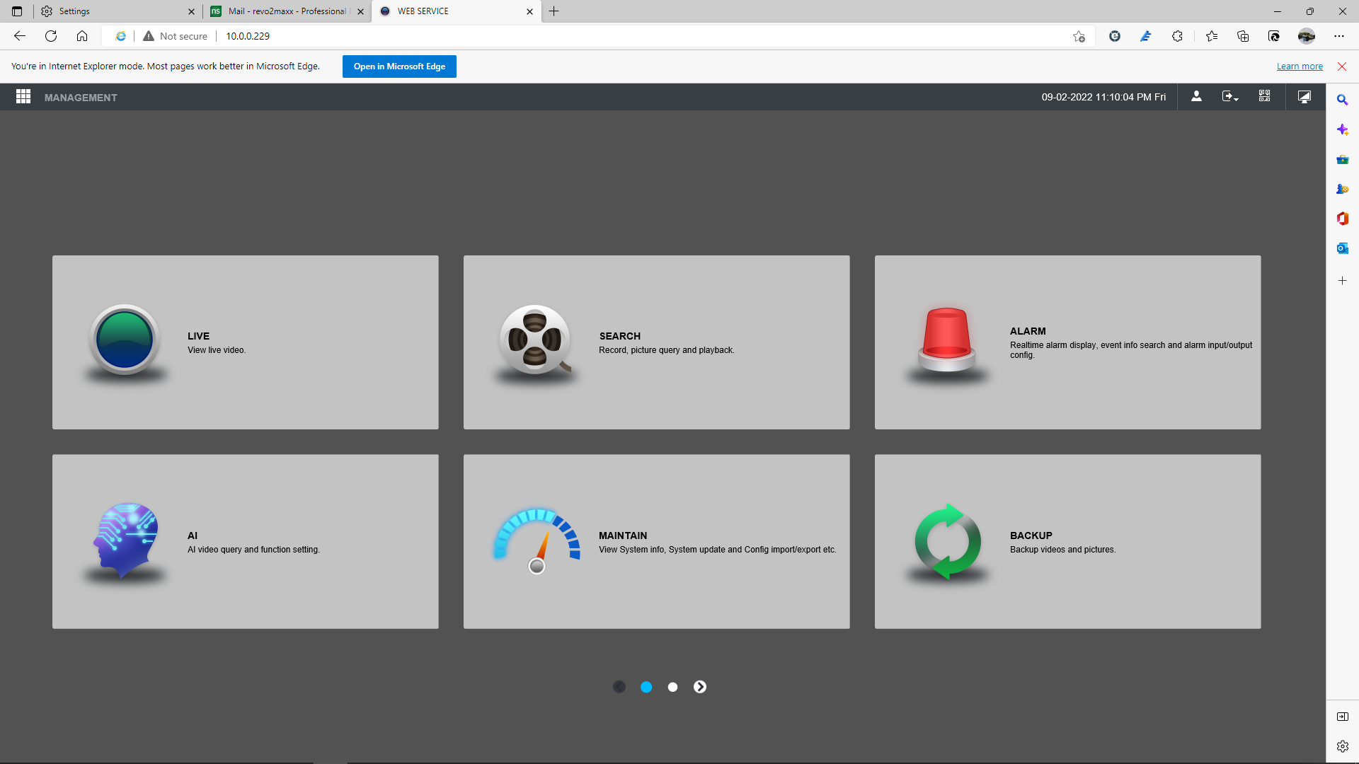

Yeah think the issue is Chrome..
I would try edge and try this..
Bring up edge, click top right 3 dots, go to settings, then Default Brower, (You are not setting up as Default and I wouldn't if it asks just say NO) However in that box area at the bottom there is a Load in IE mode. Click the Add, Then enter the IP address for your NVR, Then save. Now click new tab, then enter the Ip address, Then it will bring up in IE mode, It will ask you to more then likely to install forget what it is right now but same option needed to run in IE browser your just using Edge to run IE.. Once you have it there will be a new line and it will have a box trying to tell you to run in Edge just do the IE and ignore edge lol.. I think you will see it running better in there..
