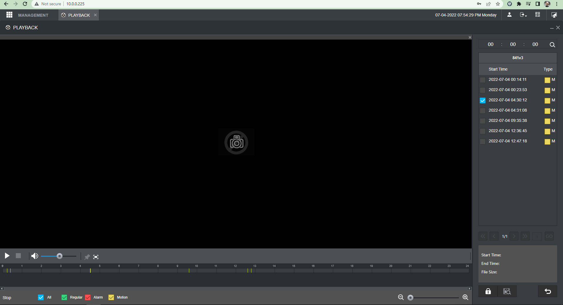

I have this NVR and I see instructions on how to download files from it, but the floppy disk icon is missing. Anyone know how to download from the browser?
Web Version v3.2.7.121467
System Version V4.000.00ac000.0 Build Date 2021-08-19
Security Baseline Version V1.4
Soft Version 10004
nv5216 Missing download function

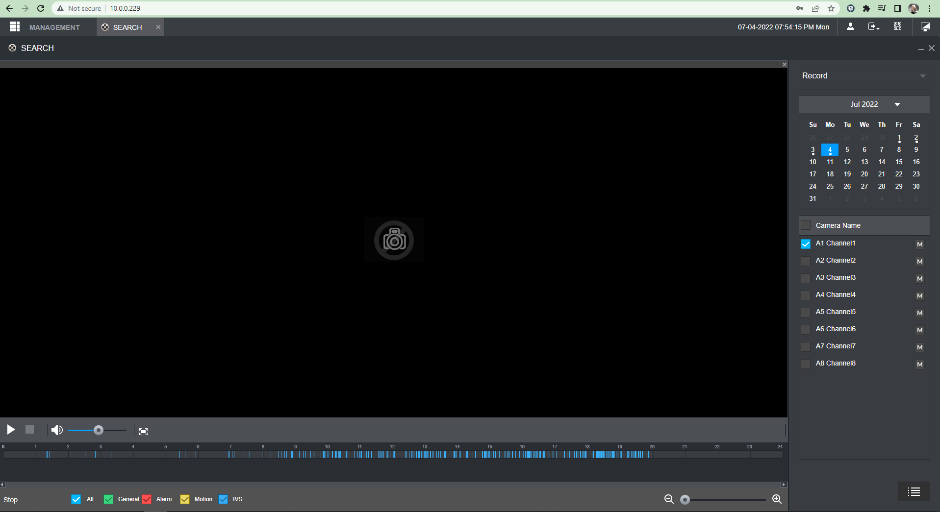

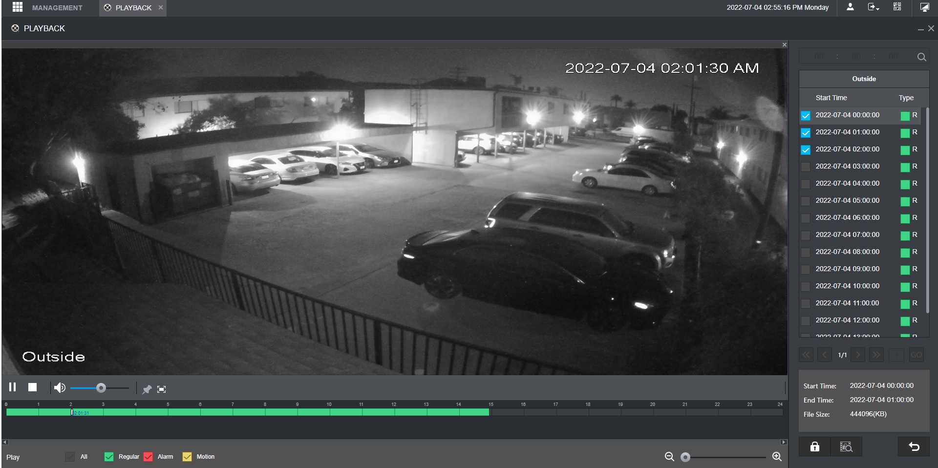

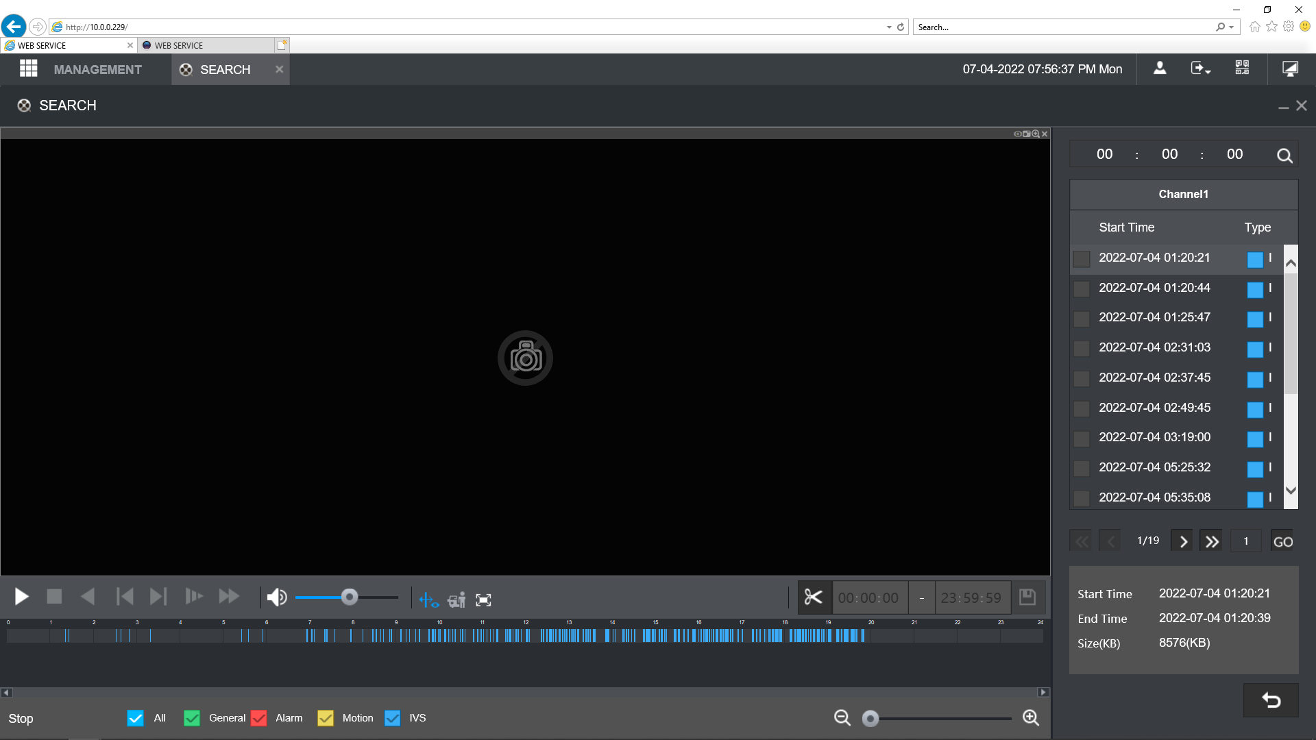

Well Geez there is one I missed. Yeah even some of my other 4.0 FW WebUI and even the NVR's GUI don't have a Cut function.. So I know why I didn't notice because I don't use Chrome or Edge I use IE even today I still use IE and I see in IE that feature is still there like many other Features that has been removed from cameras/DVR/and NVR's..
So looking at the 2 first pictures one is from my AI DVR and the other is from one of my FEW Amcrest NVR's and you can see both look like yours.. However the last picture showing my AI DVR in IE has the function your looking for..
So what you can do for now if nothing else is use the Backup feature from your NVR in the Main Menu. Might not be as useful as the Trim but is an option.. Another thing is using ASP to load and playback and save footage from your NVR if you don't want to use no longer Supported IE.. I still use it and will until it is no longer able to work even though no Updates still works..
Another option if needed is using the IE tab in Chrome or Edge..

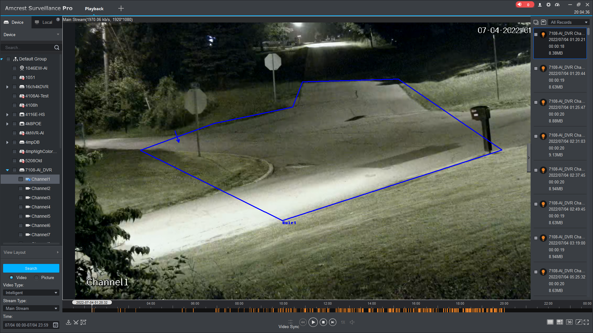

Re: nv5216 Missing download function
Also so you know here is a Picture from ASP. Before footage being shown the cut function isn't lit it isn't until after your playback starts so I have the image from first IVS on my AI DVR.. you can see it can be saved that way as well.. Just showing options...
