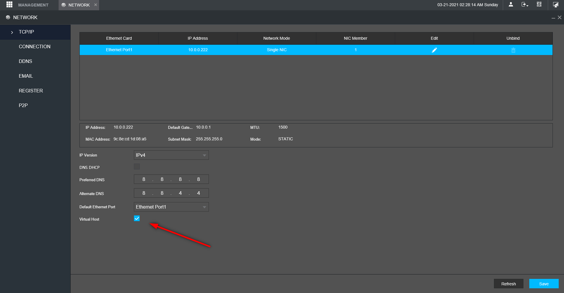

Thoughts if I had to guess there is a box that is not checked in the system or the Ports that should be forwarded are not all forwarded.
Next thing that comes to mind is VH is off in the NVR if it has it in settings? Oddly my main NVR is a 2116-HS and when I seen a VH I was kind of taken back because none of my cameras are behind the NVR.. So I am guessing if mine has it yours being what it is and cost over mine has to have it as well and must be something to do with when using port forwarding... I use P2P and Smart PSS to access my NVR outside my network so I can't tell you just some guesses..

Hmm. My NVR doesn't have a virtual host setting/checkbox

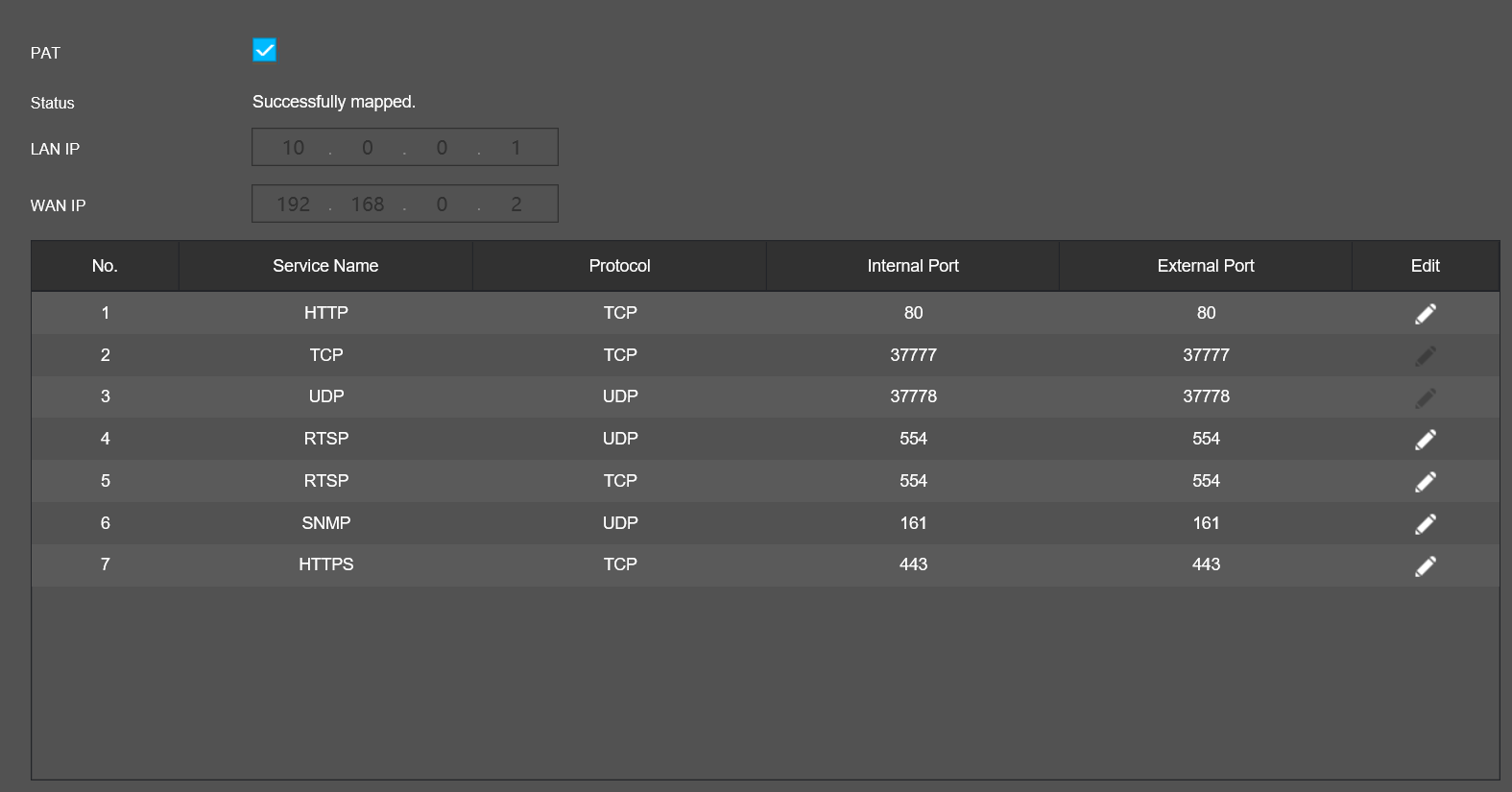

In my firewall rules, I am forwarding (for example) external port 4000, which will resolve to internal port 80. All NVR port settings are set to defaults. So i just have to type my DDNS address with the port, and I can access the cameras. as a completely fake example, http://myddnsaddress.ddns.net:4000 would get me access to the NVR on the iOS app and the desktop app, and I can see the cameras. But not directly via the web UI. That would only load the GUI, but all cameras spin.
Unsure if anything more than one port is needed to be forwarded. I tried forwarding a different port to 37777, and that didn't work.

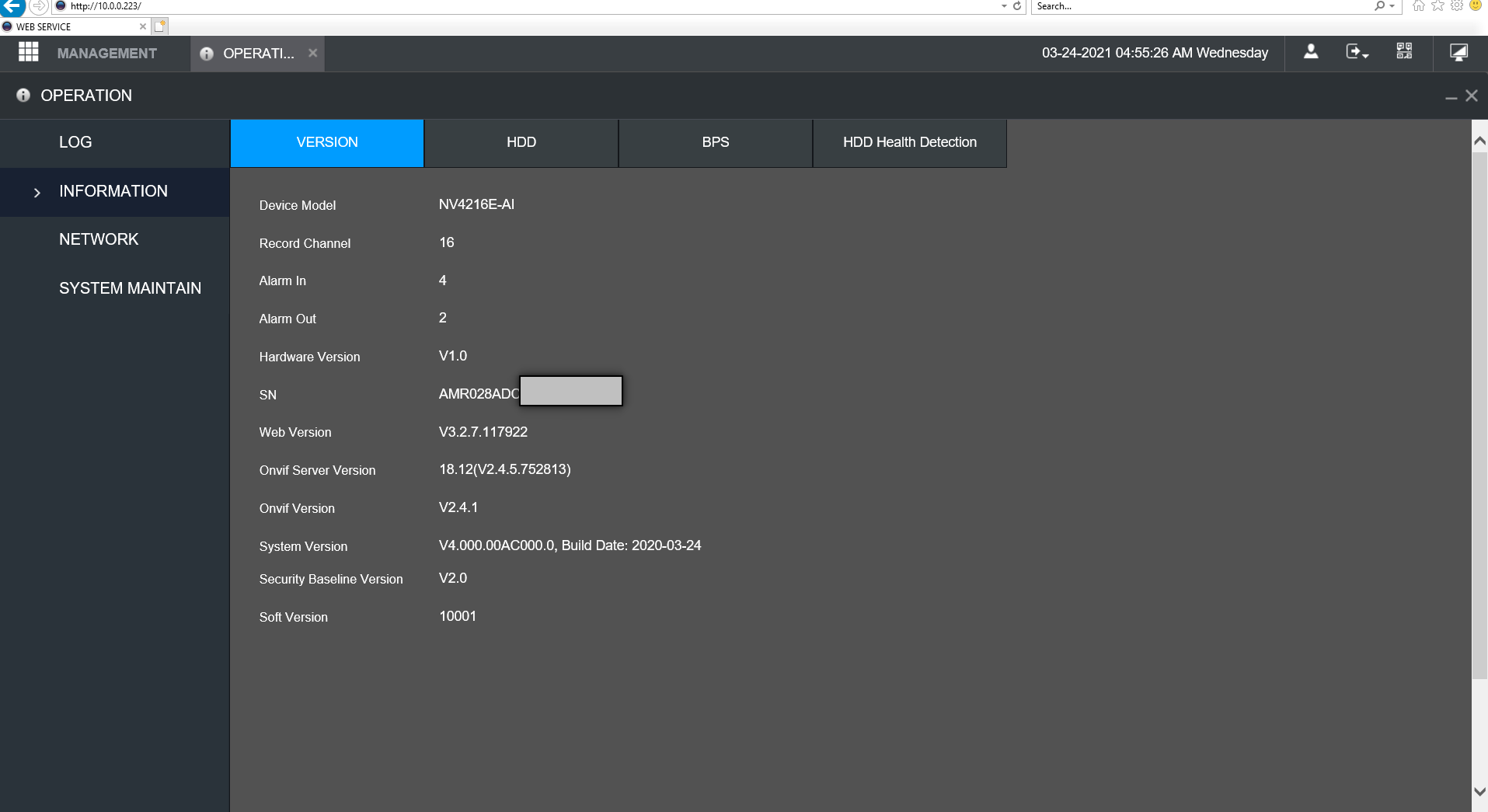

Just got my 4216E-AI today did you get it working? Yours the POE or normal nvr?

I will turn off P2P and try to get my DDNS setup again. I still have my name and Ip so shouldn't be to hard to turn back on it just has been years since I have messed with this so might take me some time... Looking at your system info is it same or close to mine? Like your question it might not matter I am only asking to have a better understanding of the issue in hand.. Like If it works for me and don't for you and your on non POE yet I am on POE it might be just that difference.. Just trying to be helpful..

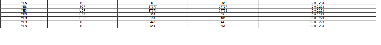

However I have a complex network that I am dealing with, While My info and ports are working and my outside DDNS is setup and my IP is still there as it hasn't changed for over 4 years I am thinking I need to go down a couple of routers and unlock the DMZ to my second router to open as things are showing and my dns server that I use shows the right address for my NVR no access atm.. Need to dig a little deeper still..
Re: NV4216 no camera feeds ONLY on web UI
doing a trace on my network DNS from an outside server I do get an A Record back with my IP address so that is working...
