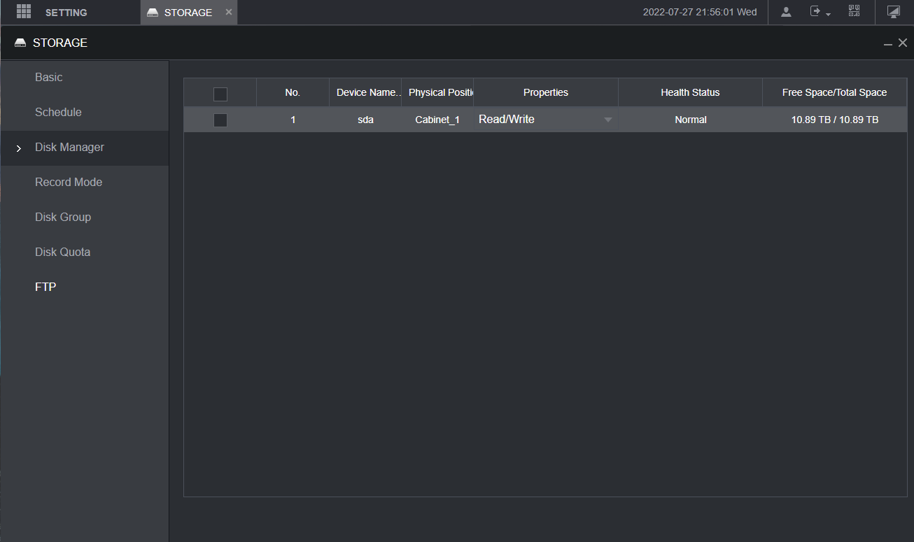

I tried the 5.1 firmware from 7-13-2021. It killed motion detection on all my ONVIF cams. For that reason, I prefer the 3-19-2020 FW. I've installed a 12TB HDD tonight. It was physically shorter than the 4TB that it replaced. Full capacity detected.
