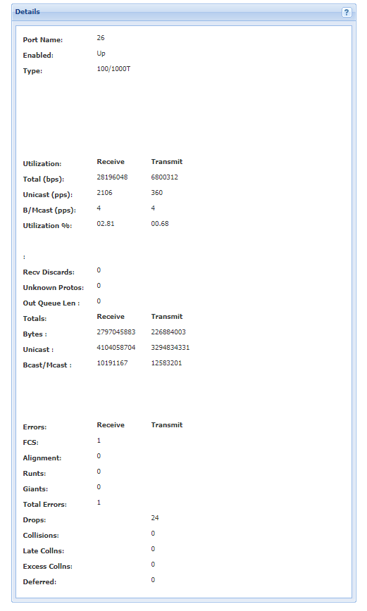

However there is 1 thing I guess it might be as well... What does your Connection between the 2 switch state it is? 10 or 100 or 1000? Is it MID or MIDX? looking at the port data for the used port it is showing any errors or maybe any request for timeouts? Can you take a screen shot of your Port data? and post here?
This is picture of my HP going to my Cisco giga lan
