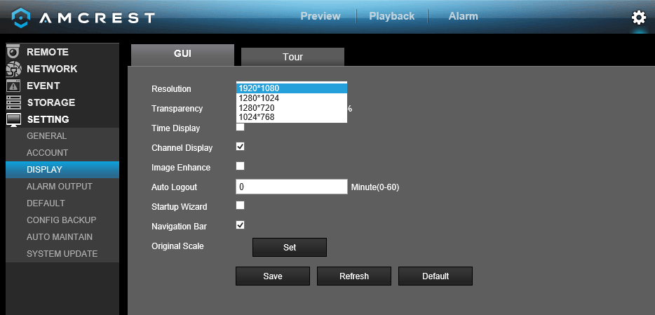

Once you get to the log in of the NVR you can then click on the Setup/Config area Display, then you would want to change your display to 1280x720 or 1280x1024 is the normal setting.. Then it should pop up on your NVR's Monitor as being able to be displayed after clicking apply/save...
Re: NV4108E Invalid Format on Display
This is from my 4108E Right click open in new tab for full view
Screenshot (378).png (51.13 KiB) Viewed 1393 times
