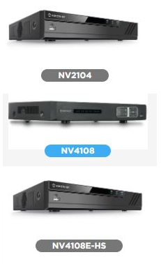

Revo2Maxx,
All my cameras are IP4M-1026EW-28mm with firmware 2.420.AC01.3.R, Build Date: 2018-02-06. These cameras don't have snapshot capability. If connected to direct to the internet, they can send an e-mail but will not have a snapshot attachment.
I have three Amcrest NVRs.
NV2104 (non-PoE, non-HS) firmware V3.200.AC00.0.R, Build Date: 2017-05-16
This NVR and firmware will send an email with snapshot attachment when motion is detected.
Note: The snapshot is captured by the NVR approx 3-5 seconds after the motion event occurs.
Note2: The NV4108 came with firmware V3.200.AC00.0, Build Date 2016-04-26. This firmware will send an e-mail but will NOT attach a snapshot.
NV4108 (non-PoE, non-HS) firmware V3.200.AC00.0.T, Build Date: 2018-02-06
NV4108E-HS (PoE) firmware V4.000.AC000, Build Date: 2020-05-21
This NVR and firmware will send an e-mail but will NOT attach a snapshot.
I have Amcrest View Pro (Andriod) V4.2.015, Build Date 20201204.
All three NVRs will send a notification to the AVP app. You can open the notification and view the one minute video but there are no snapshot shown on the picture tab.
