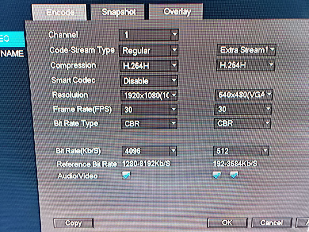

Hello.. So I am not sure but I am going to guess that you will want to go to the camera that you are trying to set your mic on.. Say CH2.. Go to the Encoding Page there will be a option down at the bottom of both Main and Sub stream to record Audio/Video make sure the Check box is Checked... Once that is done Restart the NVR going to Shutdown Reboot.. Your not trying to reset your only looking to reboot the NVR like turning off and back on if you will...

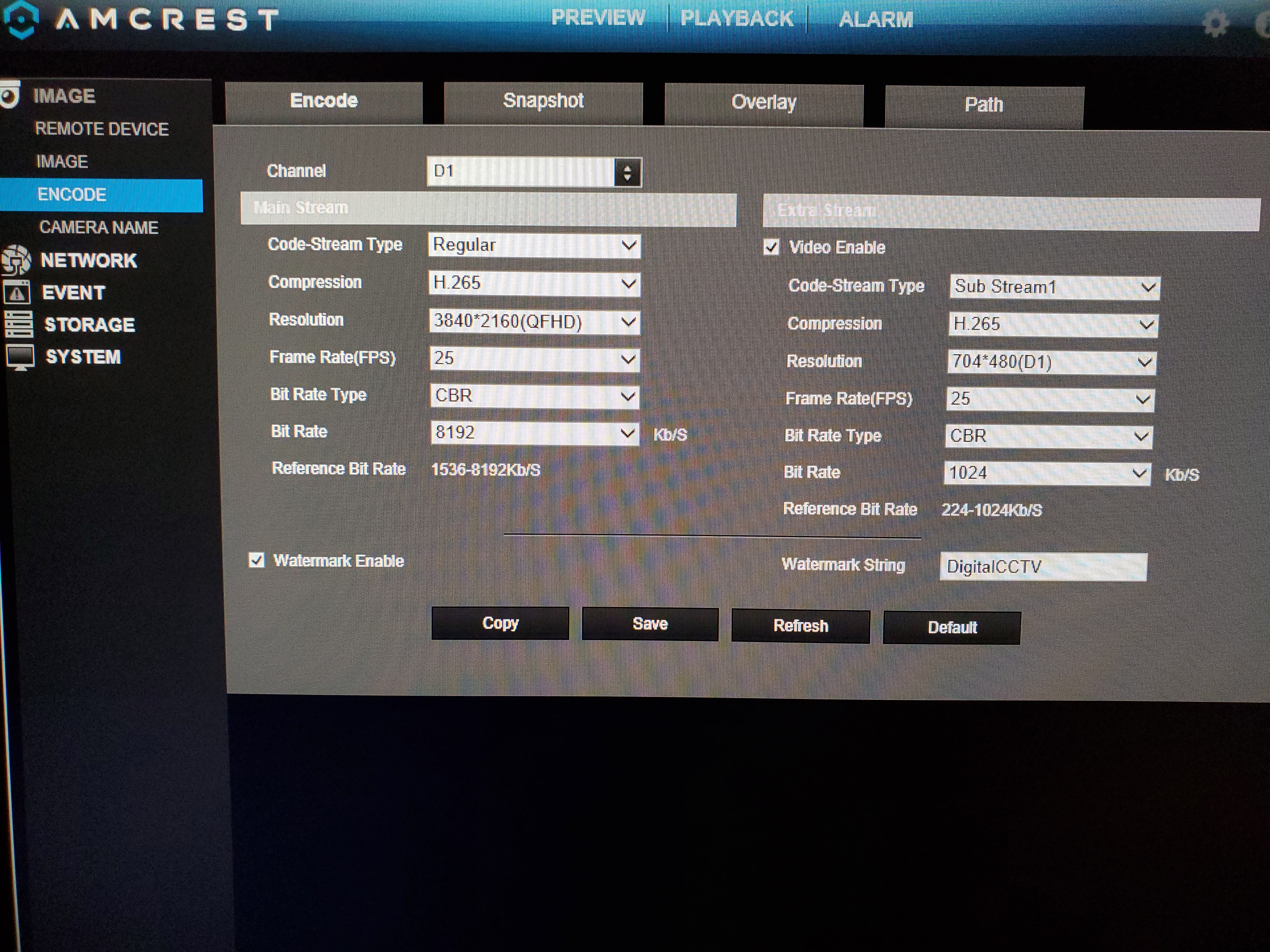

HiYa Revo2Maxx,
During the original setup, I did see the Audio/Video check boxes as you mention/show. But, after the installation of the cameras, they disappeared. See attached...
I assumed, those setting were for the specific cameras on the channel and since my cameras were not audio capable, they simply didn't show as an option.

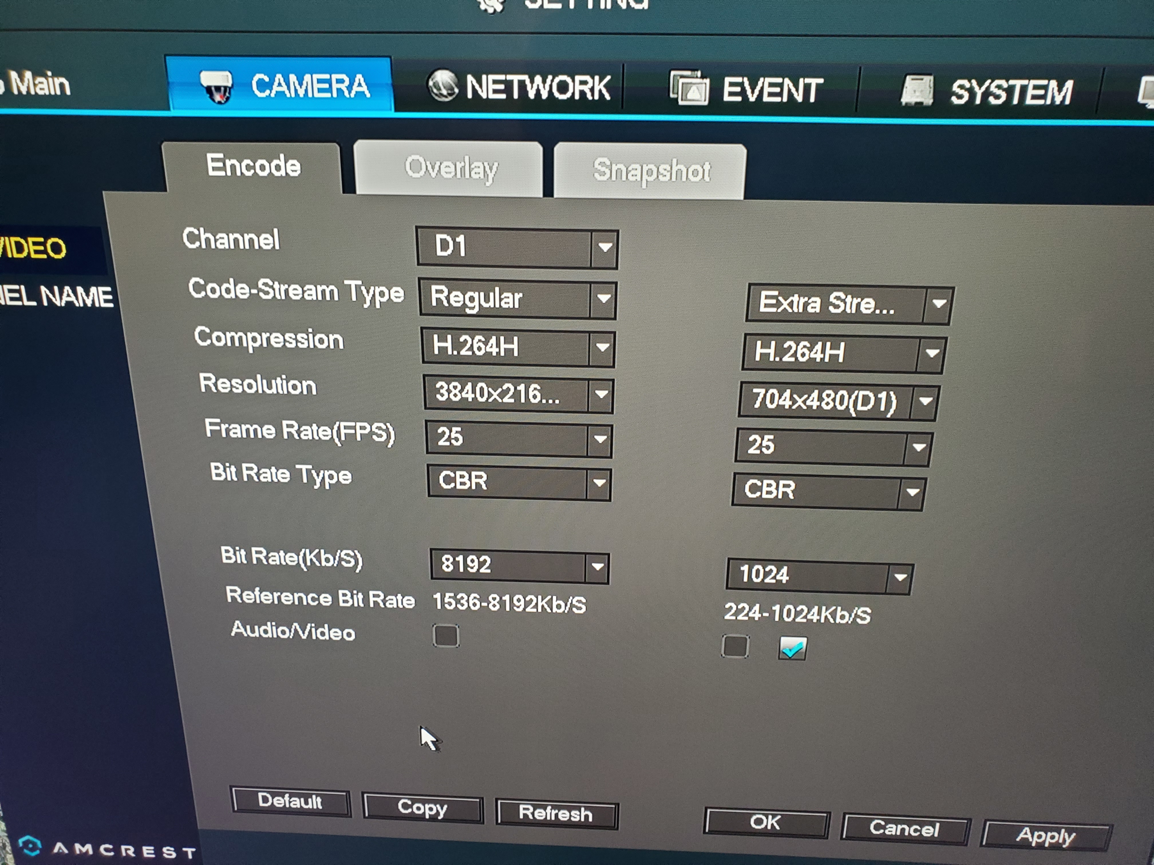

HiYa Revo2Maxx,
Apparently, the Web UI displays a different set of controls then the actual NVR. When using the actual NVR, I do get the audio check boxes, but they will not populate. See attached...
