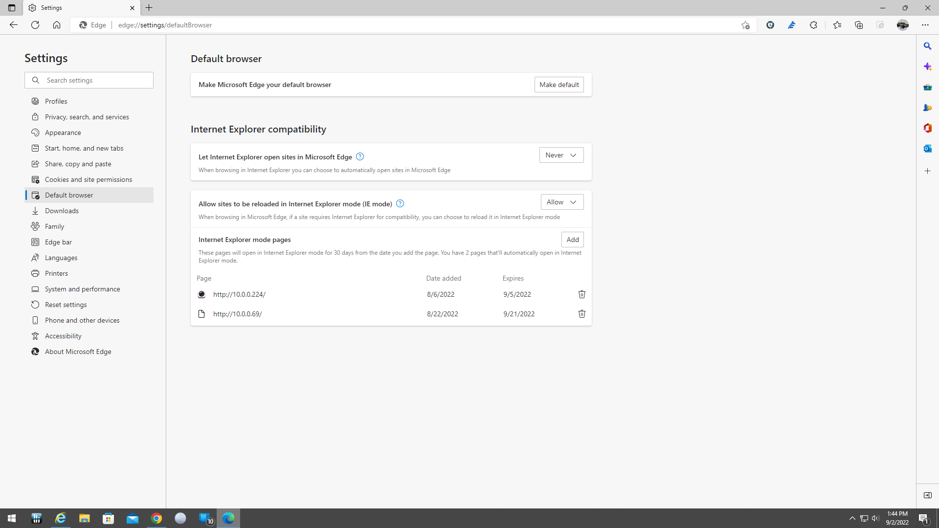

However using Edge, setup your IP to work in IE mode. IE mode in Edge is said to be supported to at least 2029 so that will give you and me a few more years in our older 4108E NVR's I personally feel that is one of the better NVR's that I own as it don't have some of the Flaws of the newer FW systems..
Also you could use ASP as a way to better view your system as well. It works with little effort
If you want to use Edge, Open Edge, then top right press the 3 dots, Then settings, then Default Browser button, Then in that screen is an area where you can enter the ip address of your NVR and now when you put in that IP address it will open your NVR WebUI in IE format in Edge. Note This will need to be done every 30 days just saying

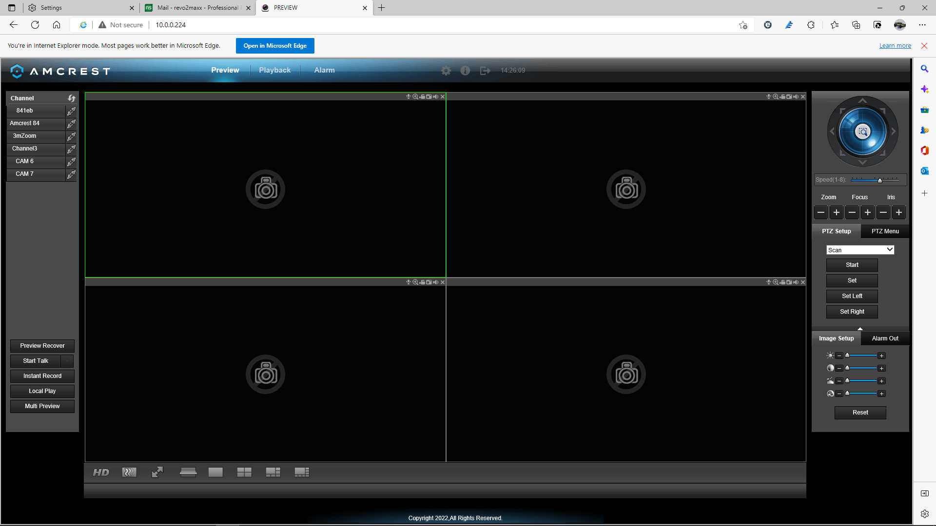

So I thought I would show you what I was talking about.
This NVR only has a few cameras think 7 but isn't my main NVR just one of the many I use..

Thank you Revo2Maxx! I got it open in IE mode. Glad I can get a few more years out of this NVR since it still works great. Just need to get one new camera since the night vision LEDs don't work anymore on one of them.
Thanks again!!!
Thanks again!!!

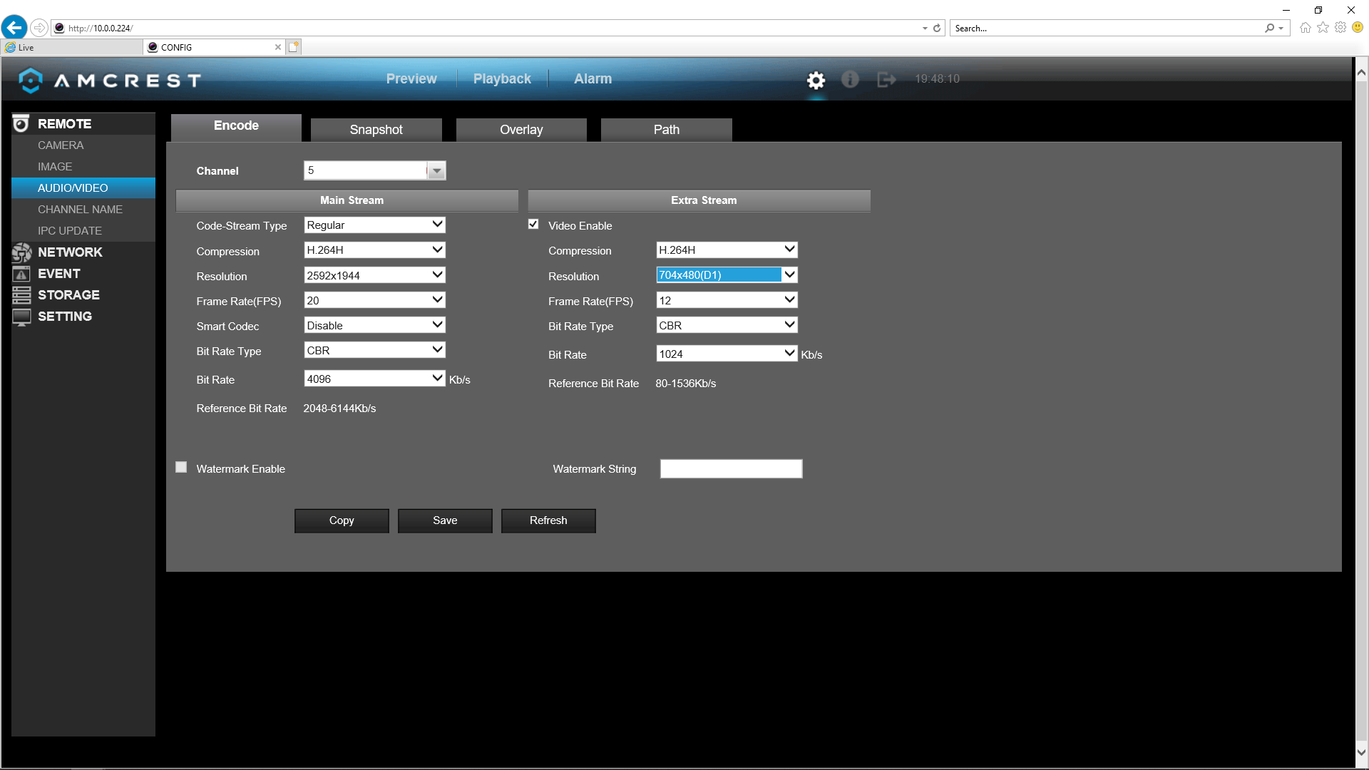

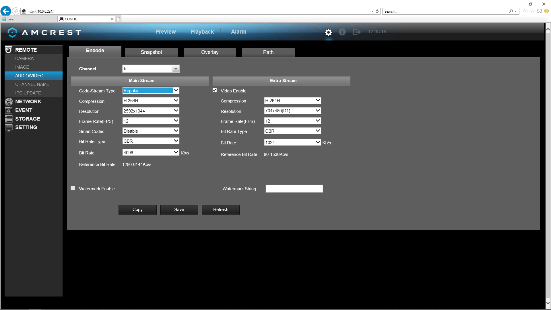

To be honest I am not sure they will work. Looking at my Box and you can look at yours if you still have it after all these years. Anyway on the Box yes it says that it supports 5mp however if you look at the Side it says the 5mp is 2560X1920 and the cameras looks like they are 2592x1944 and that could be outside the scope of the NVR's ability to Encode it. I personally don't have them cameras so I can't say for sure.
However after saying all that, I did just turn one of my 5mp cameras back to 5mp at first I thought it wasn't going to work when I noticed it was setup for h.265. So I changed it to H.264h and sure enough my 5mp Cameras that I can run at 2mp, 3mp 4mp and 5mp when I turn on 5mp 20fps in my cameras OSD, I was able to load it and it works great in my 4108E. This is the machine with older looking front. With the Buttons on the front not the slick black front with Slots that one with Slots is 8mp so 5mp works no problem the one I am talking about is the older 5mp 4108E... My camera encoding does say 2592.1944 see picture below. Also be it known while the camera of mine is limited to 20fps in my camera the NVR is only offering 12fps. SO I am sure it could be the same for the cameras. They might offer 30fps but NVR seems limited in my cameras anyway to 12fps.. However I will have to look at it again after I move a 5mp camera to my 7108-AI DVR, Seeing the one I have it connected to is my 8m16-H5 and while it is also 8mp able the 5mp camera might only be able to Encode in that DVR at 12fps and might be while it is limited in my 4108E.. Yes I am using a DVR as a camera in my 4108E.. I do that all the time between my platforms.
Re: NV4108E Dahua Firmware?
Ok so I did change the Camera to my 7108-AI DVR from my Amcrest 8m16-H5 and sure enough the 5mp 20fps is able to run in my 4108E NVR after making that change. I changed the IP to my 7108-AI also on CH3 as it was on my older DVR. I changed to 20fps and when I made that change to reflect the new IP from 219 to 229 for the other DVR I was able to change Main stream 20 fps see picture below.. Also something to note, The 4108E says it can work in H265 however when I set it as that in either of my DVR's the NVR don't like that format so It does work without issue in H.264H so I would make sure not to run your new IP cameras in H.265 if that is how they default or there might be an issue..
