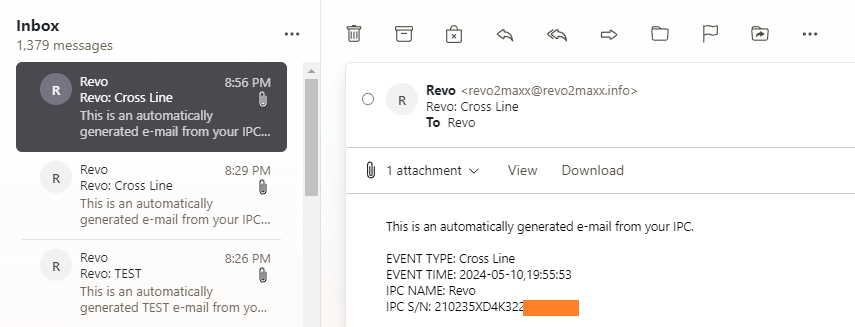

Re: NV4108E-A2 - Email test fail issue
This is sent from one of my other AI cameras, I did a test because I did have it disabled on this camera because where I had it installed I was getting so many alerts that I didn't want push and emails. While this is a different brand my Amcrest devices are also setup if I enable them to send. I know they work, I wasn't sure this one still was after the last update. It still does..
I am glad I looked because I just noticed this camera is plagued with the DST issue. After the update in time I had to turn all off, Just a few days ago I had to turn them all back on. Didn't know this one needed it as well. Can't remember everything. I have to many cameras to keep up some times lol.. Fixed now that I seen this
