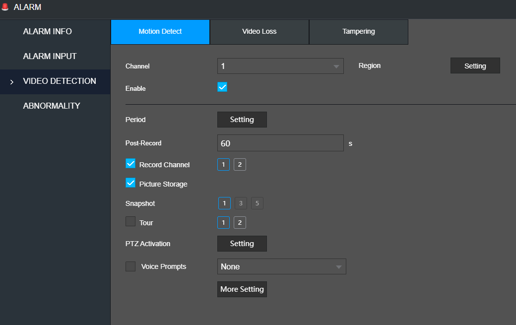

My NV2108-HS NVR is sending email notifications when it detects motion, but the emails do not include pictures of the motion.
The only setting difference I can find from all the tutorials and manuals is that there's supposed to be a checkbox next to the Snapshot option under the Motion Detection area that has to be selected to enable pictures in emails. In the NV2108-HS user interface there is no checkbox next to "Snapshot", just a [1],[3],[5] clickable setting (pic attached). I've not been able to determine what the 1/3/5 option does, and it's not described in any manual/post/video that I can find. Selecting any of the three options doesn't seem to change what's sent in the email notification.
Any help is appreciated! This is the last bit of configuration that will get my NVR up to par with my previous non-Amcrest setup that sent me pictures of the motion along with the emails.

- AmcrestSnapshot.PNG (23.63 KiB) Viewed 1146 times

Thanks for the reply! I am running the latest firmware (V4.000.AC000 5/22/20) which is what it came with. The interface does have differences even from what's in the manual, which has been a struggle. But most things are close enough to get by. The email+snapshot area is one of those that differ from all public documentation, and unfortunately one that I can't get to work.

@someuser2020 Were you able to resolve this issue?
I upgraded my NV4108E-HS to this same firmware, and now I am seeing the same issue.
