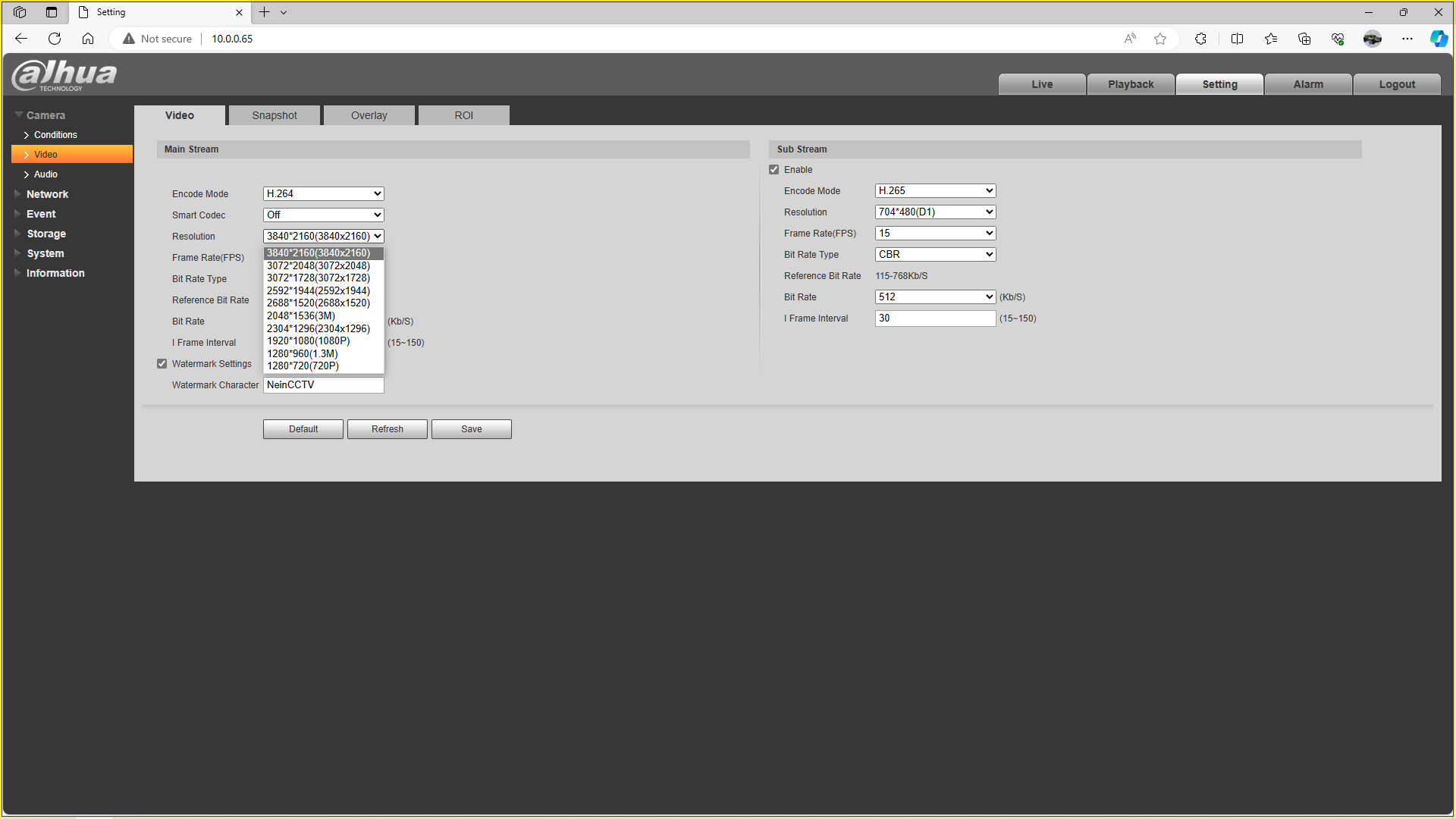

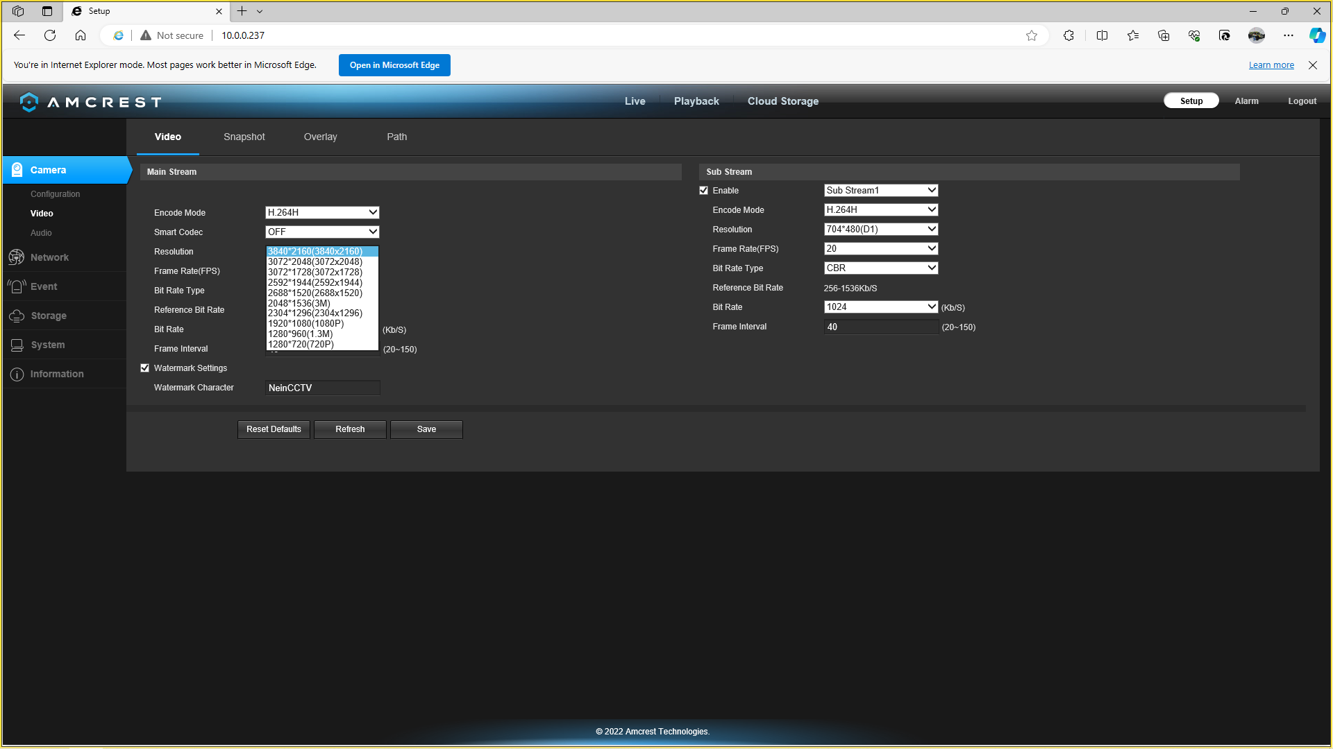

So I didn't look over all my 8mp cameras that I have going on. However the first 2 that I did check in fact will work at 720P. One from Amcrest and one from Dahua. Looking at the pictures you will notice that the Amcrest camera is working in the IE tab mode and the Dahua isn't that is because the Dahua has updated the FW in current cameras to work with the rules in Chrome and Edge so I don't use that one in IE tab. Where the FW that is on the Amcrest camera so far for my cameras anyway don't work all camera options that will work in IE and seeing IE is no longer a thing I use the IE tab in Edge so I can get all options offered in the cameras. Even in some of the Dahua cameras with current FW still says features offered best in IE mode..
Anyway I personally wouldn't pay the price for a 4k camera to scale it down to 720p to work with the 1104 NVR unless it was the only option I have until I can get a 4k NVR. I do have some shelf Queen recorders that I can use as backup for one of my Current in use line of Recorders that might go offline and need replacement.
