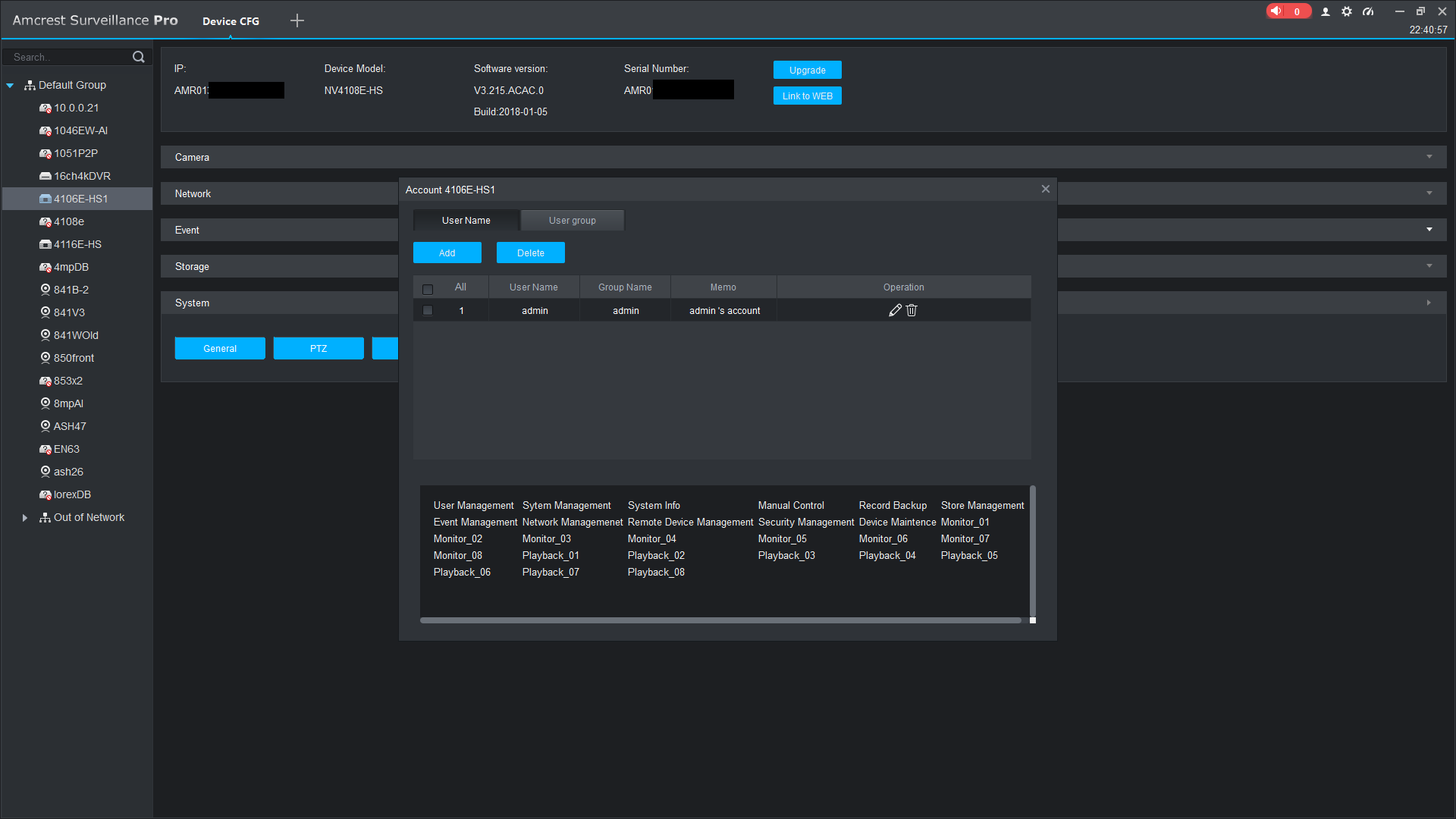

So you could use ASP Picture below is what it would look like to setup a different user for your device..

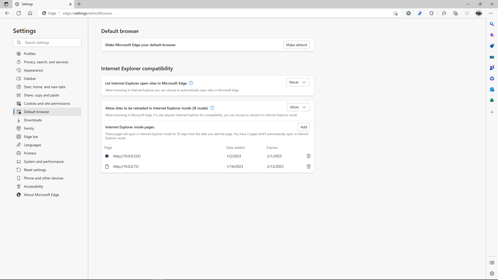

Another thing you could try if you didn't want to put ASP on your computer. You could try using IE mode in Edge.
Top right area click the 3 dots, Then bottom click settings, then left side Default Browser, then in the bottom area is where you can add in IP's for your system to work in IE mode. This is said to be supported until 2029 so there is a good amount of time still for using IE type devices...
Also note as you can see in the picture for Edge, YOu have to update once a month to keep using the IE mode.. Not update the Browser just the IP so it knows you are still actively using the IP in Edge IE Mode..

Hey thanks for this I tried edge in IE mode the other night before i submitted this and couldn't get it to work but it worked today after adding the NVR IP address in hte section you stated above! Thanks appreciate it!
