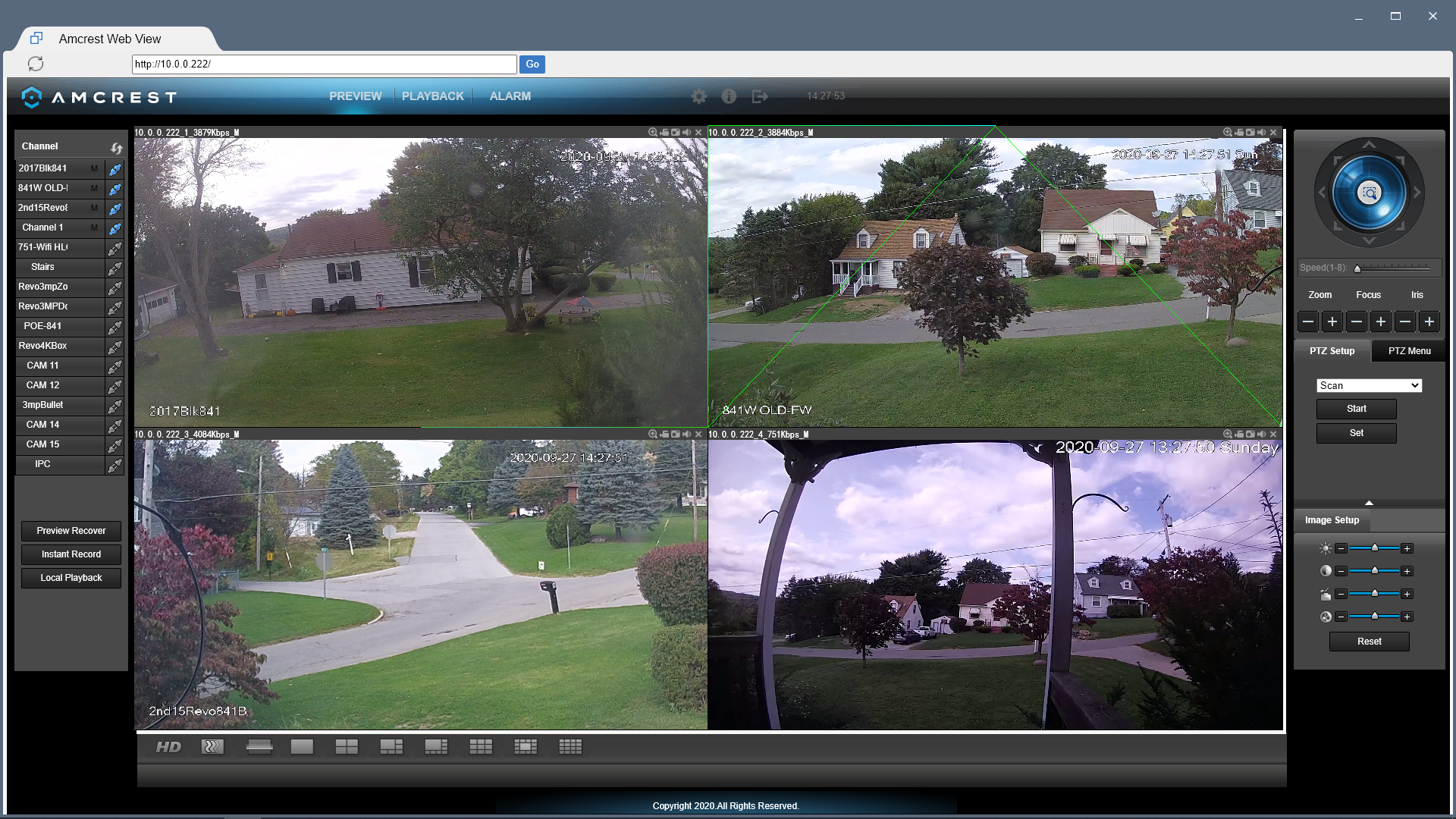

Here is a Picture of what the Amcrest App for Chrome looks like with my 2116-HS with 4 of my cameras you can see any combo for the picture and keep down on space I only did 4 seeing the screen shot from having 16 open was to large in file size.. This also shows the Green line though the channel you are currently clicked on that I don't really like but is workable
Screenshot (7).png (2.29 MiB) Viewed 2391 times

@Revo2Maxx Yeah, the screenshot of the Chrome extension looks like the IE extension. I'm ok with the IE version, but It won't work with Edge -- keeps asking for the plug-in. Old IE is the only browser that works for me, and I'm not crazy about having to use outdated apps. And if I try the Chrome version, it also asks for the plug-in, and if downloaded and installed, it still asks. Can I (or should I) do a FW update to an older NVR?
