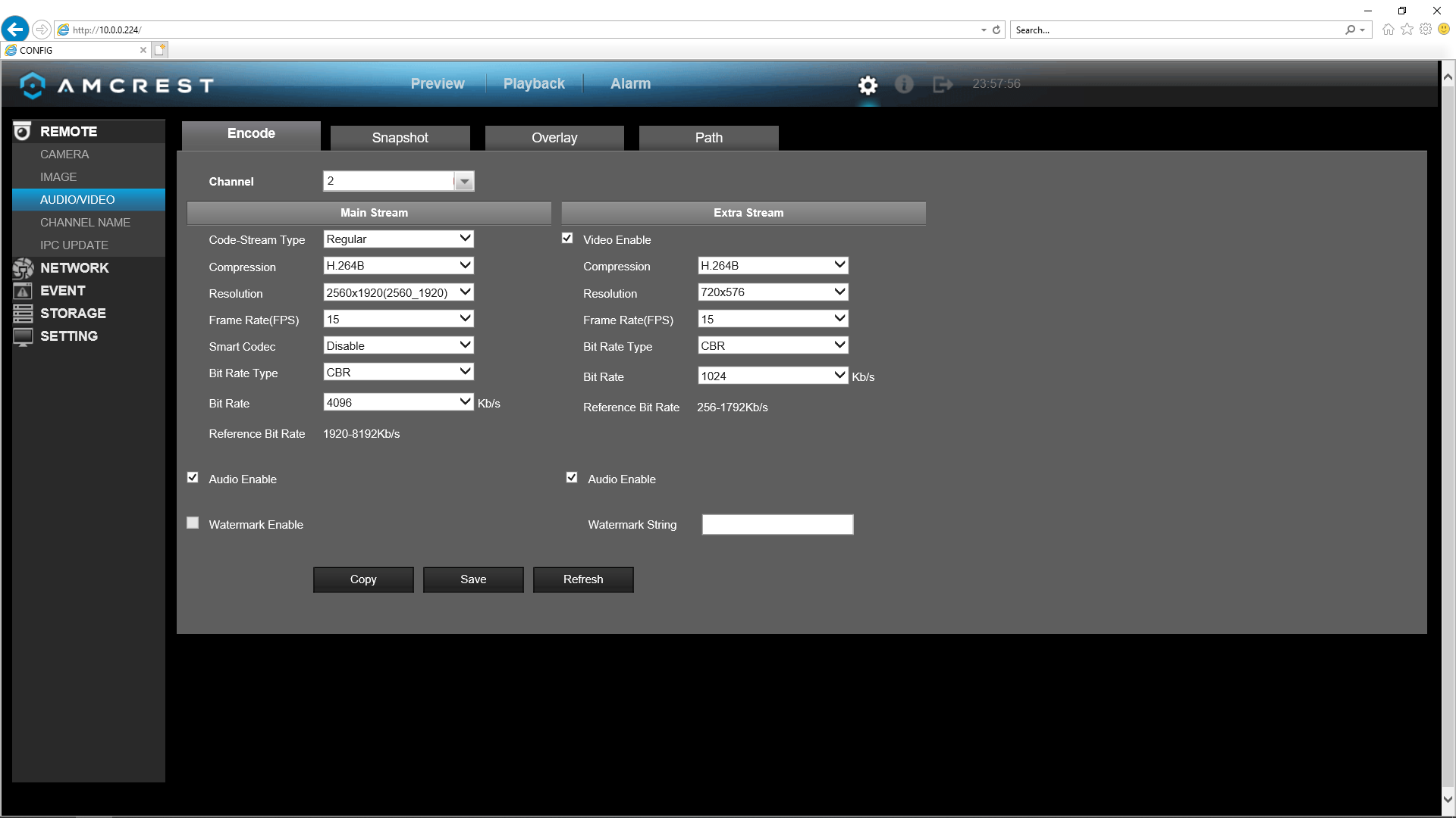

I am going to guess it is one of the last 2. Here is something to try. First I am guessing your talking about Black Screen when your in Grid mode, so using the mouse move to the top of the grid the 43w at the top move that to S1 and it might show up. If that comes up already set to S1 then set it to M.
For a good fix if it is setup already for S1 is to make sure that the S1 is setup for 640x480 as it might be setup for something that isn't in the range of the NVR on the Sub Channel.
My AD410 used to have that issue with my 4116E-HS. That was because the Sub Channel was setup for 720x576 and it don't want to work in Sub channel in the grid in that mode.

Ok don't have your camera but do have the older 4108E as well. I will connect to my AD410 see how it acts.
Still might be encoding issue however it is very stable NVR
Re: No video from camera ASH43W on nvr NV4108E
Ok well I did connect to my camera and it works as expected..
So I understand better. Is the camera on your NVR work at all or is it just offline/locked/or pure black screen.
What I mean is if you run your NVR in single channel mode on the camera does it load? Is it only black screen when in Grid View?
Screenshot (3040).png (158.89 KiB) Viewed 1543 times
As I was thinking about what it might be. I would also look that your Compression is setup for anything other then h.265 if it is setup that way I would try to see if setting it to something in the h.264, h.264h, or like I have mine h.264b and that is older not as good setting but works for my setup. I mean I know h.265 is an option it isn't always a stable one.

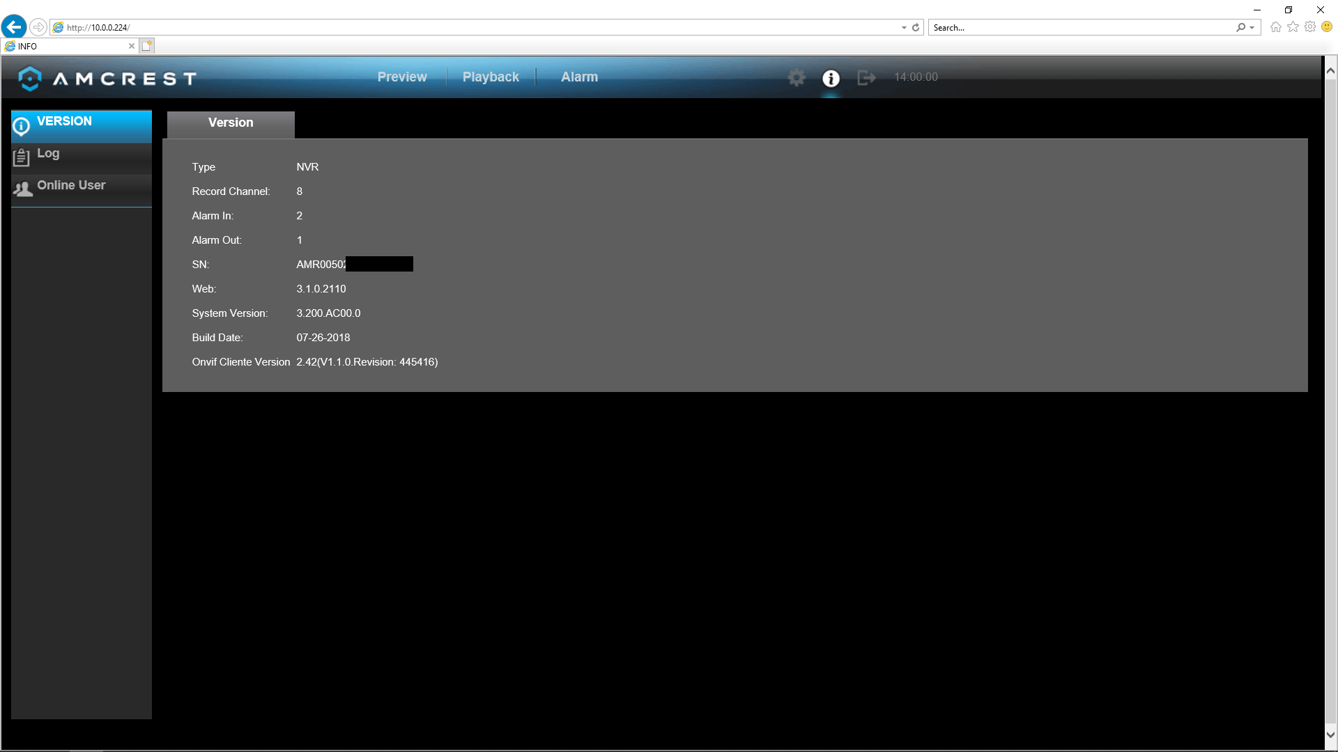

There is a few ways to update the FW.
Fastest way for me anyway is to do it using WebUI of the NVR..
So use IE or Edge with IE Tab. Then click COG (Gear looking icon at top)
Then on the Left click on Setting, System Update, then in there is a Tab to check for new FW. By clicking it you will be taken to the Amcrest FW page. you will want to scroll down until you get to your Device and DL it to your Folder of Choice. Then again where you clicked that button to find you will want to Click Browse, then find the file, then click update.
I might have a non listed FW. I am not sure if it was this NVR or other that had issues with Audio from front side cameras. (Only way I could get audio to work was if it was connected to POE) so my FW might not be what was listed as the last one offered but is in picture below for idea of where to look at what one you have from WebUI...
