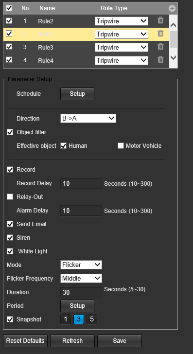

Then once you log in and click the e, log in to the camera, then go to event type you are working with motion, or IVS.. Make sure there is a Snapshot enabled there.. So in the picture below if I was to uncheck the bottom Snapshot for this event then I would get an email but not snapshot if I wanted. So need to make sure on the event type you are working with that snapshot is checked and also should if it has option for number at least one of them checked even though the NVR will only send 1 unless the NVR has the option as most don't and only sends 1.. Also what NVR are you working with? Does it send a start and stop email or just 1 email normally with the image. As I have found some strange things happens at times with my new E1 NVR where it sends the End with the image and not the start.. Seeing I setup my email client to reject the end emails normally there has been a few emails I got as start without the image, But looking in the server logs I can see the image was sent in the end email..
