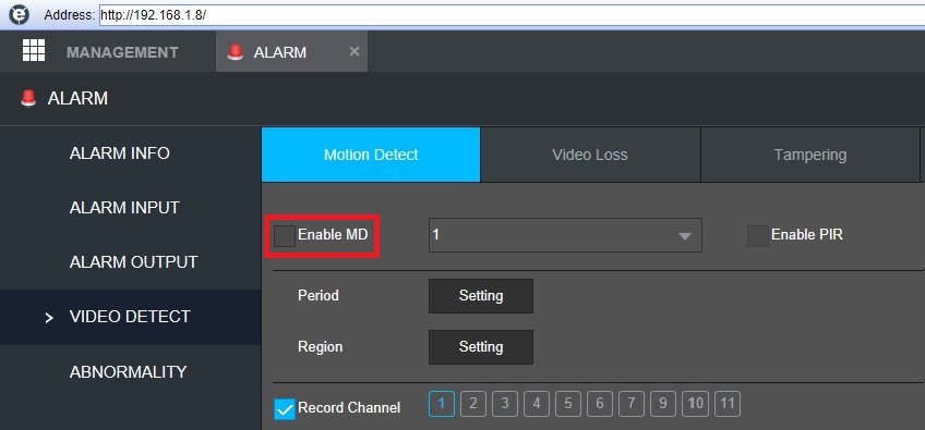

Oops. Never thought there'd be what is essentially an override for the Motion recording schedule tucked away in 'Alarms'. Just a little weird..., almost as weird as it not being active on channel 1 for whatever reason. Probably operator error somewhere along the line, but all three recorders?
Anyway, all fixed. Thanks for the detailed response as usual.
And would someone activate the 'centering' feature, please?
Alarm Settings.jpg (54.98 KiB) Viewed 1968 times
