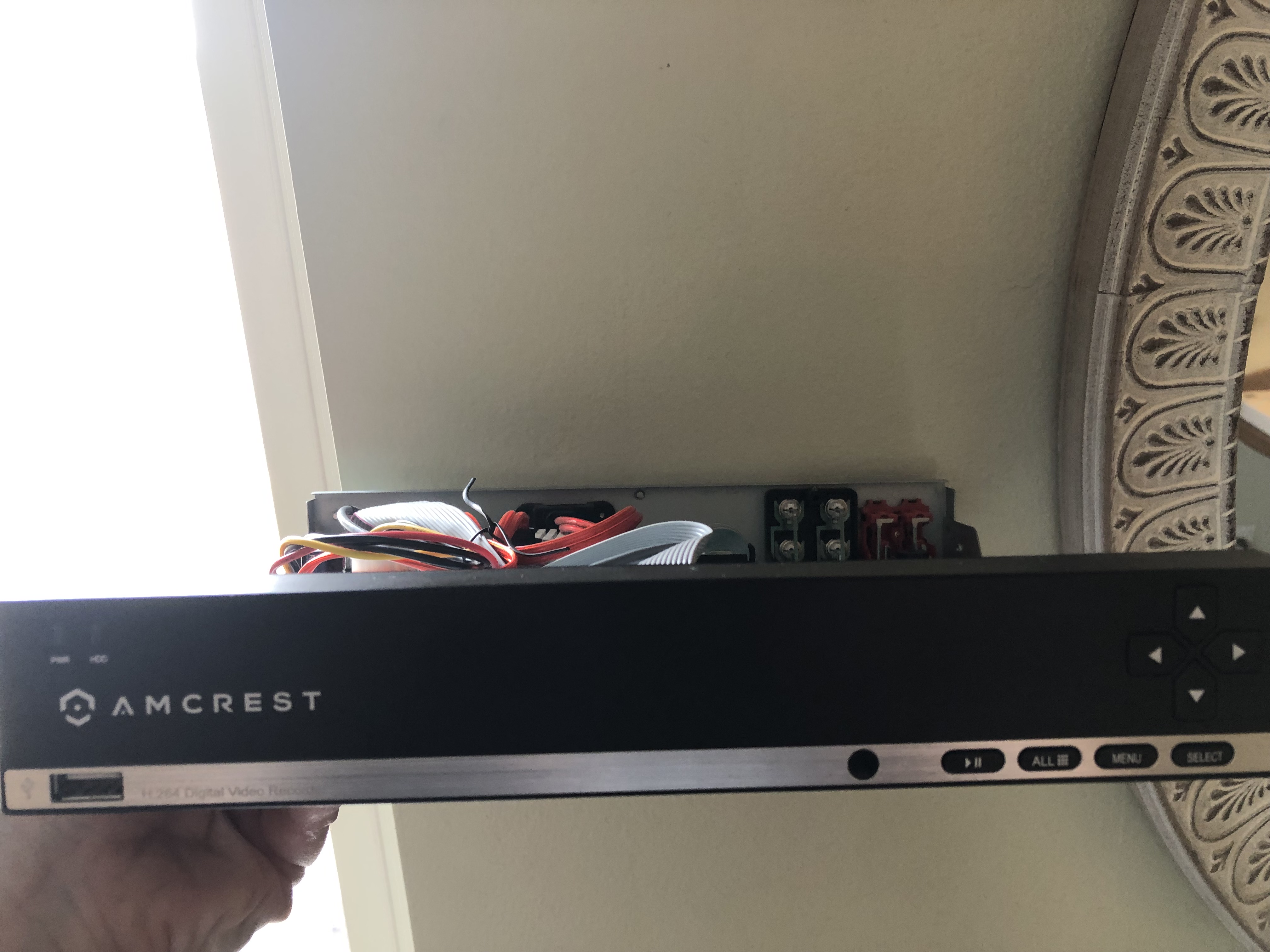

EDIT: Forgot to attach an image in my OP. The DVR says H.264 Digital Video Recorder on the front. Model is AMDV960G4.

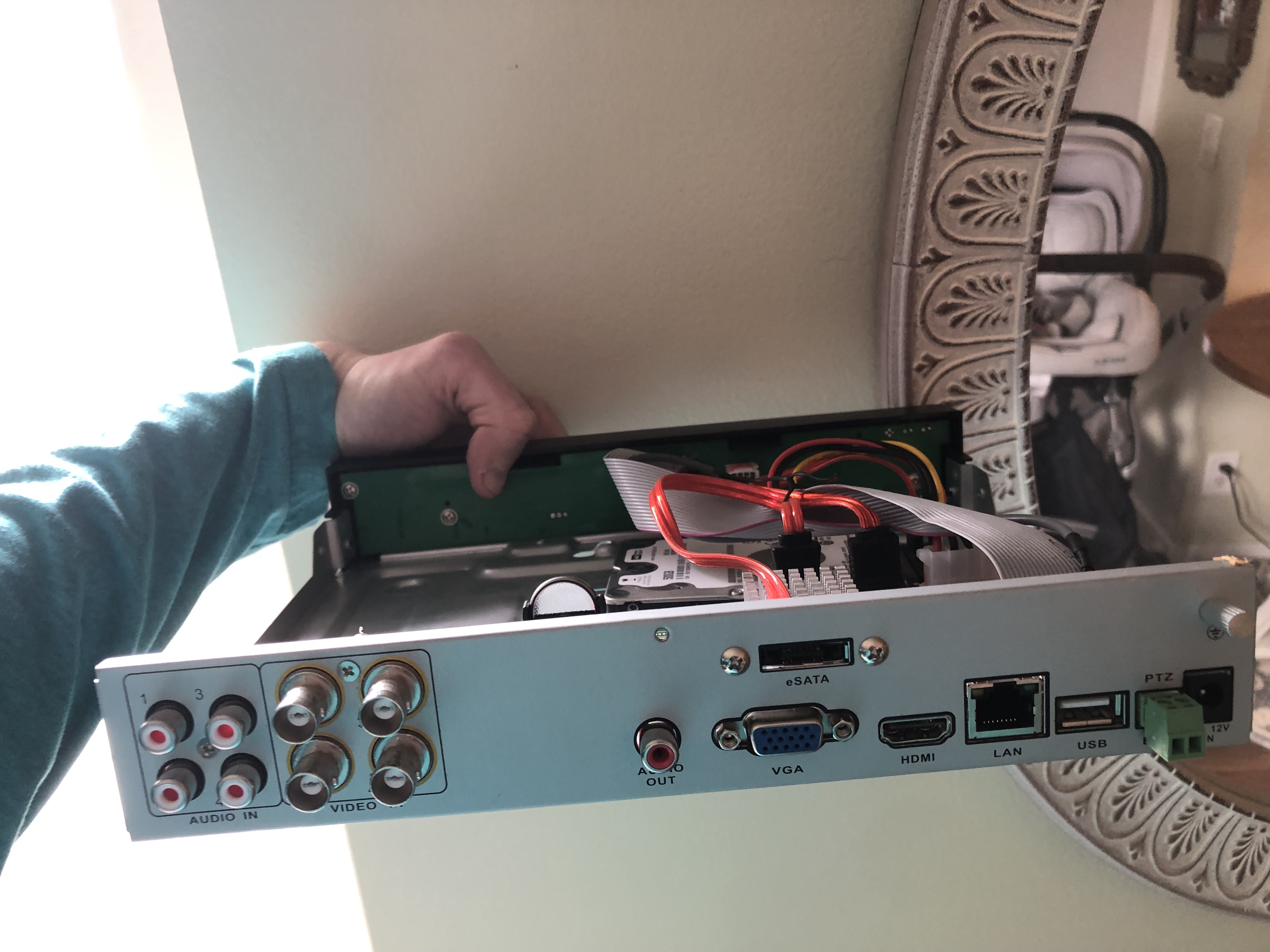

Thanks Revo! Photo of back attached.
Is the VGA port the same as the D-Sub you referred to?
What does that button battery (CR2032) do?
To use the Amcrest IP tool I have to have the DVR accessible on my network for it to be detected, right?
Is there a way to check the operational status of the individual cameras without the DVR? I don’t mind having to replace the DVR, but will be more hesitant if I can’t verify the camera feeds.
Thanks for your guidance so far!
Re: No Ethernet Communication for Setup?
Yes the D-Sub is the VGA port.. So that DVR is a 960H DVR, I have one here at my home as well. So yes if you connect the Lan port to your network Router or a HUB/SWITCH that is connected to your router then you should be able to use your computer Laptop or Desktop with the IP tools to find that DVR. Lets say you are using 192.168.22.x as your normal network IP address. When you use the tool it most likely will find the DVR on a IP address of 192.168.1.108 or 0.108 either way the IP tool can then make a change so the IP address of your DVR is on the right network range so you can use the WebUI. However in most cases, You will not be able to do much until the DVR is setup. This means normally connecting it to a Computer monitor or TV/Monitor via a cable of the right type, and doing the first part of the setup.
Depending on the type of 960H machine that it is. Seeing there were a few different ones offered that DVR has the ability to also work with Ip cameras of 1080P format from Amcrest like the 841 type.. So it is a older nice hardware offered by Amcrest.
That battery you are asking about is only for Clock.. All other data is stored on the SOIC and ROM of the DVR.. If the battery is dead the system clock will not keep time of power is removed.

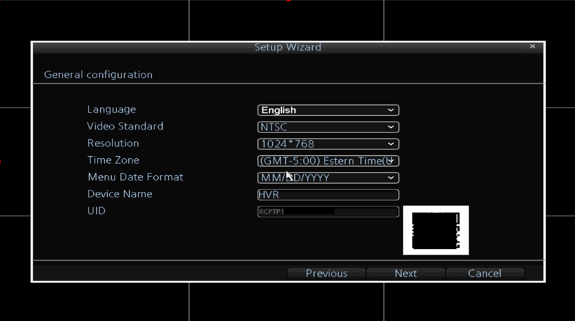

Also thought I should ask, How did you do a System Reset? I ask because on mine anyway just pressing the button and hearing the clicking and then the beep is not doing a factory reset. Then just so I am clear when the system resets it goes to a very strange lower resolution setup. most monitors should be able to run it.
I did a Factory Reset of mine and oddly doing both one from Software, and then one from the Button gave results that are strange and different. You see I have mine setup for Digital. Mine I have had setup at 1 time for 4 + 4, however I changed it to purely 8 digital after each reset the system stays on 8ch digital and I find that strange to be honest. Anyway here is the display after doing a Button Reset and what the display comes up as. This is from the DVRs GUI.. I only coved my qr code and my SN. I don't run this DVR with a password turned on. So don't need any one playing in my DVR lol...
Screenshot (1516).png (136.6 KiB) Viewed 2233 times
