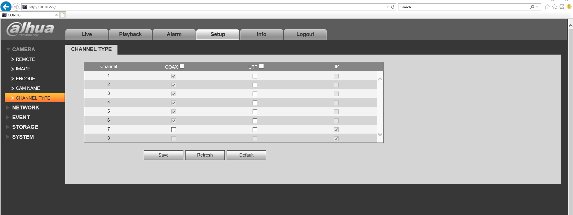

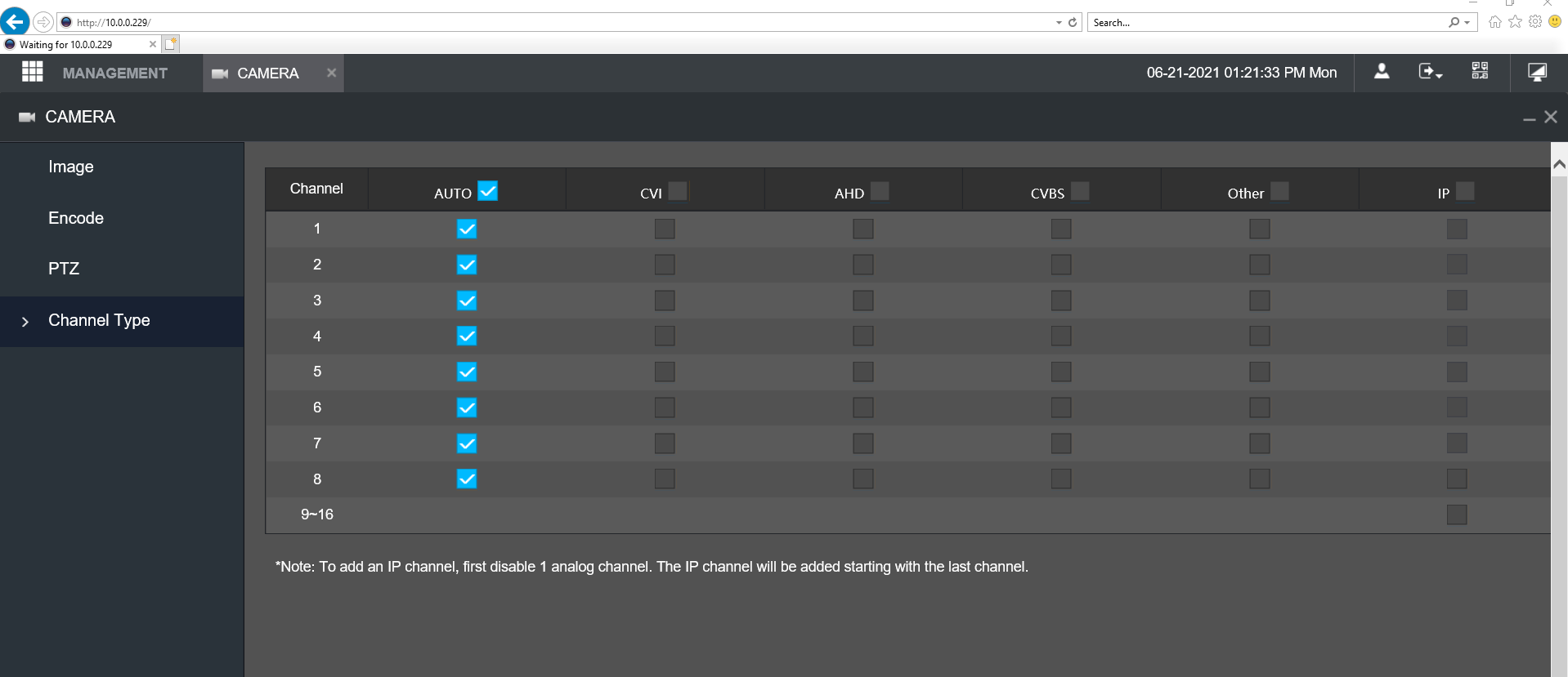

POE Camera if your camera has a Power Plug as well look at the data sheet for it and find out what power it needs. If there is no extra power plug you will need a POE Switch or POE Injector.. This will be connected to your network on one side and the camera on the other... The DVR will also connect to your network as it normally would, then you would do as I said in my text above with your DVR...
However if your DVR isn't really a Dahua 16ch with IP ability then you would need a different Recorder and might as well just buy a POE NVR... However if your DVR is it would look like one of these 2 pictures.. Top one is of an OLD Dahua 8ch with IP turned on ch8 and 7 the second picture is a Amcrest AI DVR with IP off but has the ability to have 9-16ch IP if I didn't want the AI.. Also if I turn on IP I could have it setup with 16ch IP only...
Showing these 2 and I have more however others just look like these,, Again top one older so showing with Older FW and bottom Amcrest one is newer with the 4.0FW look...
