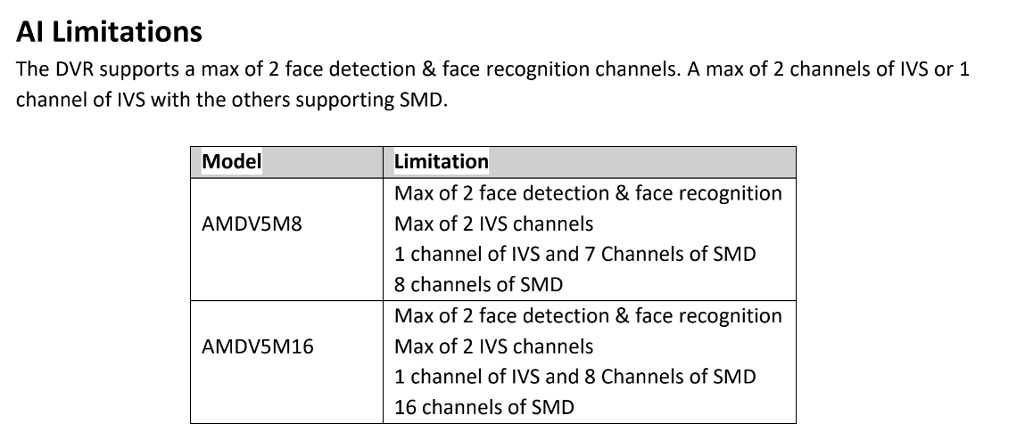

So I don't know when it was released but is new to me. There now seems to be a 5mp AI DVR that cost way less then the 8mp AI DVR I bought. So if you are looking to upgrade your older 720 or 960h system and or even the 1080P system to a AI there is a 5MP option now.
I paid also 300 for my 7108-AI last year without a HDD.
Now they have for just over 100 a 5mp option. Geez.. AMDV5M8 for 114.99 USD..
It also has the RS485 for the people like me that still use CVBS PTZ cameras in the lineup..

If and when someone gets one of these I would love to see what the base features are for the device before I buy one..
I have an older 8mp 16ch DVR with 1 Channel Face on Ch1, SMD, and IVS. The Newer one that I bought in 2021 the 7108-AI has 2 Face Channels I will admit that the older one don't have all the features that the 7108 has and I did a test of the Face Detection on both devices and the 7108 Won by a land slide. Put in a busy scene with 2 5mp cameras that I changed to run in 1080P. I had them both aimed in the same area of view and after 2 hours the 7108 had over 1500 images and my older Dahua had only 822.. Now the older one don't give any info about the people where the 7108 does like Gender, Age, Glasses, Beard, How the person looks, (Happy, sad, confused and the such) The old one just takes a snap shot with no data..
So I am looking to find out if the 5m8 is like the 7108 in the way it detects people and does all that type of stuff. I mean it is less the 1/2 the price of my 7108 and if it does the same I can live with a 5mp AI DVR. Personally wish I would have bought it over my 7108-AI unless it don't have all the features that the 7108 does then I can live with the DVR even if I never put a 8mp camera on it..

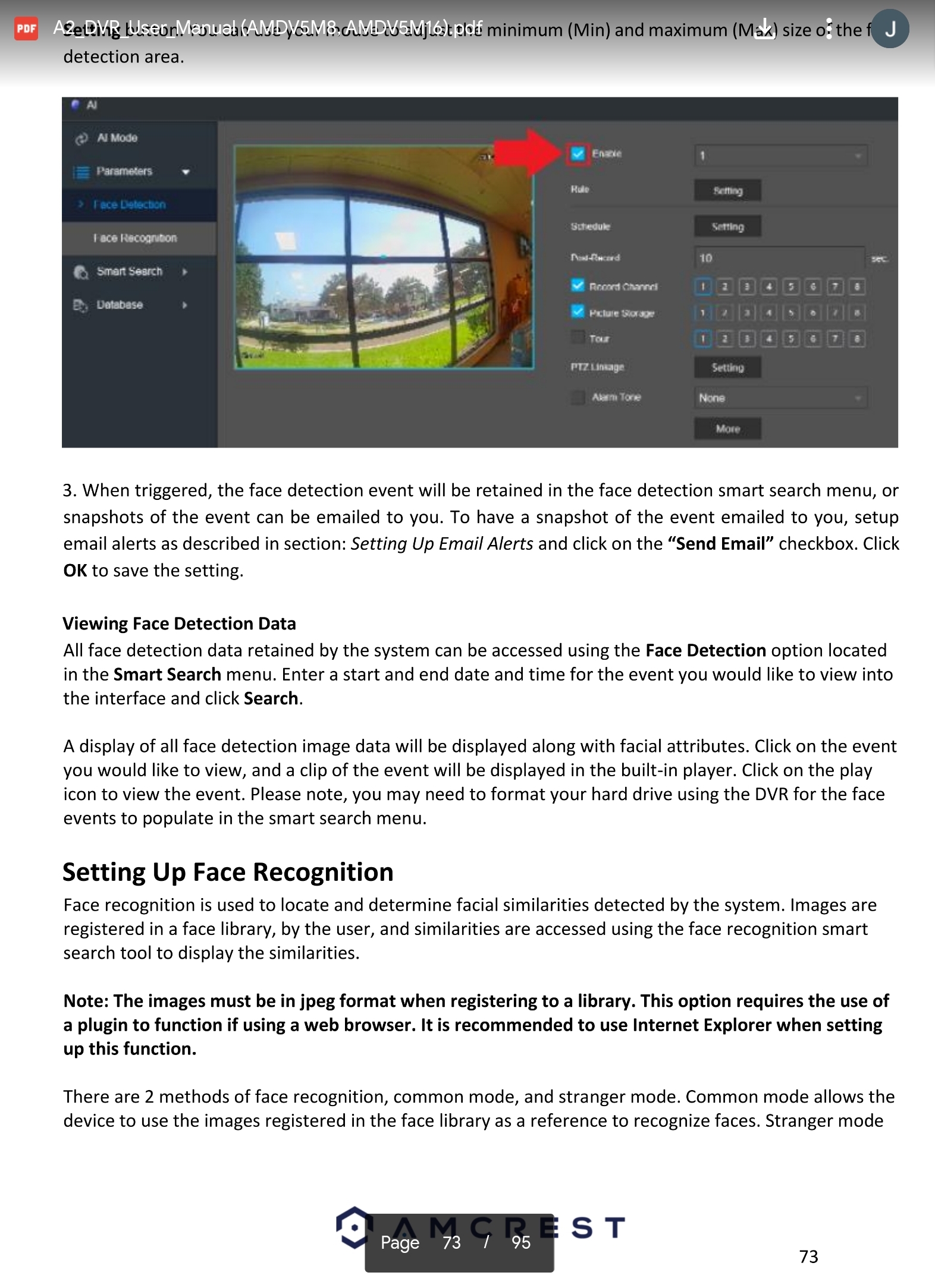

FWIW, the AMDV5M8 user manual says it displays facial attributes. Also, the technical specs pdf for both units seem pretty detailed.

Yes thanks I read manual and one of the reasons I want more info. Problem with manuals at times things can be displayed about a device other then the right one. I mean 5216-p8 don't say anything about having any AI ability yet they work like 4108-A2 if you use a AI camera it can pull in data. Just looking for more real world use not something posted in manual. However as I said somewhere else yesterday guess I have to buy one to find out.

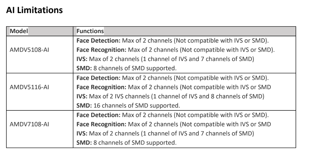

Well that is so nice lol.. So I look in the AI DVR manual that I DL before I bought the 7108 and I look online just now and there is more data now that wasn't in the 2 that I DL before.. So this whole time I made mistake of trying to setup SMD and IVS and it wouldn't work.. That was because I always had 2 IVS rules and tried to setup SMD and didn't work it wasn't until I seen the 5m8 that I seen it had 1ch IVS and 7ch SMD I thought well that is not cool mine don't do that lOL. Well yes it does, I just never tried with 1 ch IVS and rest SMD.. So here is Data that wasn't there to start with when I bought the 7108. FIrst as I said in a different post 7fps for the 51xx model and the 71xx model is 15fps <--- Starting data I didn't have before I bought was this was for 8mp only.. The others like my 5mp cameras work at 20 and the rest are 30fps..
In my older 16ch Dahua 1ch Face or 4 SMD and while it should know Human and Vehicle it don't work like the 7108 does or 2 IVS might have been 4 I would have to setup again to find out, it again isn't as good as the Amcrest 7108..
2021 AI DVR's
Screenshot (2616).png (137.47 KiB) Viewed 1162 times
2022 AI DVR's seems to be called A2?
Screenshot (2617).png (86.97 KiB) Viewed 1162 times
