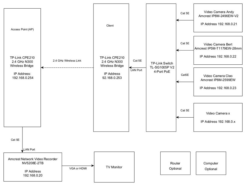

Aha - I have the connection from the switch to the nvr working, I have all four cameras Live on the TV Monitor by going through the switch. My problem was not IP Addressing but I was using the wrong input port on the nvr. I was going into the LAN port of the nvr but when I put my switch output from its LAN port to the nvr POE input port I was able to connect.
I was able to overcome ignorance with persevence.
Now I am onto Step Three, connecting the Wireless Bridge between the switch and the nvr. This is on hold since I do not have the Bridges, they on back order from Newegg.com, hopefully in a week or so. After that I will have to wait for spring, and the snow to go away, before I do the outside range testing. When I get this done (successfully I hope) I will update this Post.

Let me be clear, there is no internet connection to this application, no router, no WebUI, no cell phone monitoring, nada, nothing, check out the block diagram, there is no external connections. That is what makes this relatively simple to deal with.
The end location for this will be on a ranch out in the middle of Wyoming and the only time a person will be using it will be during calving season. You put the cameras over calving pens in a barn, put the pregnant cow in the pen when it is close to calving, and then you can monitor it remotely to watch for any problems. When cows go down to give birth they don't like people coming in to look at them, they get up and watch the person, thus interrupting the birthing. So, in the middle of the night, the owner gets out of bed at 2:00 am, checks the TV Monitor, sees if the birthing is going ok, and either goes to the barn to help or goes back to bed.
The main challenge of this project was dealing with the link between the barn and the house, a wired link was difficult, so a wireless link was looked at and planned. Also, the application needs to be a simple as possible, most ranchers and cowboy don't understand IP Addressing, POe, etc. Even this application is more complicated than I wanted but it does have a basis for future expansion to remote monitoring if desired.

This is an update on my "Wyoming Bridge" project for a wireless connection between a ranch barn and the ranch house, a distance of about 200 feet. I have successfully been able to get the equipment configuration in the diagram working. I can see the four cameras on the TV monitor in my working lab in my home. Although the wireless distance in the lab is only about 6 feet the demonstration shows that it should work as designed, I still have to perform the outside range testing to prove out an effective line-of-sight connection, more on that when the snow goes off.
The one thing that did give me problems was IP addressing connectivity but this was solve by making sure that the Network Video Recorder IP address was static and the camera IP addresses were static. After I got that resolved I was able to randomly power-down and power-up the system with automatic connectivity. Just put the power to the two portions, wait for the boot-up process, and after a couple of minutes the TV monitor is full of live images.
One objective of this project was no router or internet connections, because in this case, neither were available. The Router and Computer are shown here as they were used during setup and configuration purposes but are not used after that. I will update this posting after my next two steps, local range testing between buildings and extended range testing of possibly 1 mile line-of-sight.
