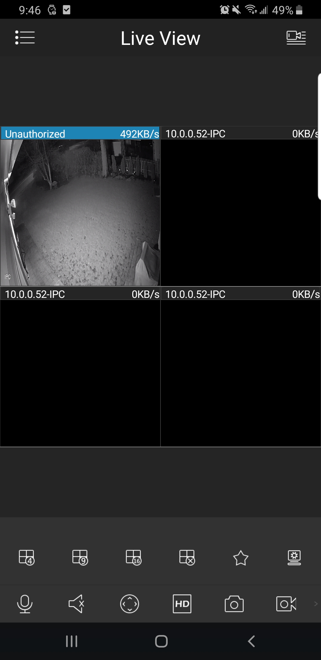

This has me so frustrated, some days 3 cams work, some days 1 i give up. Restart after restart, connections are sound, and I replaced one poe camera and cable just to be sure. Is it the DVR?
Need help, not working 2 years old

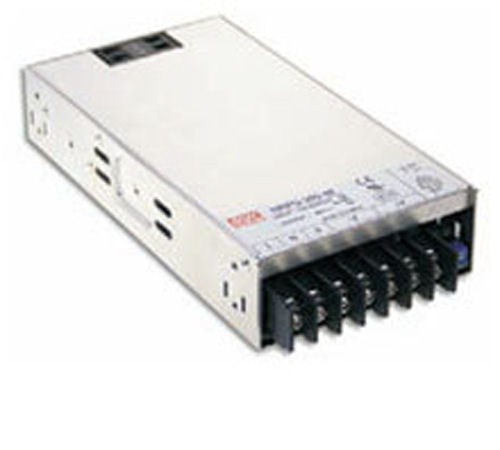

To be honest it would be hard to give a good idea of what you should buy... However for me because I have been in the CCTV for long while and have a few to many different types of Power supplies here is what I would do if it was me...
Because of the good long life that Mean Well Power supplies have giving me over the years.. I would buy a Mean Well 48vDC Power supply, Put on the Power cord watching the way it needs to be connected as it is clearly marked, Then I would buy 16awg aka gauge wire and the unit plug for the NVR.. Then noting and testing that the Ground wire is connected to the outside of the plug and the Positive is connected to the inside of the plug. Make sure it is out of reach of Children and plug it all in and turn it on.. While they do cost little more and don' t come in a nice small compact plastic housing they do get good air movement and as long as is installed in a nice not to damp or hot of a location it will last you for good long time...
Right now the 5amp one cost more then the 7amp one and I would have bought the 7amp anyway.. But you can find them on that Auction site ?-Bay... May be able to find them on Amazon as well..
Just keep in mind that all the polarity needs to be in the right order and I would test the connection before hooking it to the NVR to make sure that it is 48v and ground on the outside of the round plug as your current power supply shows now......
