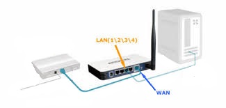

Sorry I don't have your T Mobile setup. I don't know what it offers but if it has a Lan Port to be honest this is what I would do...
Use a Second router like a Netgear Nighthawk, or some other normal router that you would connect to a Cable Modem lets say.. Connect your T-Mobile lan port from that device to the Internet in port of the other Router. (Normally Orange or Blue)
Your main TM router should have a Network IP setup for a Lan, Just make sure that your other router isn't set to the same IP
