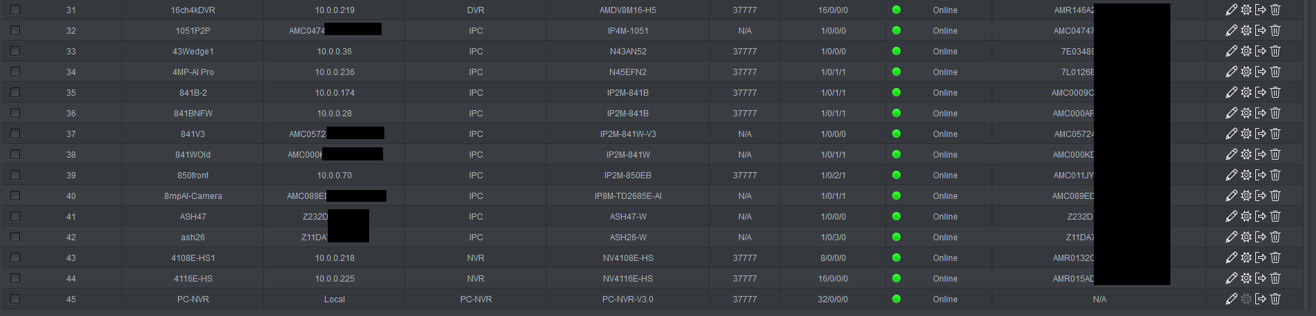

If you have internet access at your Remote location, I would setup your Amcrest View Pro using the Serial Number Method. If you DL ASP from Amcrest and again using the Serial Number of the NVR add it to ASP, you can have access to look at your NVR over your Computer Monitor.
So here is an Idea, If you don't happen to have your SN for your NVR, When you gain access to your NVR and cameras I would make a database with your SN of your security devices. I wouldn't put that in the same location of the passwords, however I would keep it handy for an event like this...
I have a lot of devices and I learned the hard way one time ago when I didn't record my SN and lost connection to a remote device. Only thing I had going for me is that I have someone close by the I trusted enough to leave a Key with and was able to get the info from them.
If you don't know the SN, Maybe you were using an App once and took a Screen shot of the devices Page that might have had it, If you have the box local to you as sometimes the location of the device isn't' the same of the storage of the packaging that might have the SN on it.
Looking at the picture below of my ASP. This is just the last part of my list. YOu can see that I have some setup for Remote use using the SN aka P2P format of setting up and the others I have setup for local only using the IP address of the device.
Screenshot (4614).png (82.25 KiB) Viewed 855 times
