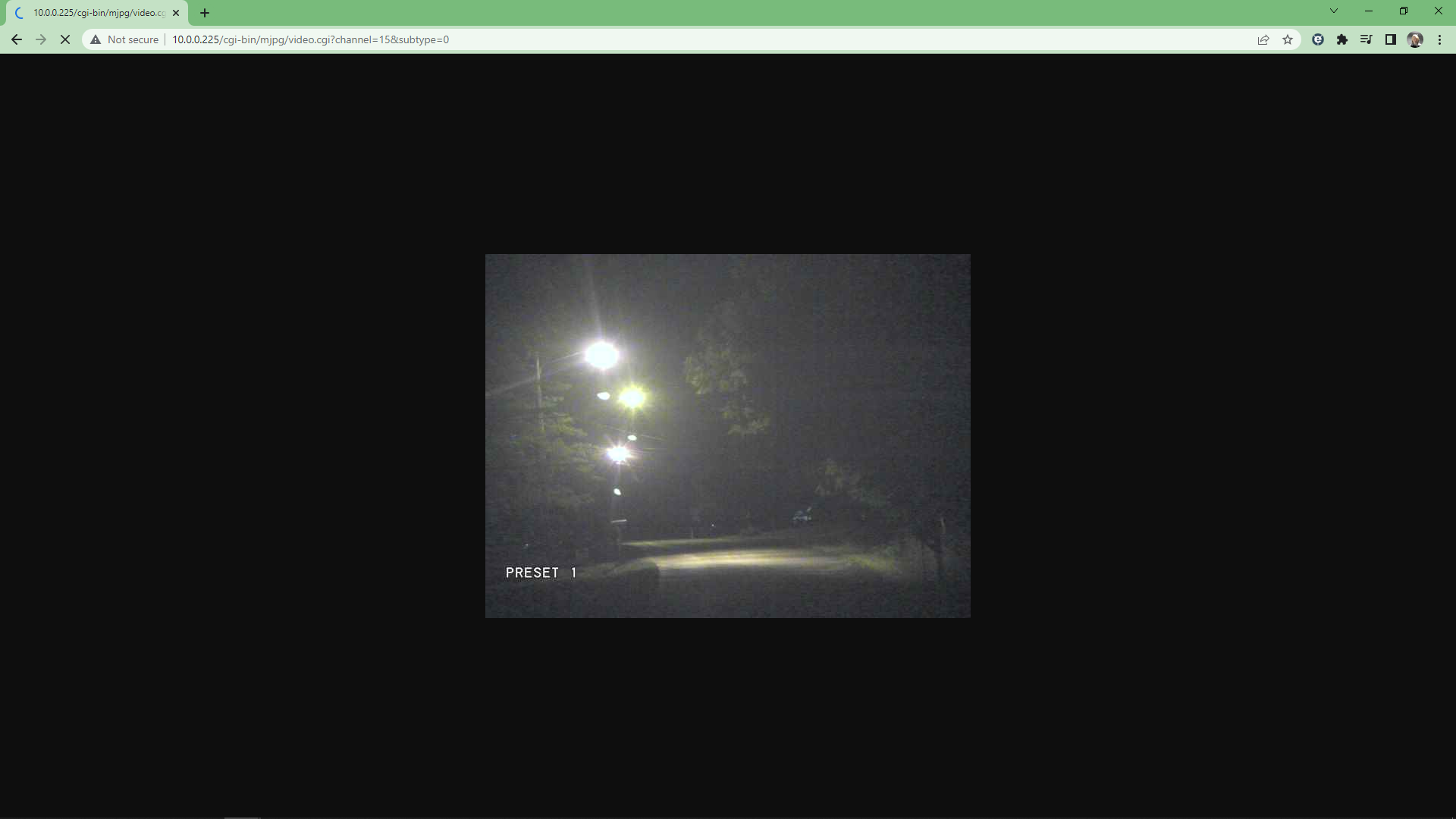

Not all Amcrest camera support MJPG, and only with substream. Use camera Web UI to see if your camera substream supports MJPG.
This command worked fine for me with Chrome, NO NVR, and IP4M-1026 which supports MJPG.

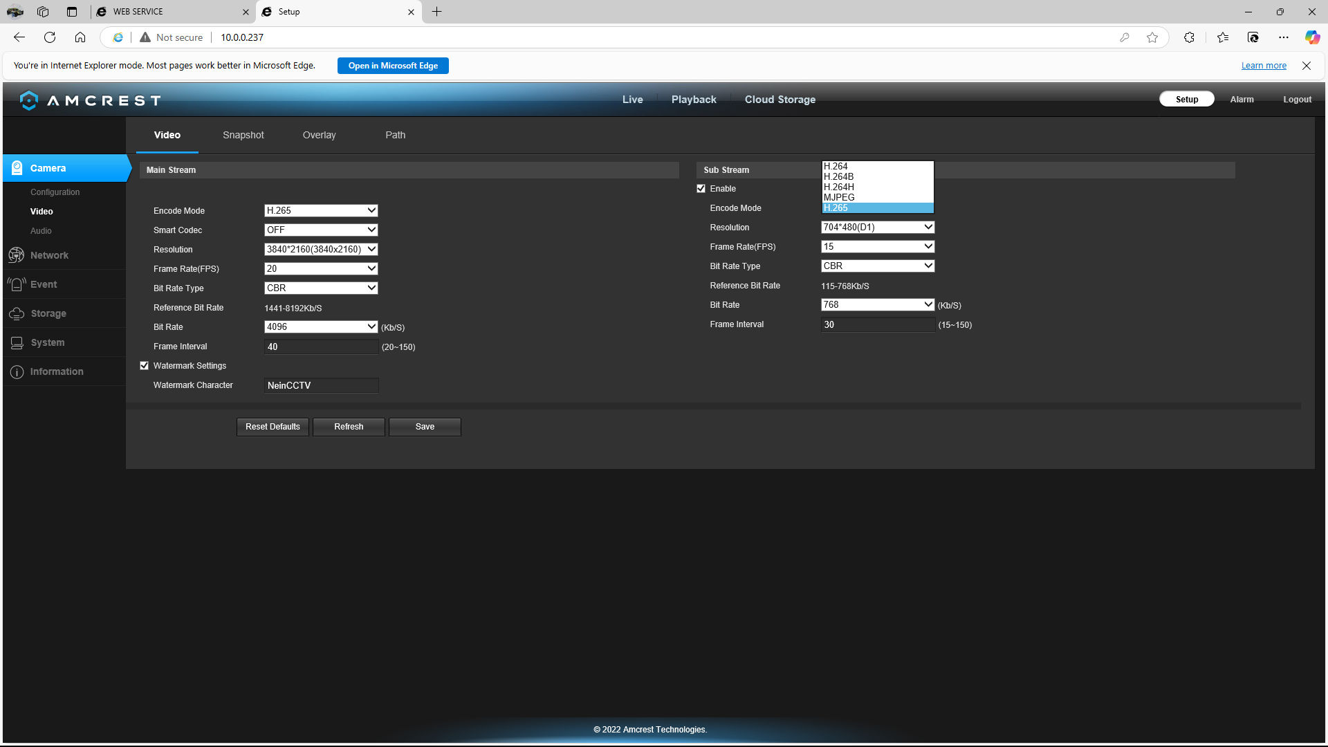

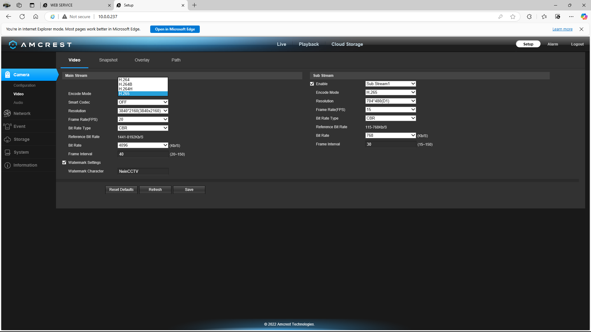

your best bet if your Channel your trying to access don't offer MJPG then you will get a little box. So I do have some cameras on my NVR's that offer it so as you can see from the screen shot my Samsung has that for main stream hate to say very spendy camera from years past has one type of main and not even useable most times so I full time record the sub stream that is h.264 30fps.. I mean it has 10 streams just 1-3 can't be changed positions wise lol Anyway so that is only one that would work on that NVR I have some others on other NVR's however that feature isn't all that great to stream a live view best to RSTP...

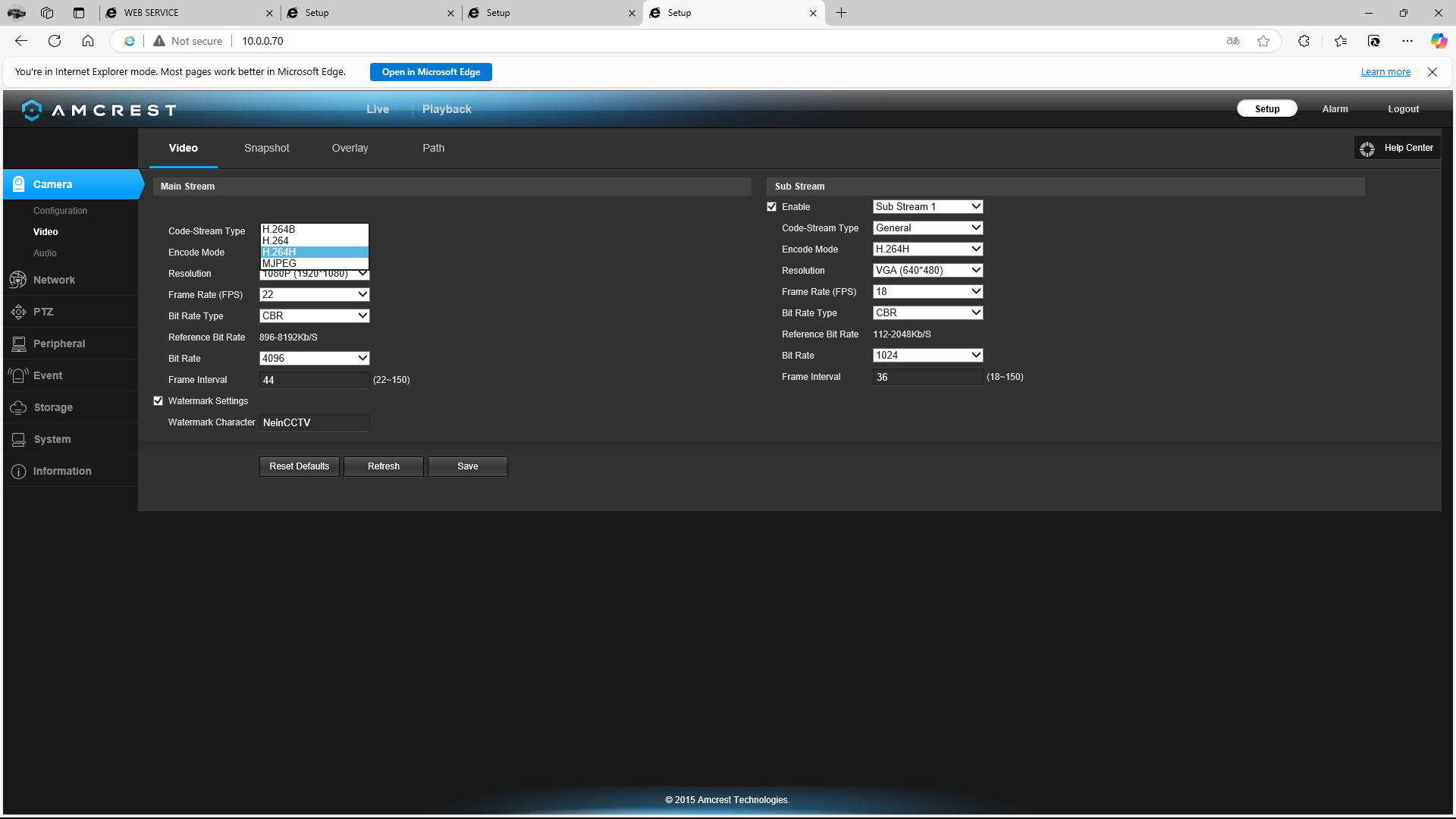

Please note that looking at my cameras in the pictures first ones will be of my TD2685EW-AI camera only offered in Sub Channel, Then looked in my 2779EW-AI that is also a 8mp ai camera and again it only offers it in the Sub Channels and then the one that I was able to find in Main channel is a 2mp PTZ camera from years gone last FW was like 2017 even though the webUI says 2015 so very old browser tech and it does offer in the Main and Sub. But again by changing it just for some images through out the day any HD footage of real events will also be recorded in lower quality MJPEG format as well.. On top of all that no images will come at that format without first going to the WebUI and setting up your camera to support that format.. Again it will not do both using H.265, or 264 for normal captures and your images at the lower quality format of MJPEG at the same time on the same channel either main or sub if it is supported it must be changed to that format..
But what I will say is that if you want a MJPEG format setup you will need to have a camera that supports that format.. Now some of the newer higher quality cameras have different encoding Tech and maybe you can get it from Main.. 1 problem however. If you setup your HD camera to a lower quality stream encoding format then you will not have a High quality feed going to anything else. It is one way or the other.. What I have said before is that normally you can setup some cameras with MJPEG on the Sub Channel and this way all other events captured to the camera are not low quality MJPEG format..
