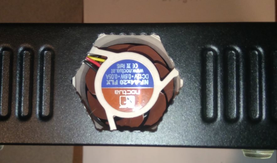

The Noctua fan has arrived, and it's built in such a way that the grille is on the outside (exhaust) part of the fan, so cutting away the mesh grille on the NVR is no problem since the fan itself comes with a built-in grille. I was going to report on installing it but there's no obvious way to shut down the NVR, see this post, as soon as I can find out how you're supposed to shut it down I'll install the Noctua and report back.

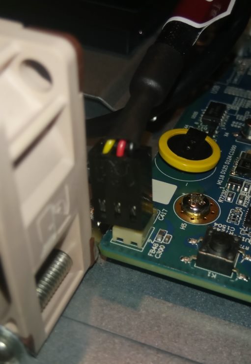

So I finally managed to shut down the NVR, see the details of this saga here. Fitting the Noctua fan was a bit tricky because neither the electrical nor the physical connectors are compatible with the NVR. The electrical connector is 3-pin while the NVR is 2-pin, to get around this I cut off the keying lug on the NVR and plugged in the two power pins on the 3-pin fan connector, leaving the sense pin unconnected:
The outermost pin on the NVR PCB is +12V, the inner one is GND.

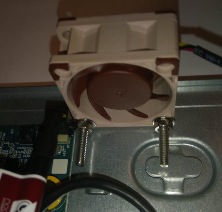

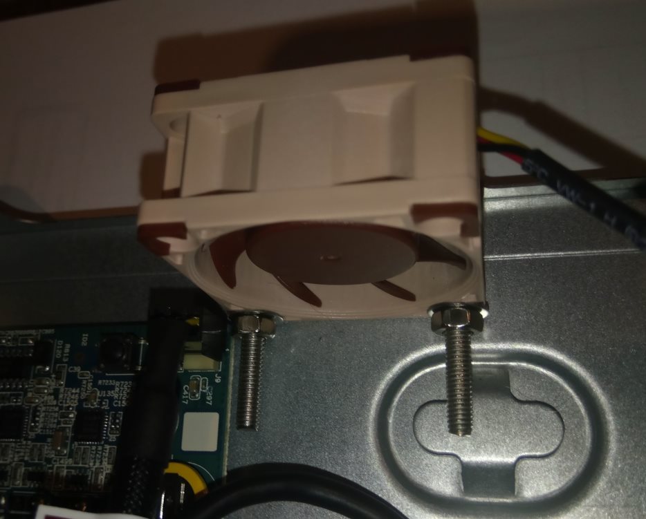

Then I had to attach the fan to the case. The Noctua silicone vibration-damping mounts don't really work in this situation, and the existing fan uses self-tapping screws that are too small for the Noctua fan. Conversely, the Noctua self-tapping screws won't fit through the smaller mounting holes. I thought of reaming them out to fit the Noctua screws, but I'm not really a fan of self-tapping screws anyway since they're typically single-use only, once they've cut their threads you can't remove and reinsert them without losing a lot of grip each time. Also, by solidly anchoring the fan case to the NVR case you're defeating the vibration-damping grommets in the fan case.
Instead, I used some M5 bolts, which clamp onto the silicone grommets rather than biting into the fan case:
Another view:

As an update, today I went through the full three-part theatrical performance with backing actors and orchestration that's required to shut the NVR down and swapped the low-noise for ultra-low-noise cable, which just adds a higher-value dropping resistor to run the fan at an even lower speed. The result still, subjectively, moves a bit more air than the stock fan did but is now virtually silent, in a dead quiet room you need to get within about 1m of the NVR to hear it running.
So in summary, cutting away the grille and fitting a Noctua NF-A4x20 FLX cabled for ultra-quiet operation makes the NVR dead silent, with no impact on cooling.

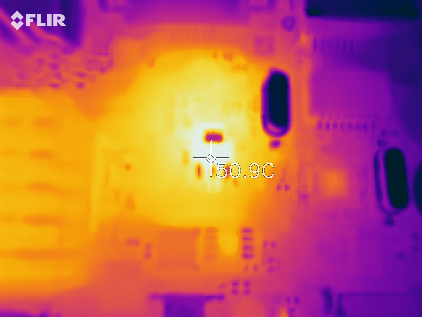

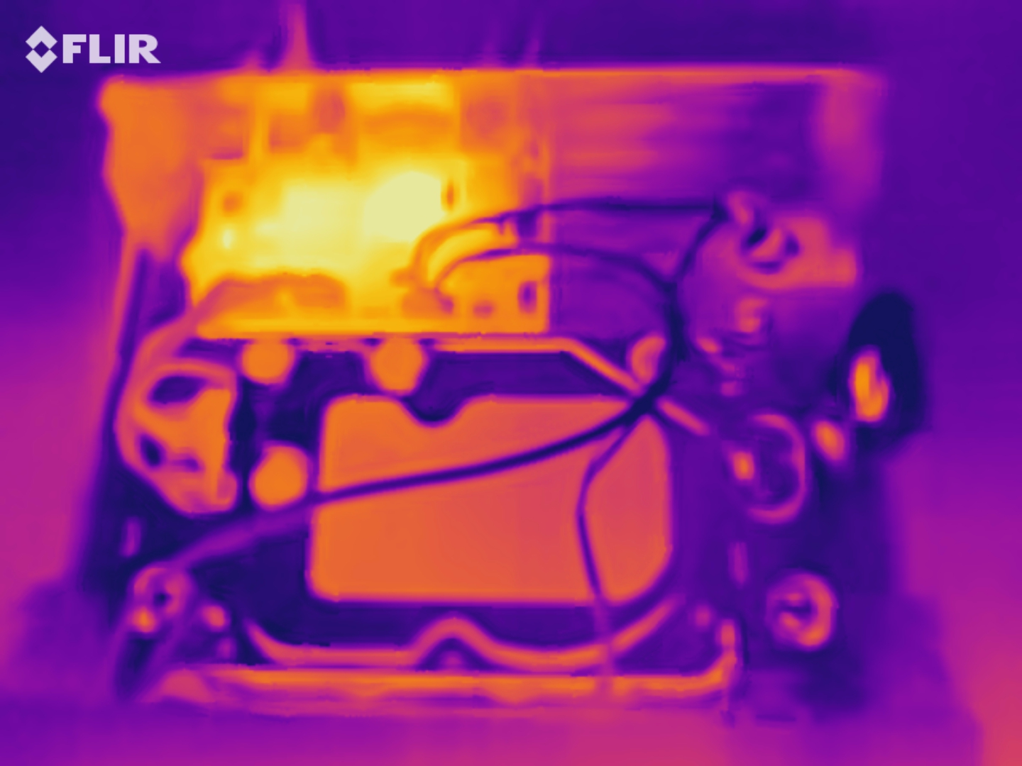

I purchased an Amcrest system that included this NV4018-HS NVR a few weeks ago and have talked to Amcrest's tech support about the fan noise several times since. Yesterday I found this thread and confirmed my findings that this fan and the existing case ventilation restriction is a poor combination. This is apparently not a new problem for Amcrest systems in general. There are several threads on noisy Amcrest fans and even an instructable about quieting an Amcrest DVR by replacing the fan. Maybe the Amcrest engineers need to review an article on the "Effects of Grille Patterns on Fan Performance/Noise". My fan is also in a configuration to suck air into the case. It is so restricted that I can't tell that there is any air movement going on in there.
I did a little investigating with my thermal camera to attempt to identify the component(s) requiring the fan at all. Amcrest claimed that the HDD required cooling. The top cover on my HDD is reflective, so the emissivity gives a false reading in the image, but you can see the edges are not that hot. It turns out that their board is pretty toasty! The component with the heatsink must be pumping out some heat, but the heatsink is doing its job. The next real hotspot is a transistor (that I didn't go to much trouble trying to identify).

Thanks for the Effects of Grille Patterns on Fan Performance/Noise link, very interesting! In my case I just used the plastic struts of the Noctua fan body as grille, so no explicit grille but the fan body itself protects fingers, unless you're really determined.
The thermal image is also interesting, another possibility with the single heat source on the motherboard is to mount an alu block that reaches up to touch the case, so the case is acting as a heatsink. Since I haven't had any problems with it so far, and the air being exhausted is barely warm, I'll leave mine alone for now...

Do you have a closeup shot of the motherboard? Just wondering what that hot component could be, could it be a three-terminal regulator, or if it's a PoE version a transistor acting as an external pass element for a switchmode regulator used to drop the 48V down to whatever the MB needs? If it's the latter than there should be a switchmode controller paired with the transistor, e.g an 8-pin IC like the widely-used MC34063. Even then you wouldn't expect the transistor to get that hot, so a photo of the device and surrounding circuitry would be useful.Yardstick wrote:The next real hotspot is a transistor (that I didn't go to much trouble trying to identify).
