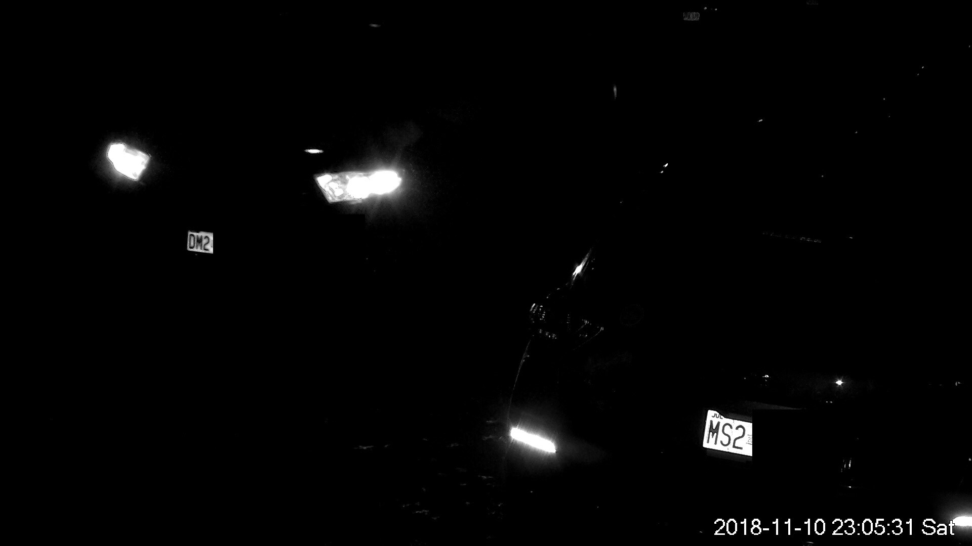

After trying many different settings and combinations of settings, I was able to get great night time plate images by simply changing the Exposure to Manual - Shutter Speed 1/1000. All other camera settings I left as the default values.
Here is a sample image of two vehicles approximately 20 feet from the camera. For privacy, I have masked the right half of each plate. The plate on the left is a vehicle moving at approximately 25 mph. The plate on the right is a parked vehicle.

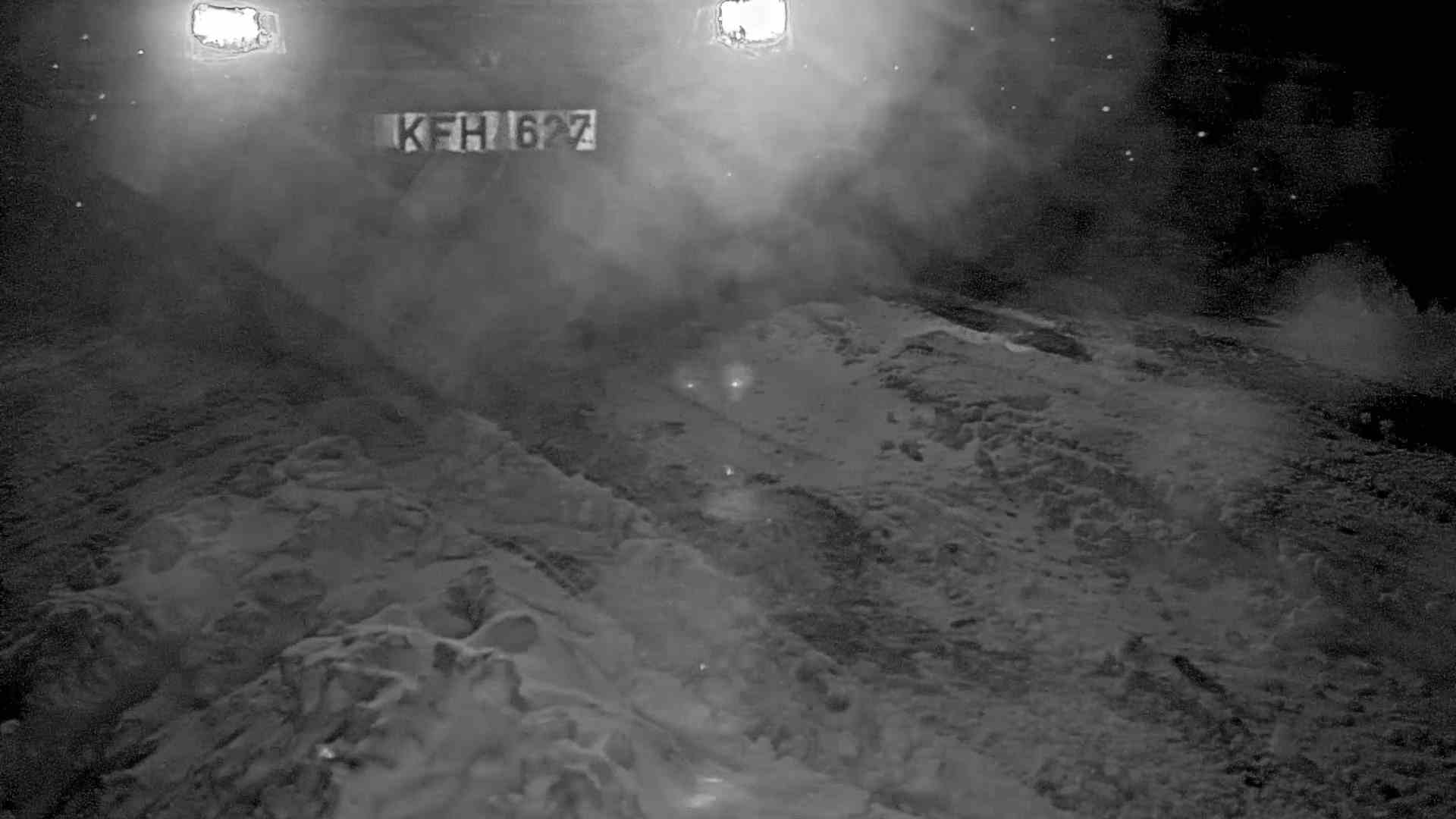

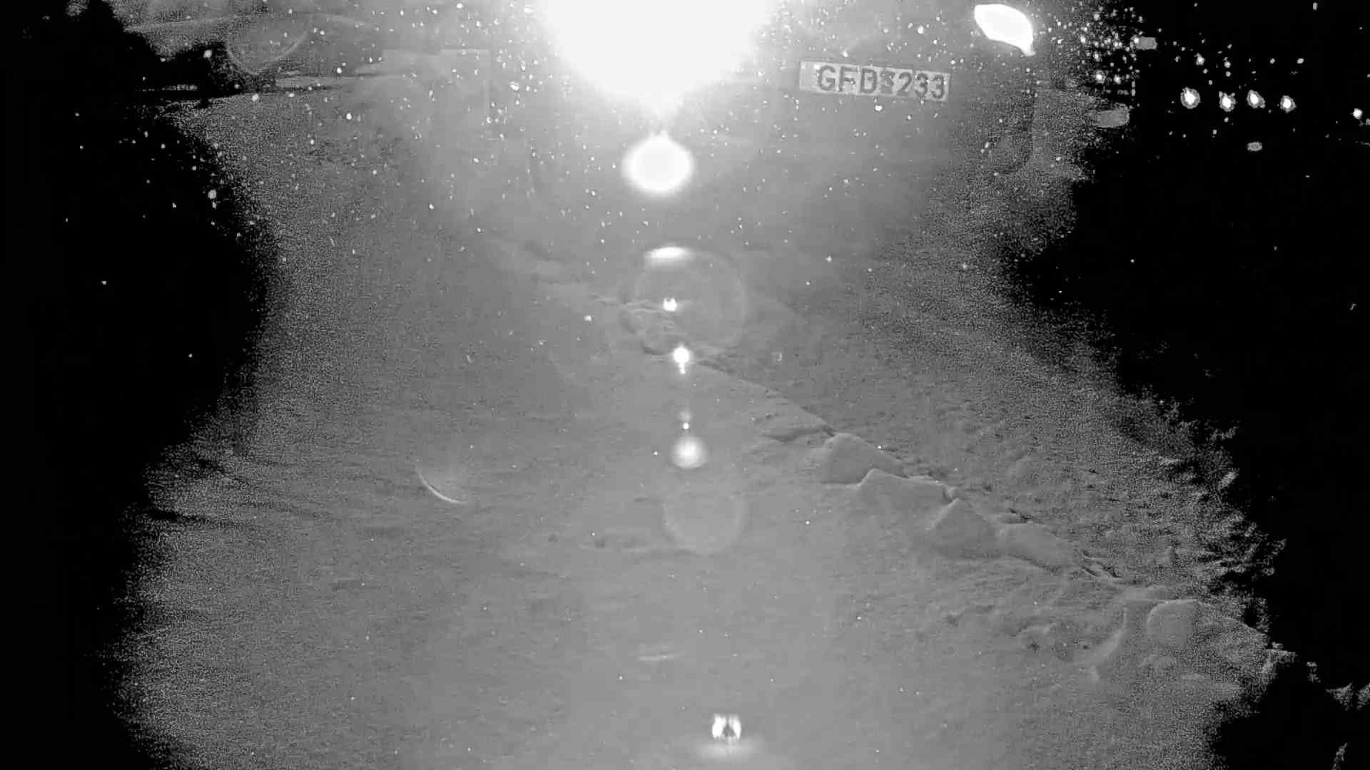

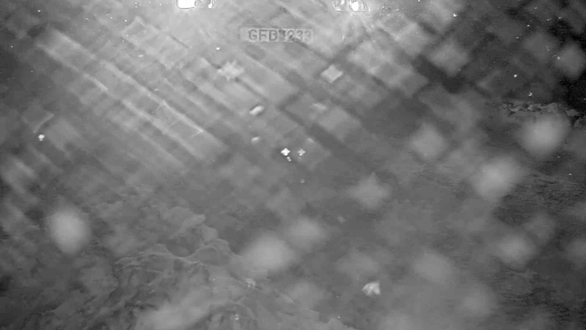

These pictures I have
- 07_45_29_415_GFD233_.jpg (101.09 KiB) Viewed 6460 times
- 07_44_07_646_GFB233_.jpg (59.25 KiB) Viewed 6460 times
- 07_07_40_769_KFH627_.jpg (79.88 KiB) Viewed 6460 times
