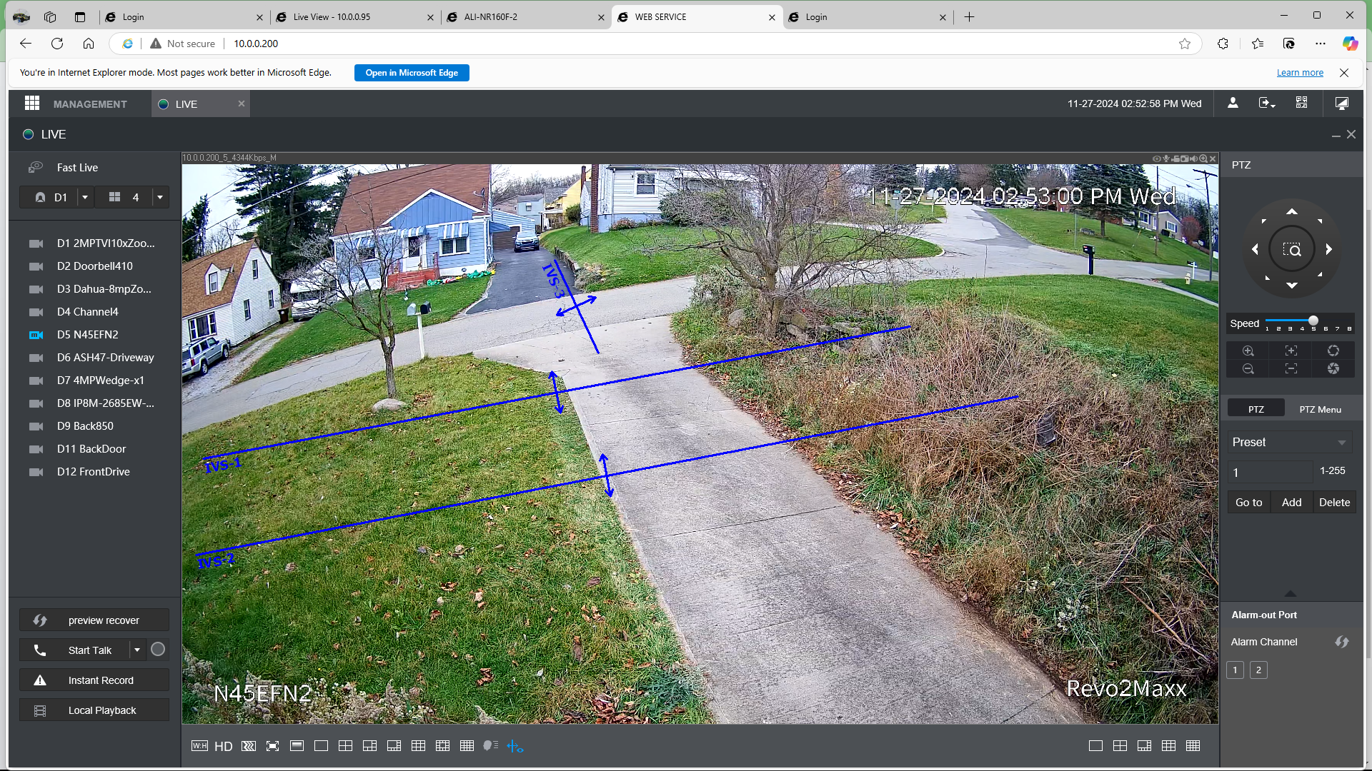

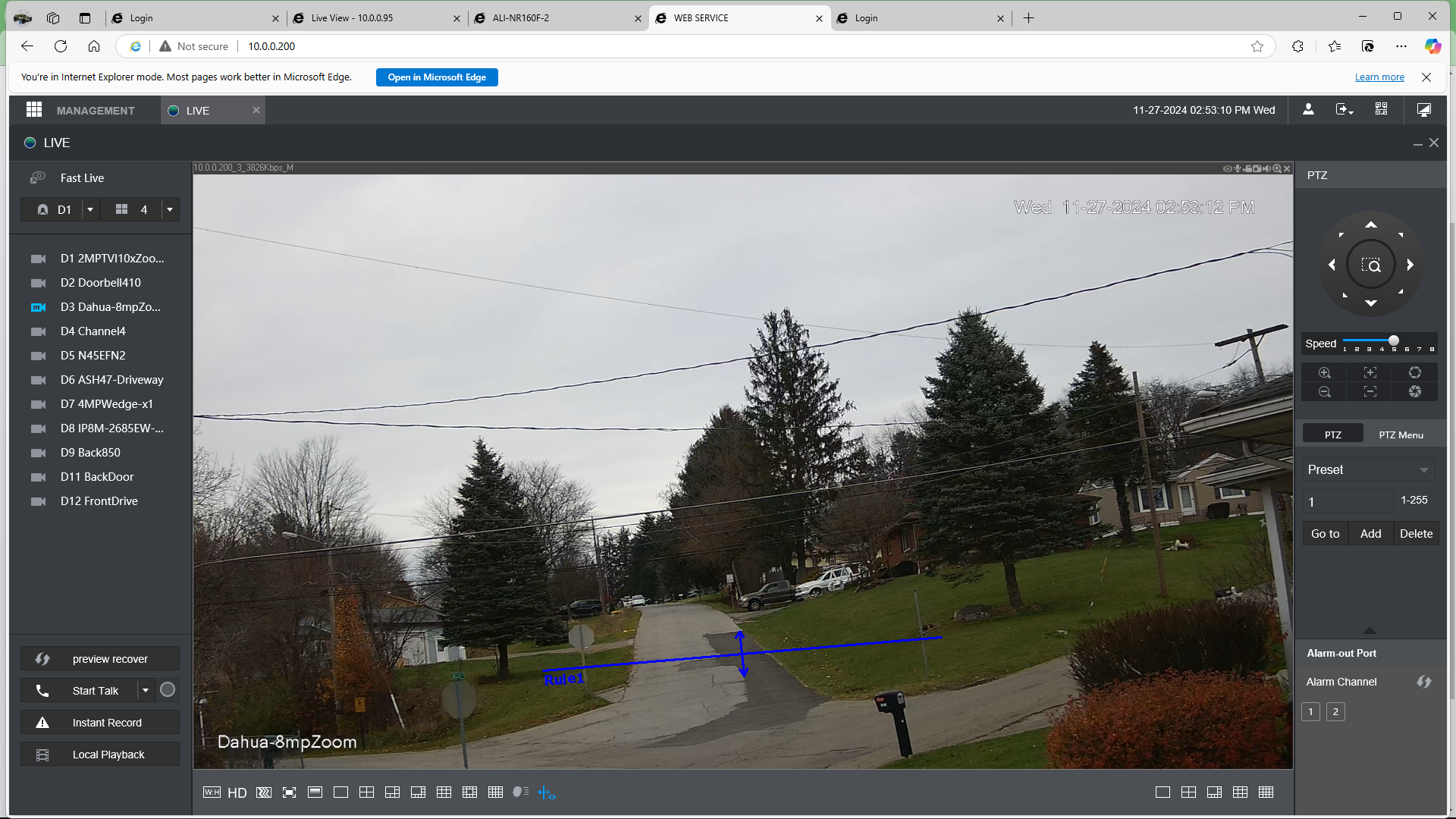

To be honest the key is to install the Ai and test to make sure that the camera will give best results in the Region of Interest. Position of the camera is one of the main important parts to installing any camera system. Things to be mindful of. If the camera has a lot of light in the area of interest that is pointing at the cameras lens this can cause the camera to not work as you might want it to. Try to keep the area free form things that can reflect back to the cameras lens like water or glass.
In general the cameras LED or IR distance is about the true distance that the camera could work well in Ai mode. I personally discount this to about 1/2 of what it says until I test and confirm.
So in these 2 pictures I am showing an Extreme don't want to position a camera like the Dahua 8mp here. The 4mp Dahua on my Driveway works well because of the placement, the cameras lens and Fstop the camera is able 1 to work at night in Color without turning on its built in 4white Leds. 2 is able to get the tripwires at the areas it is placed. Now I did have a second one going over the road I took out last night. That was my trying to cut down on the number of alerts I was getting over 3 different cameras of the same vehicles lol. Anyway the main issue with the 8mp is that it is pointing to high. Next at night that area above the Tripwire to about where that road goes flat is pitch black there is no steet light there. Next issue with the cameras placement is the street lights that the camera can see cause glare and overexposure. I do run this camera in Color at night. The 4mp is by design color at night with 4white leds again with the amount of light the camera don't use the built in LEDS normally it may kick on once or twice a year.
Why does the 4mp camera work over the 8mp, Well as I was saying placement and Sensor and Fstop is crazy open. Center of view for 4mp is placed well and only 1 light from the garage behind the house across the street is small issue for glare. Normally I Mask it out but so far this year I have left it unmasked and all events have been fine at night. Then the 8mp camera is to high in the sky with the Center of view up through the trees. The 8mp camera is a way not to position a camera at night that you want to capture things from. Next issue and really the main issue is that the 8mp is a zoom camera and the Fstop is very small at the current zoomed location. 4mp has a sensor size of 1/1.8" and 1f/stop 2.8mm lens, and the 8mp has a 1/2.8" and normal 2f/stop at the zoomed out of 2.8mm and the current zoomed location is about 8mm if I had to guess and the Fstop at that location is going to be in the 4+ area..

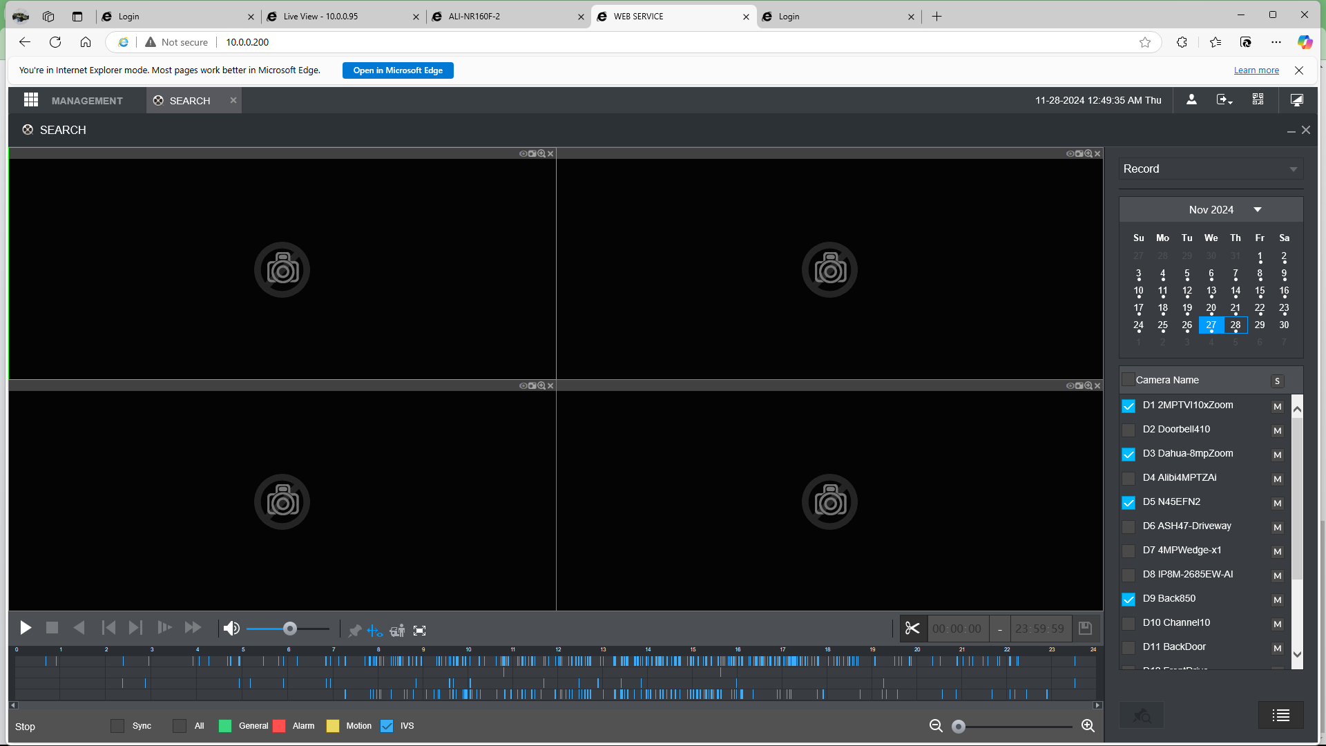

So in my 2 pictures below, I have my 850EB that will be the 4th line in my search. That is not an Ai Camera but i am using my 4216-E1 NVRs Ai ability to give it a Tripwire.. In the first picture you can see it has the Motion enabled in the search. It is raining tonight and you can see most of it was when the rain started up. After midnight it stopped for maybe 10 min and then it is just full motion event for that camera.. That cameras placement isn't needed for full time recording so I don't record it on Sub Channel. However if it was only camera in that area of interest then I would record on Sub just to keep eyes and ears on that area. Keeping the motion off because it would take more space to run motion events full then it would to just record normal events on main and full time recording on the sub..

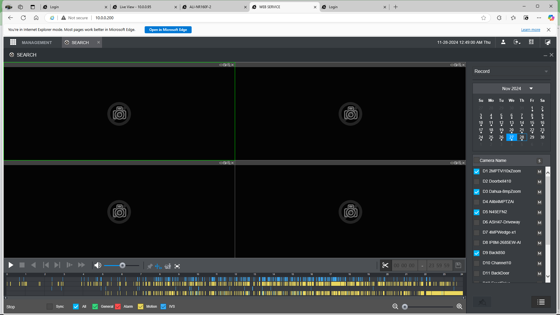

The second picture I turned off the motion search part and enabled IVS only to show kind of why motion and IVS isn't a good thing to have going together. One and this is most important part. If your IVS triggers lets say 2 seconds before your motion event is triggered the NVR will not record both events it will pile the last over the first. So if your Motion was first and then passed the Tripwire again it will start part of the recording then pickup the other and things in this case can get lost.. So then it kind of comes down to this.. Seeing you have an E1 NVR you could setup with 2 HDD to record motion events into your NVRs PICTURE storage and setup the Storage area to send them pictures to different HDD.. Then only have the Motion events setup to save pictures and not record. This way all the events are triggered. Then looking at the pictures to find if there was a real event and if setup to playback sub again could set to record on second HDD with pictures like I do.. Then you can use the Pictures time stamps to find the footage that was missed by IVS..
You see with motion lets say it like this. With rain or a bug even if motion is enabled it can kill a real event that was triggered by IVS that is why I normally don't use motion and IVS together..
