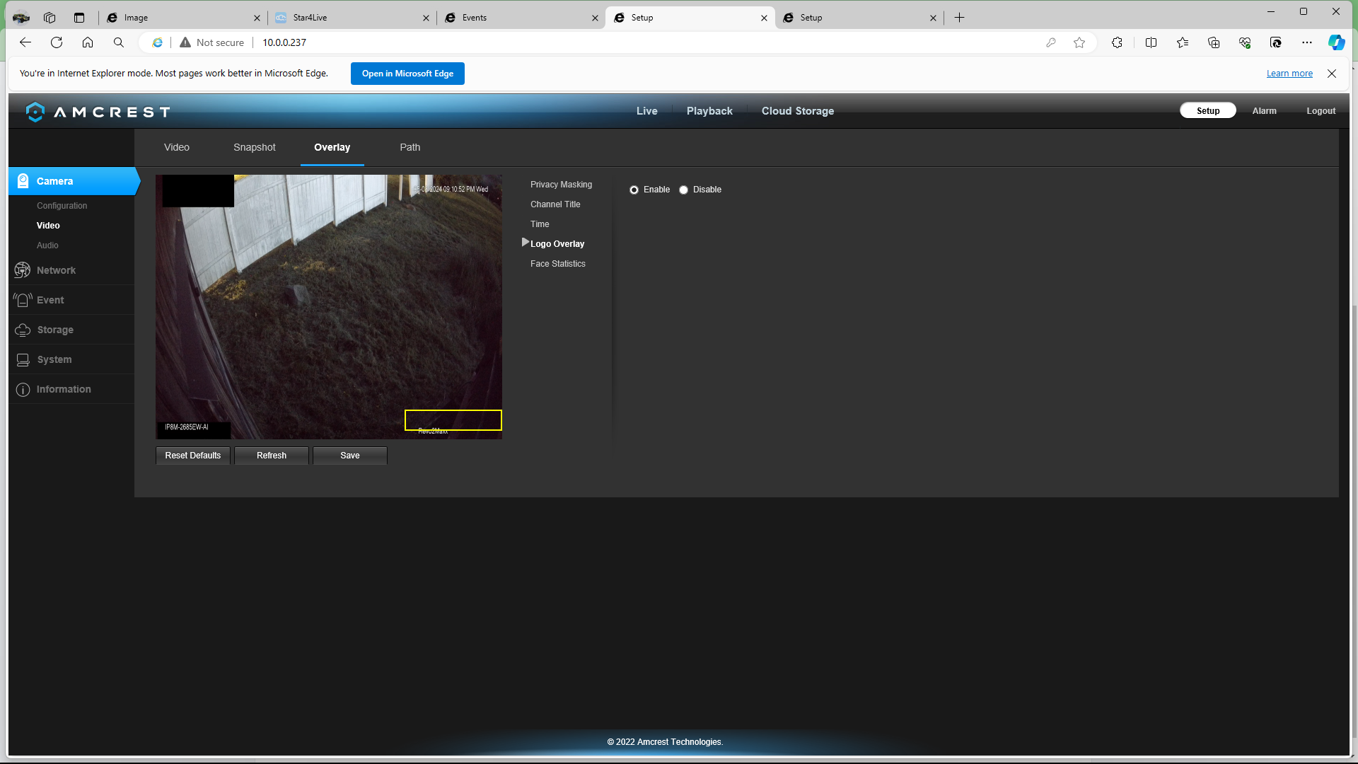

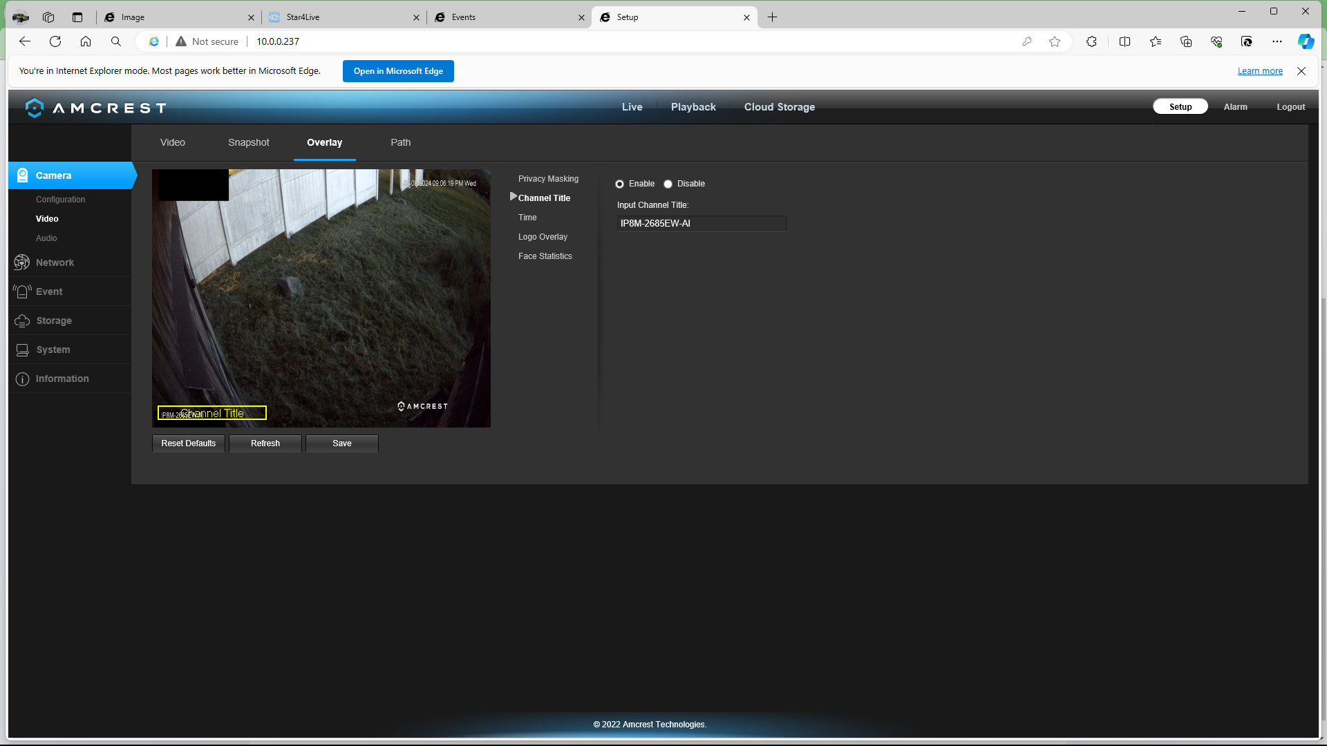

So Here is 2 pictures, First one is Stock setup for my newest AI Amcrest camera. I have the Logo of Amcrest still enabled.. If you look in the info of the camera there is no OSD option to add extra text like you can some of the older Amcrest Camera. Might be a update to the camera in the future, However in the FW being used right now no way to add Revo2Maxx. However from the NVR there is a Custom Text Option and adding that info in the NVR, It removed the Amcrest Logo and added in the Extra Text.. If I want the Logo to come back all I have to do is in the WebUI disable Logo, then reenable it and Amcrest comes back. Yet if I wanted it back in the camera using NVR extra text area just press save seeing that the data was still in the WebUI text area..
