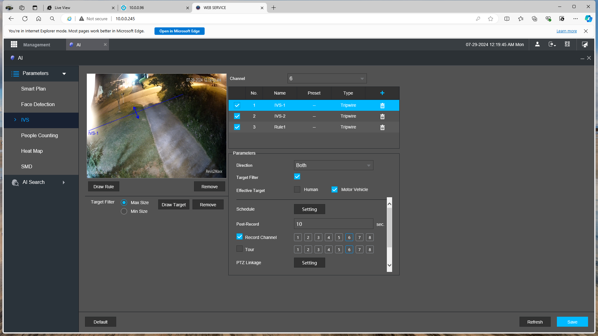

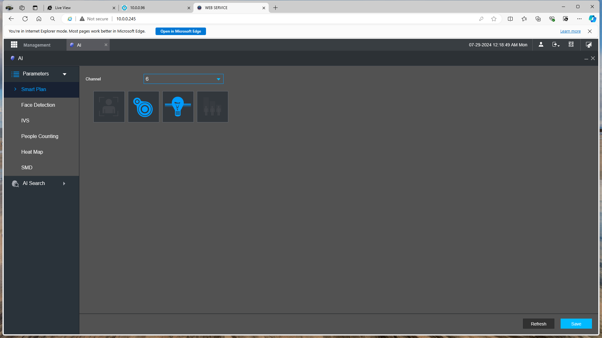

OK so there is a lot there.. In the 4104 are you saying that by OLD is it the 4104H or is it the 4104-HS?
Next when you connect a AI camera to a non Ai NVR the only option is MD. Same would be said for the normal 41xx-HS models that has new Firmware on it while the NVR will show the AI rules there is no function in the NVR to record AI features.

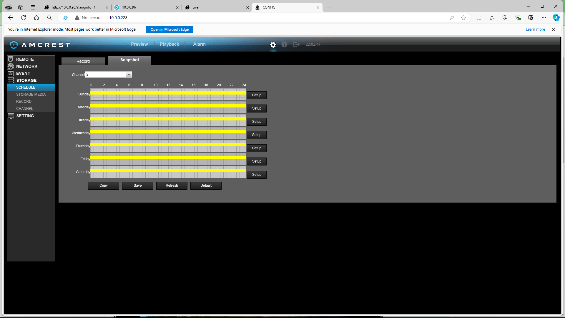

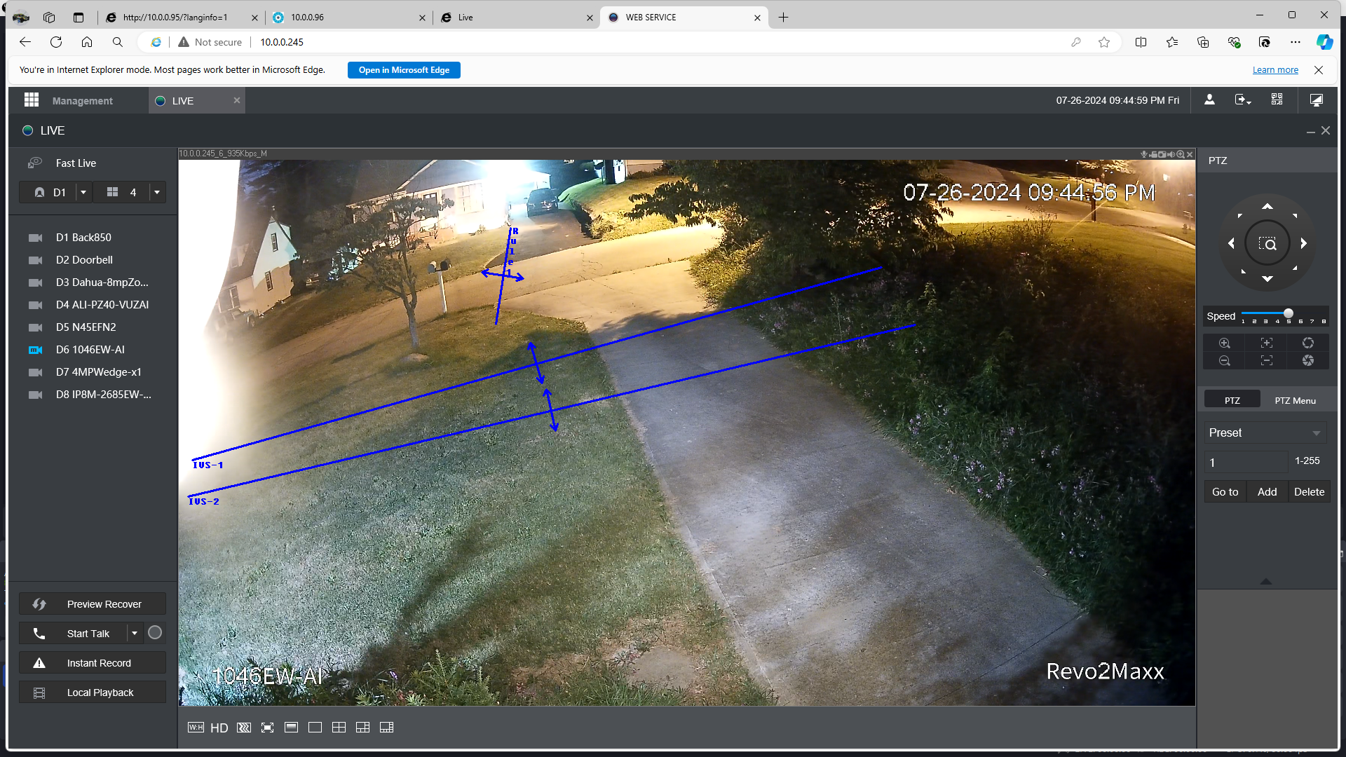

So does your NVR look like Picture 1 or Picture 2? when using the NVR WebUI? If you have AI options enabled does it show like pic 2

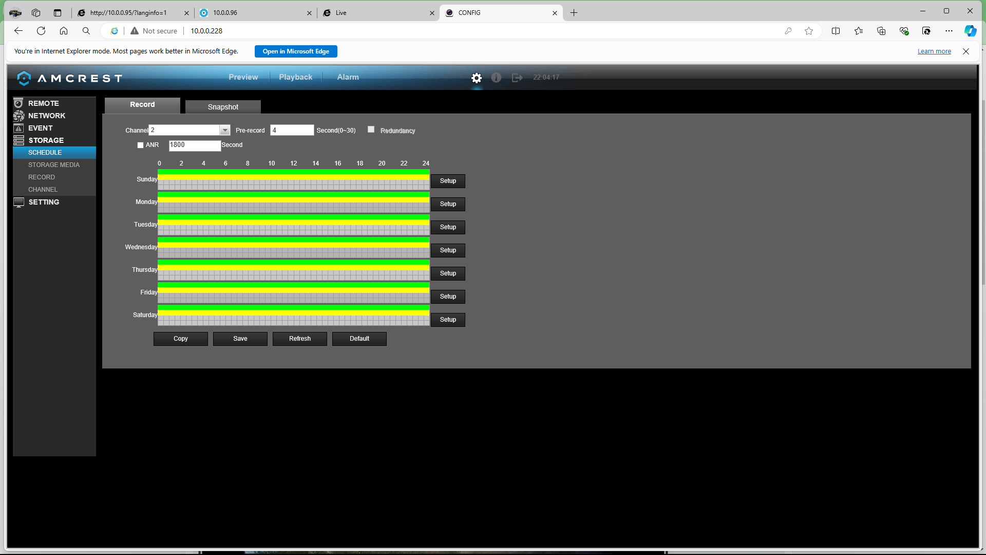

Anyway there is feature under your storage for setting schedules in there you setup the NVR to record full time. Motion events should record motion if you have it setup and enabled..
Screenshot (2031).png (2.06 MiB) Viewed 4010 times

In the WebUI here is what full time Recording with MD also setup in your NVR would look like, Please note that it is best to change your recording for snapshots to be setup for MD only if you don't it will also fill up full time snapshots that will record every second of every day. Unless you changed to a different value for full time snapshot setup..

Re: IP camera vs NVR motion detect messages
Don't know the camera you are working with, However if you are going to use SMD you will be asking for more problems then you are looking for..
1 SMD don't have any thing outside of the ability to search motion detection for a type of event, Human or Vehicle. Problem is all MD will be sent over the email or push..
If you are looking to keep the events down you will want to setup IVS if the camera offers it. You will want to setup a Tripwire or Intrusion and use the Filter to choose what one you want. In the picture of the IVS I have 2 lines going from right to left that is because I only want emails or alarms if there is a human but want the info recorded.. You see if you setup 1 tripwire in an area and filter both vehicle and person, then your notices would be sent in push or email for both..

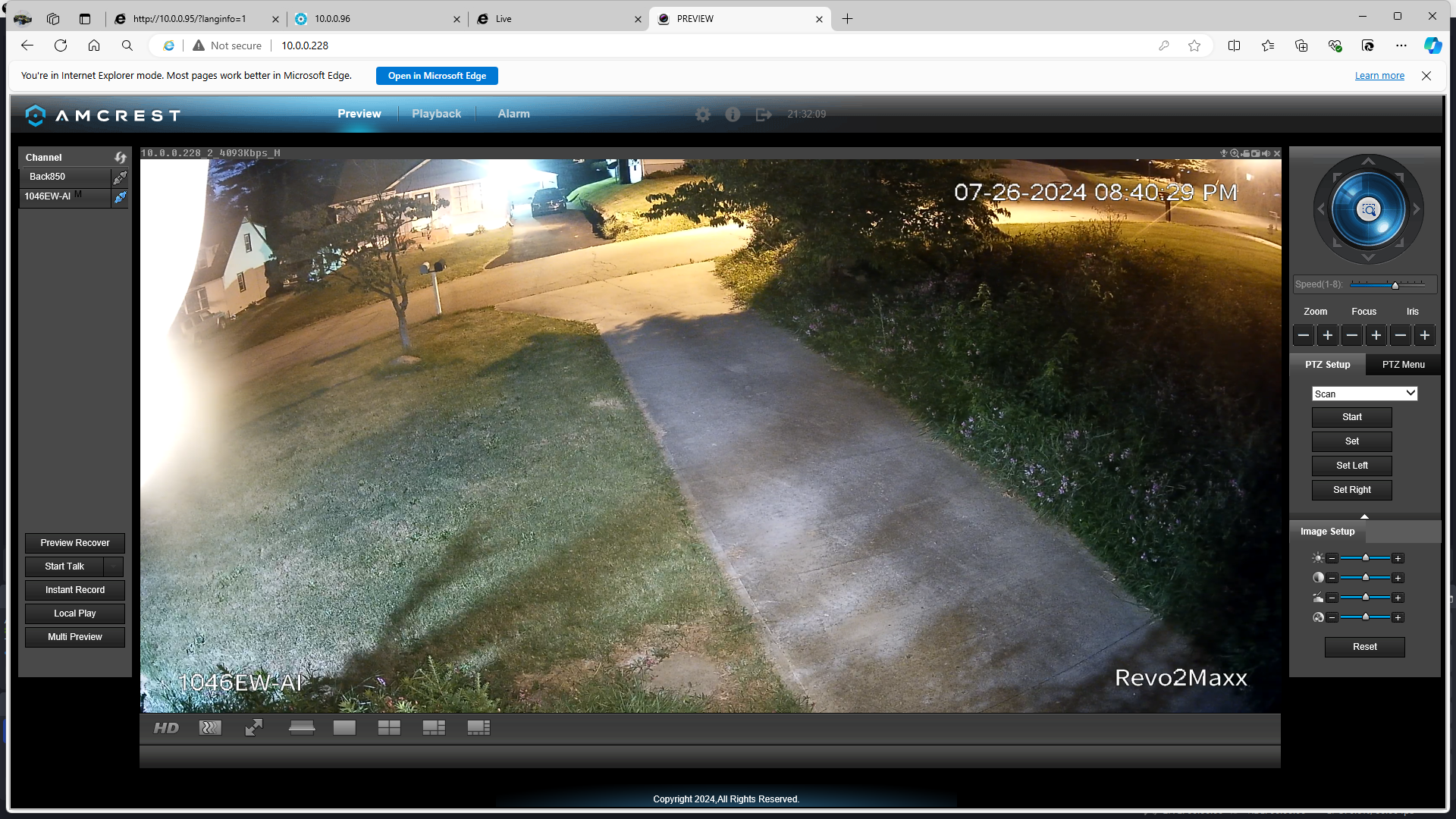

Win10 has Edge, as you seen what I used for my pictures use Edge and setup to use in IE mode for your older NVR..

My camera it a Amcrest IP5M-T1277EW-AI. Your street view screenshots are almost exactly like my camera view. I used IVS and created a vertical tripwire exactly where your vertical blue line is at. I also have a second vertical tripwire to the right side of the driveway. I don't have horizontal wires.

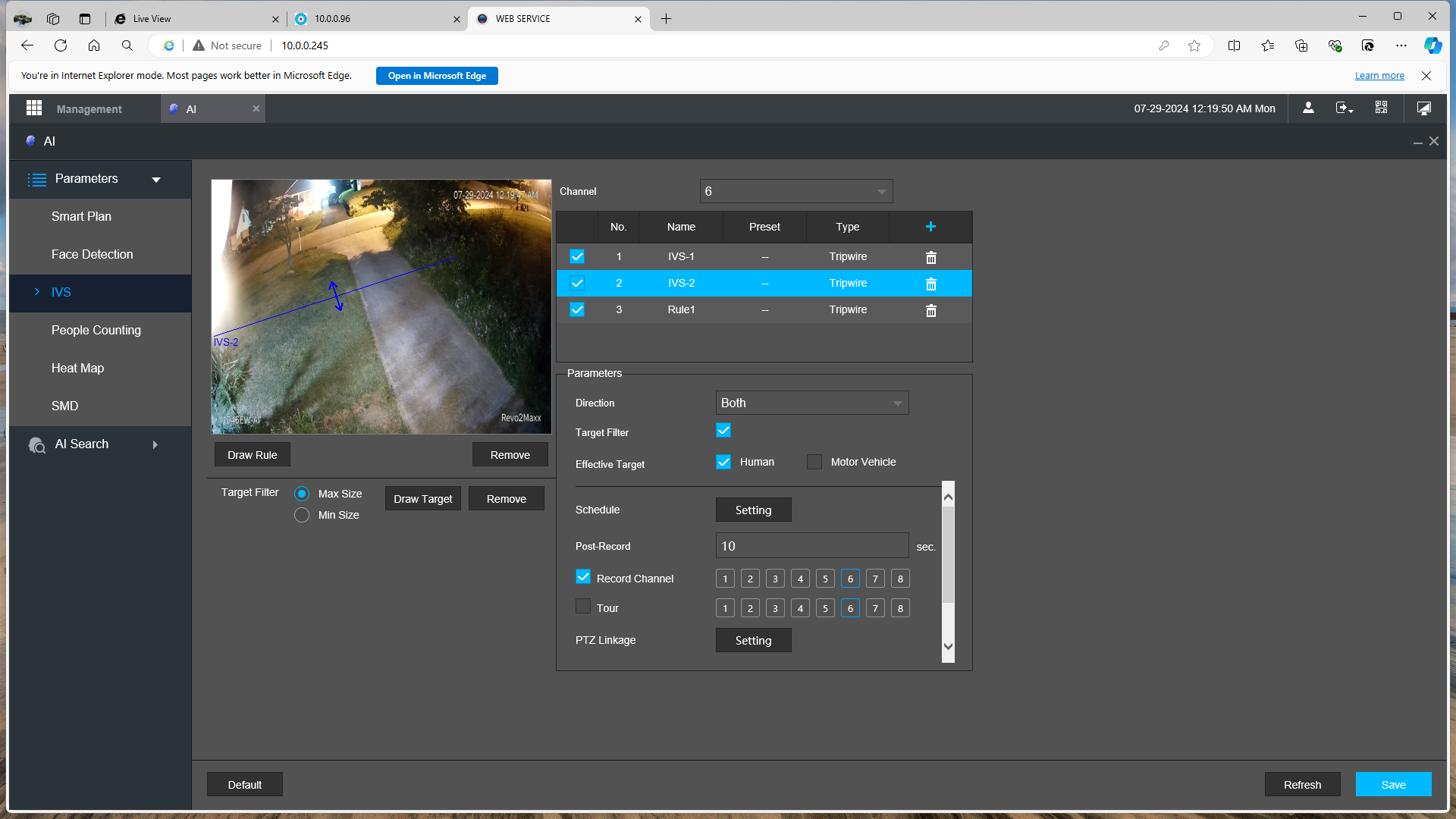

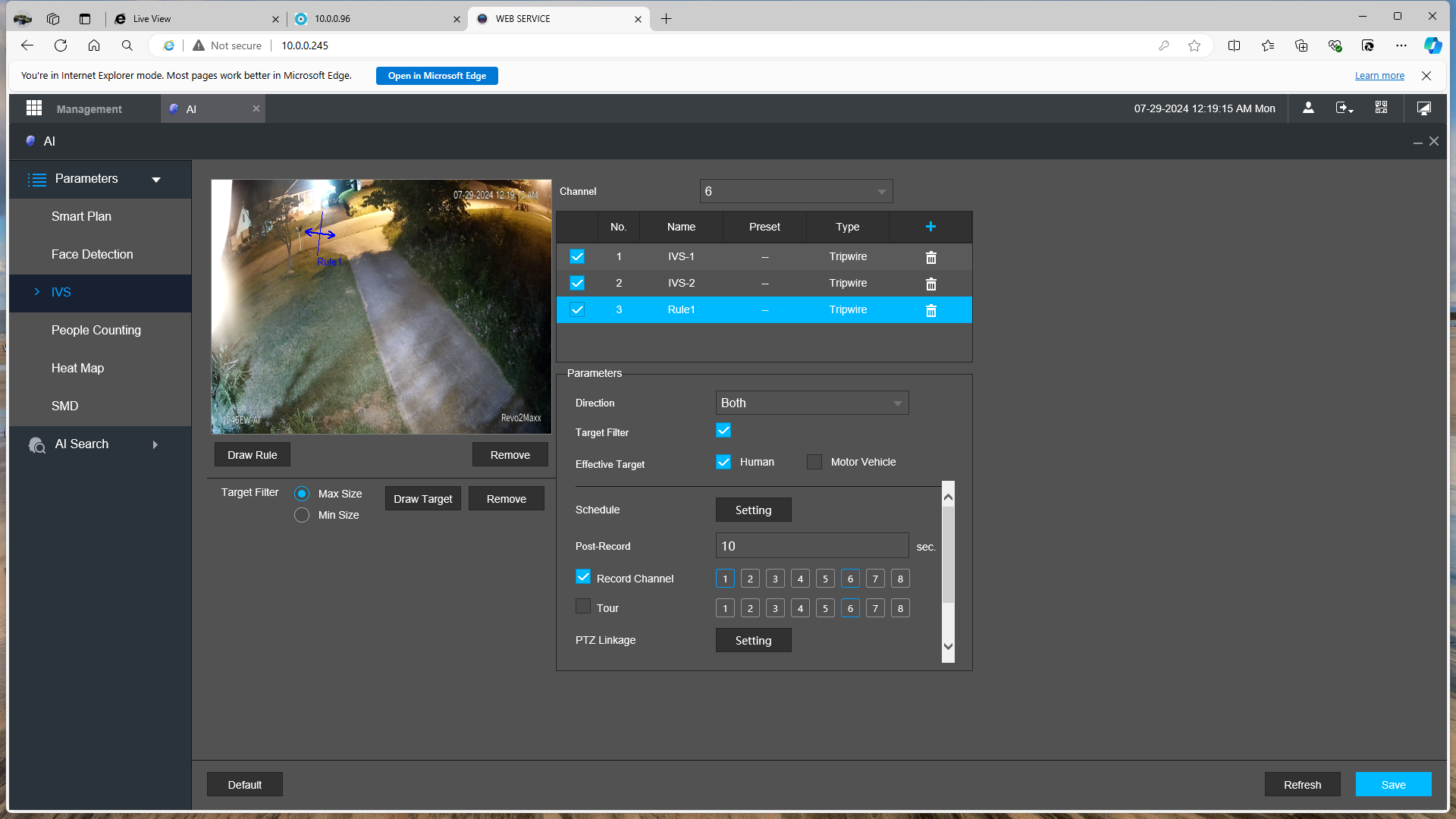

OK to keep the issues of False alarms down, I would turn off the MD, Make sure that in your Cameras setup for Smart Plan it is setup for IVS.. Then in your Plan I would make sure that you have your type you want set for the right line. Then in the Rules area of the camera make sure that all the Rules you want are turned on.., On my setup I have Motion off, I have IVS only method of alarms or events if you will and I have them setup to send Emails in the EVENT that I want. Maybe one day I don't want events of Humans because I will have lots of Vehicles that day and want to keep track in Email or Push alerts the ones that come in.. Also have the Vehicle as the first list and humans as the second to make sure that some one walking the Dog past that might go into the first line don't trip the Alarm I want to know that the Human that trips the Line is active in my Property area..

The screen shots helped alot. I was able to get tripwires working and I am receiving emails so I can move on to the next problem which is playback. I need to allow the camera to store some video and snapshots so that I have something to play back.
