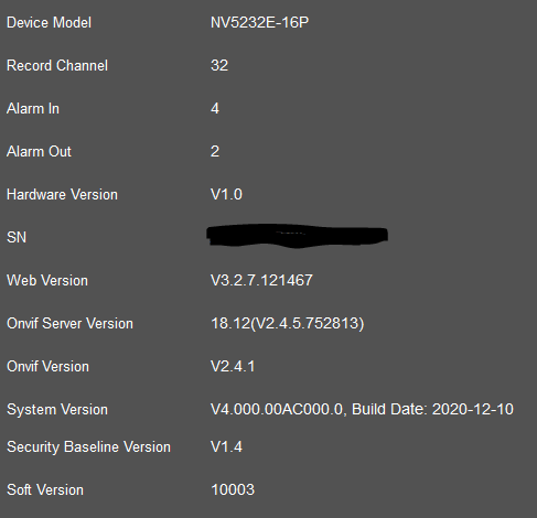

Please preview version that I have, I believe it is latest version (2020/12/10). I do not see IVS rules in web interface... Please see attached system information. Thank you for response.
- nvr_info.PNG (11.88 KiB) Viewed 2302 times
Re: IP Camera connected to POE NVR port no internet
Thank you for that. So it would seem that all the 52xx isn't running on the same type hardware. Or it might have been that the user that has the 5216E-8p might have some different hardware as I thought it might have been at the time as I found it odd that a 5216E-16P was being used for Thermal AI at 1400 for the NVR and some very spendy Thermal Camera system that takes the cost of the device to almost 20k at one time. I mean it was/is a lot of stuff really. But the NVR by it self was 1400 alone..
